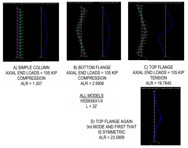

P.S. kootk almost made me a believer that full length between the fixed supports should be considered for negative moment if bottom flange is not laterally restrained. Until now, for negative moment I've taken the unbraced length equals to the length from fixed support to first lateral support (at top flange) after IP. I believe that the tension force in the bottom flange due to positive moment will try to straighten the buckling produced due to compression near the supports. But I could be wrong and I am reading this post with open mind.
Search for my post on [1 Dec 19 22:10] which contains the clip shown below.. In that post, I considered the phenomenon that you're describing in some detail. I concluded that the improvement is real but generally insufficient to resolve matters entirely.
Blackstar, much has happened since the 20% mark, and most of us who’ve been active in this thread view it differently to how we did back then, so don’t come to any conclusions too soon.
As for tension in the bottom flange - it is often insufficient to constrain buckling. I.e. insufficient to maintain an uphill energy gradient.
This was how I used to rationalize my view of thinking regarding the unbraced length for negative moment. But I’m starting to see that buckling in bottom flange is not as simple as I presumed. I remember posing this very question to my professor but his answer was not very satisfactory.
