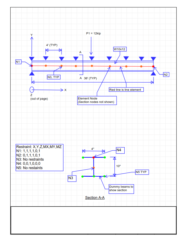

I would be interested in doing a check on the current problem. Could someone provide a summary of the data, or point me at a post with the required information?
Yes please. It's a 36' W10x12. Search your way to these posts for the low down. The sketch below is NOT the example you want. Rather, it's one of it's predecessors that we were using before attempting to move on to something more reflection of normal practice. Still, even with the wrong beam size and an incorrect span, it may be useful for you to see. Just replace W27x84 with W10x12, 32' with 36', and 250 kip with 12 kip.
If there's anything else that I can do to get you started, just let me know.
4 Dec 19 14:52 - Best description of test problem as I prepared it for Human909 for the same purpose.
4 Dec 19 23:59 - Nastran results.
29 Nov 19 18:17 - Mastan file, Mastan results, partial desciption of problem.
7 Dec 19 22:48 - Best summary of the final results from multiple sources.

Thanks for doing that. The only issues I see is with the 4' brace spacing. 36'/8=4.5'. Not that it's likely to make much of a difference to the final result.
I'll fix it, but do we want 36' long and 4.5' or 32' long and 4'?
Which matches the models thus far?
EIT
36' & 1/8th point bracing has been my intention.

IDS said:
at the moment I can't see how you would apply restraints to the top flange only of a 1D beam model
Can you not do it just as we've been doing it in Mastan to date, by constructing faux frames in the shape of cross sections? See [28 Nov 19 05:13] for an expanded discussion of that.
Agree with adding the stick elements to grab the top flange lateral restraints. I’d model them as flat elements of equivalent stiffness to the real beam web.
That's what I was attempting to do. Using the same section and applying warping fixity to the faux sections screws with the analysis. Warping fixed for the beam, warping free for the faux elements, and faux elements are another defined section representing the web stiffness. I tend to make this the beam depth by the web thickness. There is of course no true way to represent the restraint to the flanges on a 1D element as its not as simple as just having the web there.
I explained what I was doing in 18 Nov 19 17:42 post with respect to this if you search the date/time.
