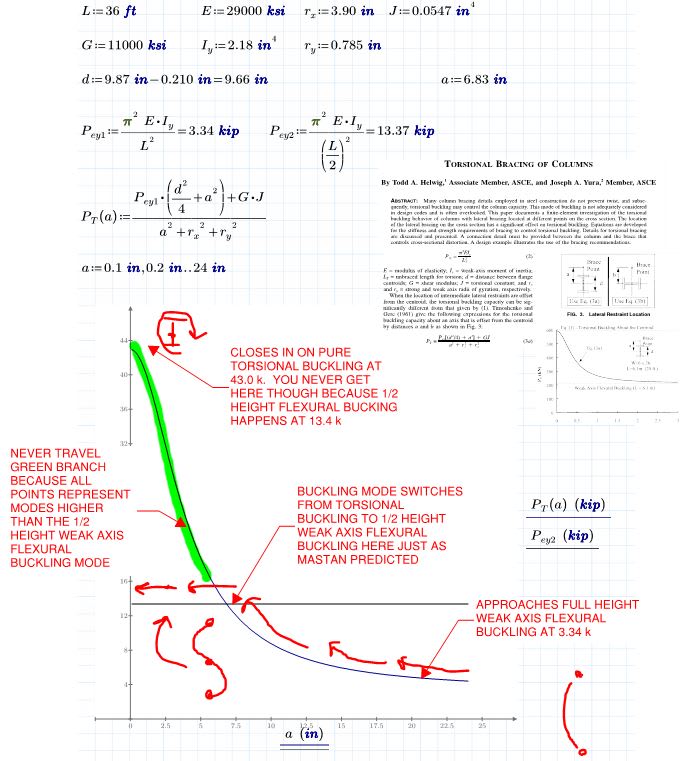

MODEL: 31UB 10m, fully fixed ends, pure compression (200mm nominal mesh size setting, with refinements around necessary features)
RESULTS:
-Minor axis lateral brace on web at 5m, offset from beam central axis. Brace is at a point.
0mm OFFSET: 494.146kN
10mm OFFSET: 493.801kN
50mm OFFSET: 484.698kN
100mm OFFSET: 452.135kN
149mm OFFSET: 400.194kN (ON FLANGE RATHER THAN WEB)
(Note the last value 1.5% different from the one give a couple of hours ago. Once you change the mesh you are always going to expect differences.)
All these buckling shapes are the lowest energy mode and are largely of an S shape. 0mm offset gives a perfect S shape with no twist the S rotates around the restraint at 0mm. The rest have a degree of twist as the S now rotates around an offset restraint.
Of course all the caveats apply regarding 'models' but the point is that you keep the same model and move the restraint out you are going to get decreasing buckling loads in a monotonic fashion. There is no way around this given this is the lowest buckling mode AND you are reducing the effectiveness of the restraint for each fraction of a mm you move it away from the centroid. If you buckling analysis doesn't give results that behave in this manner then it isn't going deep enough to andequately address the nuances brought up in this tangent topic and possibly the topic as a whole.

In this post, I'm going to pose, and attempt to answer, this hypothetical question: if there is an error in AS4100's LTB provisions, and I do not know with any certainty that there is, what would be the least invasive way to rectify it? I feel that the exercise has value for two reasons:
a) If there is an error in AS4100, this might help to point us to its root source.
b) If there is an error in AS4100, this might help to point us to how it might be corrected.
In my final anaylysis, I've come up with the only potential error in AS4100 being one of omission, as follows.
@tomfh: now it's time to offer your critique of this if you wish. Fire away.

If I understand Human909's work correctly, his Nastran capacity for the W10x12 is about double my Mastan capacity. I wasn't entirely sure what RFreund had done with his presentation of AS4100 as an ALR so that might be worth double checking. I had assumed his stuff was:
[AS4100 design capacity with bracing starting at 8' / max moment from 12k point load]
RFreund said:
AS4100 using inflection point and alpha_m: ALR = 0.547
31.2 k-ft
Human909 said:
And here is my first mode for the W10x12. The load factor is 0.375
20.3 k-ft
KootK said:
Run #1: ALR = 0.19055; L-braces everywhere.
10.2 k-ft
Tomfh said:
does your software agree the AS4100 L-restraint provisions can be unconservative
Hey Tom. Sorry for missing your question. Yes I agree and so does my software that AS4100 can be unconservative with regard to L restraints. To elaborate:
I concurr with Kootks numbers above.
My AS4100 calculated figure is 0.56. (Im not using inflection point but using all L braces at compression flange as per code.) AS4100, comprehensively misses the mark when we have two buckling analysis packages suggesting this overestimates capacity by 33-66%! And while we can and have debated modelling techniques, I don't believe there has been any suggestion that our buckling analysis techniques have been UNDERESTIMATING the real buckling capacity.
Thus I think the agreement is that AS4100 significantly not conservative for the scenarion presented. This doesn't look great, for AS4100. But there are a couple of caveats:

I used Celt83's spreadsheet to double check the W10x12 example as it's mission critical. It revises the moment that I based on your estimate a bit. Links to the spreadsheets are included if anyone wants to review them.
Nastran
20.3 k-ft
Mastan
10.2 k-ft
AS4100 @ L = 9' (Most unconservative use of segment definition as example intended to exploit)
35.7 k-ft Link
AS4100 @ L = 13.5' (Most conservative use of segment definition and as Aussies typically apply this by the sound of it.
15.5 k-ft Link
In practice, an inflection point is rarely going to land right at a brace location and you'd be somewhere between the extremes of the two AS4100 numbers
