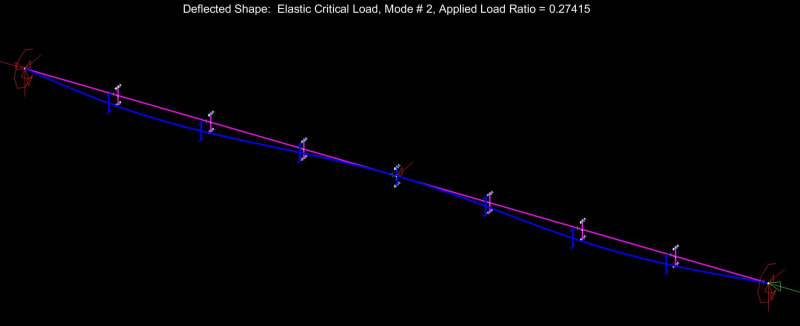

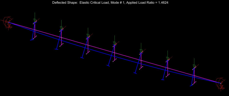

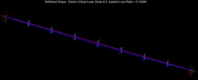

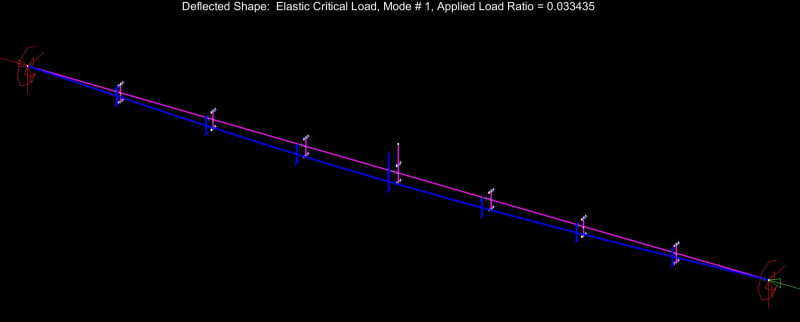

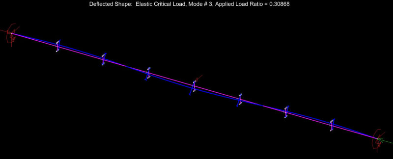

I couldn't resist looking into this so I took our W12 example and modeled it as a column with 100 k axial. It seems that I was partially wrong in my statement above.
The clips below show:
- The first three buckling modes with a mid-span, weak axis restraint at the column centroid.
- The first three buckling modes with a mid-span, weak axis restraint at one of the column flanges.
Here's what I see for takeaways:
1) For an eigenvalue buckling analysis, the first mode capacity for both brace arrangements is identical. I had this part right.
2) A centroidal brace is better for subsequent, higher energy buckling. The first torsional mode for the centroidal bracing happens at twice the load of the flange bracing. I had this part wrong.

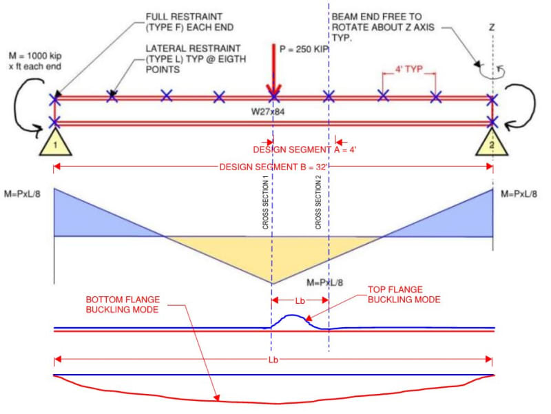

KOOTK LTB STORY BEFORE LTB THRILLA IN MANILA 2019
1) Check design segment {A} as top flange buckling @ [Lb = 4']
2) Check design segment {B} as bottom flange buckling @ [Lb = 32']
3) Pat self on back for a job well done.
KOOTK LTB STORY AFTER LTB THRILLA IN MANILA 2019
2) Recognize that #1 implicitly assumed that cross sections 1 & 2, bounding design segment [A], did not rotate appreciably. Marvel at this given that neither cross section is endowed with any physical, rotational restraint in the form of external bracing.
3) Recognize that the two things providing rotational restraint to cross sections 1 & 2 are the St. Venant torsional stiffness of the beam and the warping torsional stiffness of the beam. Further recognize that the warping torsional stiffness will dominate for most wide flange beams.
4) Recognize that the warping torsional stiffness of a wide flange beam basically amounts to the flanges acting as girts spanning horizontally between the rotationally restrained ends of the design segment. For this beam in particular, it's all about the bottom flange performing the girt function. So this is how cross sections 1 & 2 are rotationally stabilized. It's the bottom flange as stabilizing girt.
5) Given that the bottom flange is doing this important girt thing, question whether or not some kind of check should be performed on the bottom flange to ensure that it is strong and stiff enough to do the job. For a simple span beam with no bottom flange compression, no such check is performed. It seems that we are comfortable assuming that an all-tension flange can do the girt job effectively. And that's probably alright given that it really doesn't take much to brace a thing.
6) Recognize that the bottom flange is in compression over much of its length and will have a tendency to buckle between the ends of the beam. Further recognize that, if the bottom flange is allowed to buckle, it will kick the bottom flange out at cross sections 1 & 2 and, thus, utterly violate the assumption of near zero cross sectional rotation at those locations. What to do?
7) Check design segment as bottom flange buckling @ [Lb = 32']. In addition to checking for bottom flange buckling in its own right, this check rectifies #6 by allowing us to continue to assume that cross sections 1 & 2 remain rotation free because the bottom flange was not allowed to kick out.
8) Given that negative bending LTB will govern, consider taking advantage of constrained axis LTB which accounts for the benefit of the top flange restraints in the calculation for bottom flange LTB buckling. The trade off is additional calculation complexity. Reject this given that experience has shown that the capacity increase is only on the order of 20% because the center of LTB rotation tends to be pretty close to the top flange even in the absence of the top flange bracing. Deflection concerns probably govern the design anyhow.
9) Pat self on back for a job well done.

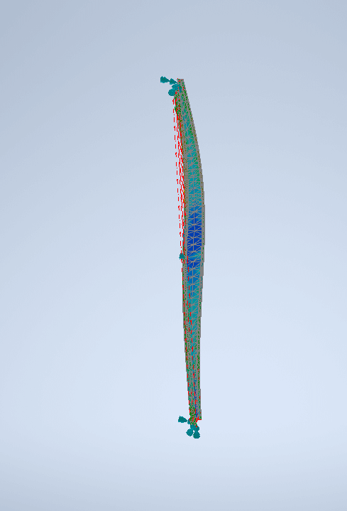

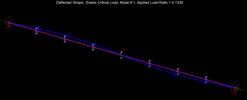

I see what you mean. First below is unbraced column. Second is a brace placed 12" off of the flange to hyperbolically simulate the cleat business. You're almost down to the unbraced braced value and it doesn't take much imagine to see why with the buckled shape staring back at you.

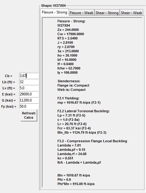

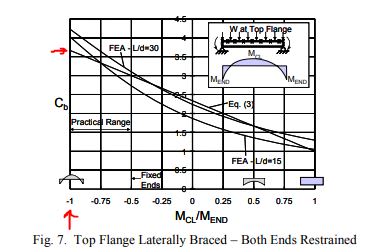

I've read thru the Yura document a few times and if I've understood it correctly Yura recommends a modified Cb formula to capture beams with reverse curvature.
Plotted in Fig. 7 in the document:
for the 32' - W27x84 beam this would yield a Cb of 3.67
So redoing the check with Lb = 32' and the new Yura Cb, I'm getting that yielding is the controlling limit state not Lateral Torsional Buckling, however if I am understanding your Mastan runs correctly they seem to indicate a much lower LTB value?

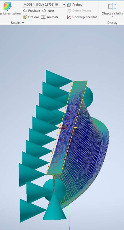

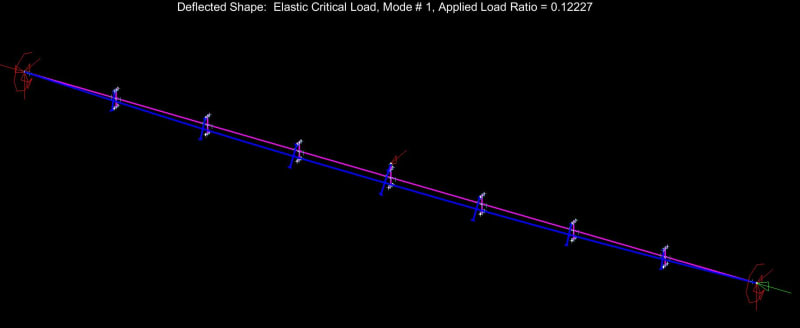

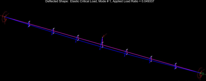

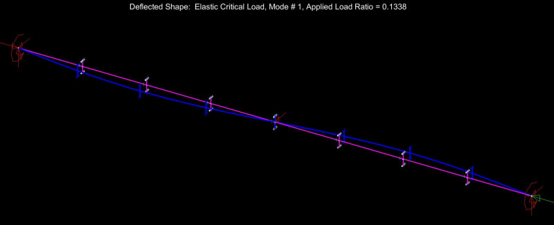

Here is my buckled shape:
And here is my first mode for the W10x12. The load factor is 0.375
(This seems differnt from yours but maybe I've made a mistake. You can see my constraints in my picture. Load is 53.38kN.
Nope, the mode shape looks identical to mine.
Well below plastic yield moment, as my models indicated.
That's good enough for my purposes. Thanks for the run.
It's a fair bit more nuanced than that I think. You'll notice that Yura's chart was based on a uniform load distribution whereas my W27x84 example modeled a concentrated load. The distribution of the load impacts the stability of the beam with greater load concentration towards midspan producing lower capacities.
To provide a more meaningful comparison, I reran the beam as fixed ended with a uniform load.
M_LTB_Mastan_Concentrated = 690 k-ft
M_LTB_Mastan_Uniform = 854.2 k-ft
Cb_Yura = 3.00
M_LTB_Celt83 = 919.4 k-ft (Your calc adjusted by ratio 3.00/3.67)
854.2 k-ft / 919.4 k-ft = 93%. As approximate as this stuff is, that's a non-discrepancy in my book.

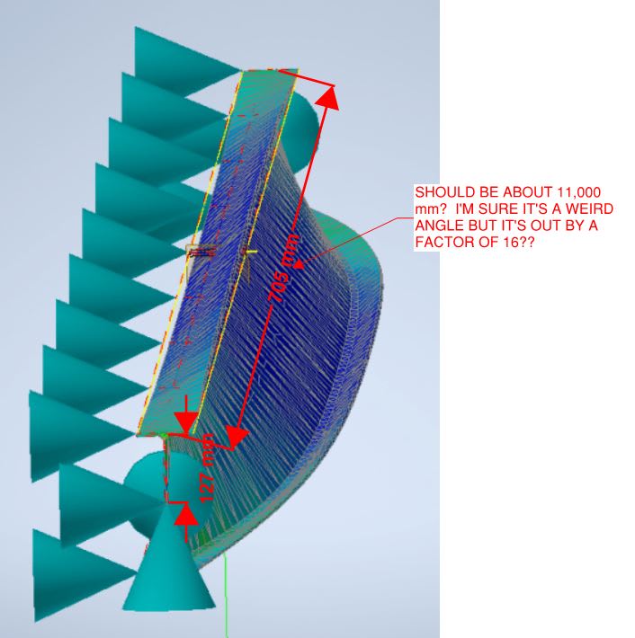

Something seems off with the proportions here. Are you sure that your beam isn't 36 inches instead of 36 feet? I get that there'll be some perspective at work but this scales off by a factor of 16.
Length is correct. There is significant perspertive foreshortening. I generally rotate the models in a manner I believe best conveys the buckling shape.

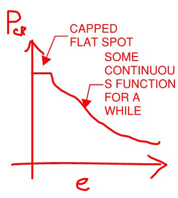

Human909 said:
Except the change in the first mode of buckling isn't binary.
Not binary, just discontinuous with a flat spot. Something like this.
Human909 said:
Nor can you think of a buckling mode as pure torsional or pure minor axis once you start offsetting the minor axis restrain.
You most certainly can if you're not modelling imperfections and using an eigenvalue analysis.
Human909 said:
The buckling threashold is a decreasing monotonic function with regard to the restraint distance from the centroid.
Can you offer some proof of that, as I did for my stance in my previous post?
