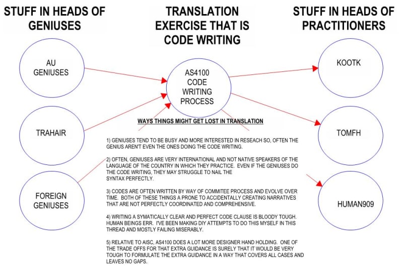

a) I don't know who exactly wrote the LTB section of AS4100 and therefore do not know if there are textbook examples by those people to indicate how they interpret things. Do you?
b) Since you don't yet know what reinterpretations I'm going to propose, how can you possibly know whether or not any particular textbook examples contradict them?
I'm begging you Tomfh: can you please put a pin in your critique until I've actually put pen to paper on my proposal? That would have to be more time efficient for us both.
Good question as to who actually wrote AS4100. Anyone know the authors?
