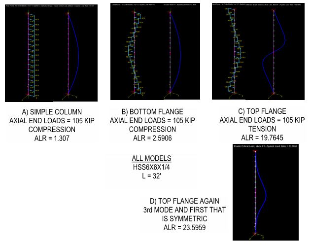

I prepared the attached PDF to answer some questions that I've been interested in since Celt83 conducted a similar exercise. And I thought that they might be of interest to the group. Basically, I wanted to study the flanges of our W27x84 test beam as isolated compression members to get a sense for how the behavior and capacity of such members would be affected by a compression distribution that varies over the length of the member and is substantially tension over segments of the member.
My observations:
1) In many important respects, a beam cannot be considered to be merely an assembly of independent axially loaded fanged. No surprise there. This representation completely ignores that fact that both flanges are continuously braced, to a degree, by the St.Venant torsional stiffness of the beam. That makes a big difference and must be remembered.
2) Relative to a classic, Euler column, a column loaded like a beam bottom flange would have about double the capacity.
3) A column loaded like a beam bottom flange still buckles over its entire length, as our LTB models have suggested.
4) Relative to a classic, Euler column, a column loaded like a beam top flange would have about fifteen times the capacity. Clearly, a flange with its compression field located at its ends (bottom flange) is much more unstable than a flange with it's compression field located at its middle (top flange).
5) I've come to view LTB, at least for our test case, as something like:
a) the bottom flange initiates some twist.
b) with some twist in play, some of the applied load becomes a weak axis load on the beam and initiates some sway.
Obviously, these are two actions occurring in tandem rather than sequentially.

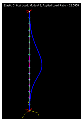

Yep, and D shows the effect of fixing weak axis bending. It largely neuters the bottom flange compression near the supports.
Right. And that takes me back to some comments that Human909 made some time ago. I'd meant to comment on them then but things were moving fast and it got lost in the shuffle. I believe that his points were:
1) Human909 pointed out that, in many cases where you would have end moments develop, you would also naturally tend to have some degree of weak axis restraint. And that's true of course. I did my best to steer the conversation towards beams without weak axis end restraints for two reasons however:
a) AISC and most of the reference cases are built around members without the weak axis end restraint. So in the interest of comparing similar things, I thought it best to stick to beam ends that were pinned with respect to weak axis flexure.
b) In the literature, when they discuss interaction buckling, they're always careful to point out that the effect of considering weak axis behavior of adjacent spans isn't always your friend. Sometimes it does provide significant restraint to the span being studied and, naturally, will improve capacity in those cases. Other times, the adjacent span may actually be encouraging buckling in the span being studied rather than restraining. In that sense, even going with beam ends as weak axis pinned isn't always a conservative assumption. But, then, one has to put a pin in it someplace and move on. So we typically put the pin in the neutral, pinned ends assumption.
2) Human909 made note of the fact that, when beam ends were fixed about the weak axis, that made for a 100% increase in capacity. In examining the case below, that observation checks out. In going from pinned to fixed ends, you're basically going from k = 1.0 to k = 0.5 on the "flange as column" model. And while we don't see a 400% improvement in capacity, a large bump makes sense.

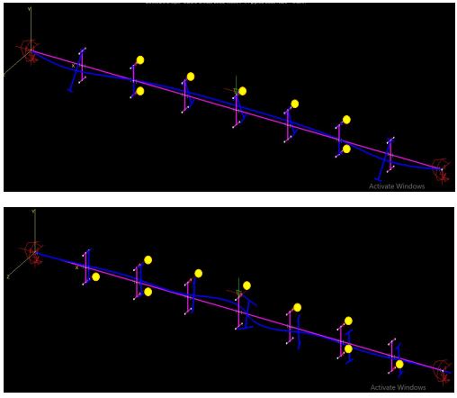

Please refer to the snips below and the attached PDF of the same.
I also wanted to explore a bit more the business of L-retraints (lateral only / one flange) being taken as equivalent to F-restraints (lateral restraint + cross section rotational restraint). A brief summary:
1) A while back, Steveh49 dropped on us the extinction level bombshell that AS4100 considers L-restraints equivalent to F-restraints in many cases. I don't think that I was alone in finding that shocking.
2) I came to a revelation of my own that, in fact, both AISC and AS4100 routinely assume that rotational restraint exists where only an L-brace is present. The ubiquitous case of that being simple span beams with intermediate, lateral braces on the top flange. So assuming rotational bracing at locations only having lateral bracing isn't an outlier thing, it's an all the time, everywhere thing. And it needs to be explained in that context.
3) In a post dated [27 Nov 19 01:59], tomfh and I explored how this applied to simple span beams and came to the conclusion that, indeed, it was appropriate to consider L-braces as F-braces for such cases.
Where I'm at now is that, if L-bracing is going to be effectively taken as F-bracing in some situations but not others, then I'd like to know the rules of the road. When is it okay and when is it not? To that end, I've studied the cases below. This is our usual W27x84 with the center point load. I've placed F-bracing at the inflection points and L-bracing in between. From the perspective of both AS4100 and AISC, the span between the IP F-bracings would be treated as an independent design segment within which the L-bracees could be assumed to prevent cross section rotation. So the point of the exercise, then, has been to assess the truthiness of that claim.
CASE 1
Here, at an ALR = 8.3991 and no bracing at the 1/4 points, it would appear that the L-braces are not effective rotational restraints. That said:
a) It appears to me that it is the buckling of the the spans to the left and right of the IP F-braces that is encouraging the bottom flange "kick out" between the IP F-braces.
b) To an extent I think that one can say that, if a buckling mode that would induce rotation at the L-braces occurs at a wildly high ALR, that's not really a repudiation of the notion that such L-braces are effectively F-braces.
CASE 2
At an ALR = 24.1222, this is the same as case one but with the addition of bottom flange bracing at the 1/8 th points. As can be seen by the snaking buckled shape between IP L-braces, and the relative absence of cross sectional rotation within that segment, this removes the tendency for twist between the IP F-braces entirely and restores that segment to a state where the assumption that the L-braces are effective F-braces would be appropriate. So a nice benefit of case two is that the end segments no longer buckle and encourage section rotation between IP F-braces. I would argue, however, that this benefit could be gained in two ways:
a) Provide actual bottom flange L-braces at the 1/8 th points as shown or;
b) Simply design the the segments left and right of the IP F-braces such that they don't buckle without the 1/8 th point bracing.
I feel that this is an important equivalency.
The Proposed Rules of the Road for L-braces Equivalent to F-braces
Speaking the parlance of AS4100, and being mindful of the AS4100 distinction between "segment" and "sub-segment", I tentatively propose that intermediate L-braces may be assumed to be equivalent to F-braces within a design segment, and therefore taken as forming sub-segments, when:
1) The design segment being studied is itself bounded on each end by F-braces (real, physical ones).
2) The design segments either side of the segment being studied, if present, have been properly designed to preclude buckling there.
3) A "compression flange" shall be defined as any flange experiencing compression anywhere within the design segment being studied, regardless of whether or not that flange would experience compression at the particular location of any given L-brace.
4) Any design segment may have as many as two compression flanges, as dictated by loading conditions. In such cases, both flanges must be independently stabilized laterally and independently evaluated for stability.

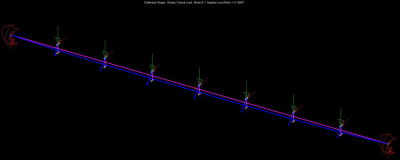

Done. A couple of things to note:
1) While Mastan does have a utility for uniform load, to my knowledge, there is no way to apply a uniform load to a member at any location other than the shear center. Rather than getting fancy with more faux members with difficult to predict behaviors, I just discretized the uniform load as serious of equivalent point loads at the 1/8th points. [500 plf * 36 ft / 7 = 2.571 k] each. Hopefully this is sufficient for your purposes.
2) I don't know about you but I'd expected the switch from a point load to a uniform load to have more impact than it seems to have. Having pondered this a bit, my explanation for this is:
a) LTB for this situation is mostly the story of the bottom flange kicking out laterally.
b) The tendency for the bottom flange to kick out laterally is most greatly affected by the compression force delivered to the ends of the bottom flange.
b) End moments, and therefore the compression force delivered to the ends of the bottom flange, are pretty much the same for both cases even though the lateral distribution of applied load is quite different.

I am currently of the opinion that AS4100 could be unconservative in some situations. The simple logical extension of a hypothetical infinitly long beam with L restrainst all along it having appropriate twist restraint is evidence of AS4100s failings. Whether this translates readily to realistic scenarios hasn't been adequately fleshed out.
Human said:
The reality is that REAL WORLD connections are not perfect pins. Real world connections almost always have a non negligible degree of stiffness and this stiffness is often enough to significantly change the buckling behaviour.
That’s correct. But it is a problem if AS4100 is actually reliant upon rotational restraint occurring at L restraints. The whole premise of L restraint is no rotational restraint.
If I actually need some rotational stiffness at L restraints in order for AS4100 to work then I want to know about it.
And we don’t need infinite long beam for this to be a problem. These buckling results are perfectly ordinary span sizes.
human909 said:
Also I wouldn't put the blame on NASTRAN, I'd put the blame on the user (myself) or the problem description (perfect pin connections).
It was always my intent to assign any blame, if you want to call it that, as [100% Human909; 0% NASTRAN]. I intentionally didn't call you out by name when critiquing the NASTRAN models because I felt that it was unnecessary to do so and would be more tactful if I did not. I was trying to be polite and conciliatory within the limited range of my people skills.
Tomfh said:
Nonetheless I think it's worth keeping the NASTRAN short buckle results in mind. I don't believe it should be written off. Maybe NASTRAN is seeing something that MASTAN isn't.
Abso-friggin-lutely the Nastran results should not be written off.
KootK said:
Having a surprising result confirmed by two independent modelers, using two different software packages, and coming from two different fundamental perspectives was invaluable with respect to establishing credibility for the results.
The situation with the modelling, unfortunately, unfolded like this:
1) Human909 did a lot of modelling before I started.
2) I did a lot of modelling after Human909 stopped.
3) Due to the minimal overlap, Human909 and I only ever ran the same model once and the result, according to Human hisself, was:
Human909 said:
Kootk (1)
Human909 (0)
Of course one data point is no trend. If there is any doubt that a NASTRAN model would fail to confirm the results of one of my MASTAN models, I propose this:
1) Let's identify the model to be challenged.
2) Let's have human909 replicate my MASTAN model in NASTRAN.
3) Human and I will compare deflected shapes, weak axis bending moments, shear diagrams... whatever, until we get our models to agree.
This is, I submit, the rational thing to do when you have access to two fancy software packages. Make 'em fight it out!
