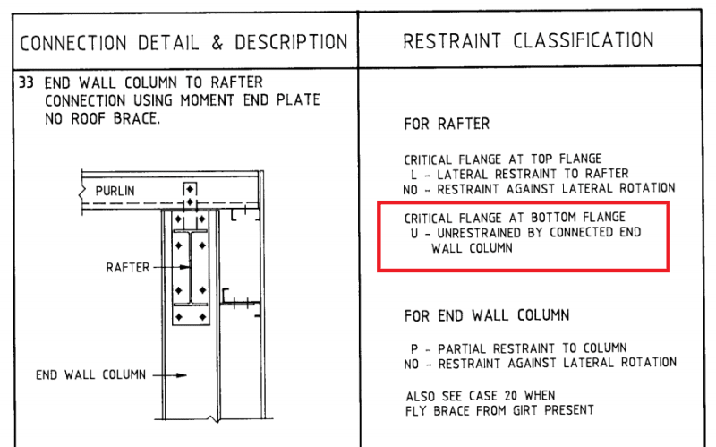

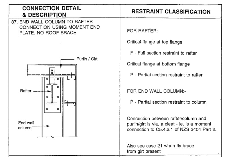

Well I'm thoroughly confused by this diagram from the 'wizard'.
Wait. What?
Is this diagram suggesting that the the rafter is unrestrained by a moment end plate connected to a column. In what way is that not a flange restraint of any nature?
Maybe it’s intended to cover flexible columns? Seems a bit harsh though.
I considered that. Though even with sway columns and a flexible web your still would get the beam flanges restrained for buckling purposes. I'd hope my columms can provide more lateral restraint to a beam than a random purlin!
Yeah, i don’t really get it either.
It's because it's wrong, see corrected version here:-

I'm going to walk through this to make sure I have this right. Thanks Agent666 for posting that Portal Frame design tips.

GEN7001 said:
With Fly Bracing under Downward Load
The effect of the bottom flange near the columns being in compression due to gravity loads or other loading
should be considered even though most of the bottom flange of the rafter is in tension. A fly brace is
recommended near each knee and near the ridge to restrain the inside corners of the frame at kinks. A stiffener
between column flanges as indicated in Figure 4 effectively extends the bottom flange of the haunch to the
outside column flange which is restrained by girts. This effectively provides some restraint to the inside of the
knee. However, a fly brace near the knee is still recommended. With fly braces at least at the knees and the
ridge, the effective length will be 0.85 times the spacing between fly braces.
An alternative approach is to consider the rafter segment between the column and point of contraflexure if
accurately known, or nearest purlin beyond the inflection point. The inflection point is considered to be
unrestrained in determining the effective length. This approach is described in an example by Clifton,
Goodfellow and Carson (1989)

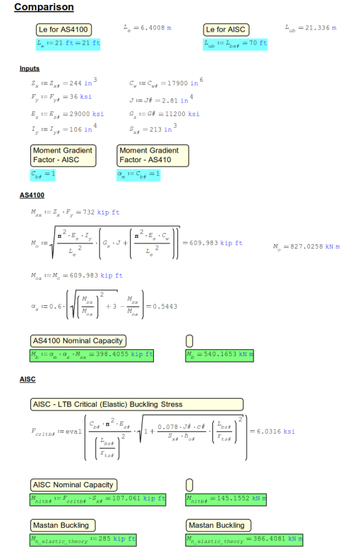

However, when looking at the bottom flange it sounds like you would take a L.e as the segment from column to the first purlin beyond the inflection point (worst case). And the end conditions of this segment are FU which gives KL = 1.0 (I think?)
Example:
Using KootK's W27x84 70' (21.3m) long beam example. Which has lateral braces on the top flange every 7' (2.1m). Fixed in the strong axis at both ends. Point load at center causes an inflection point between the 2nd and 3rd lateral brace (on the top flange). So at about 17.5' (5.33m).
So unbraced length choices:
Unbraced Length: 70' with C.b and alpha_m = 1.0
[ul]
[li]AISC M_nLTB (nominal lateral torsional buckling strength): 107 kip*ft (145kNm)[/li]
[li]AS4100 Mo: 107.5 kip*ft, alpha_s*M_s = 95.3 kip*ft[/li]
[li]Elastic buckling strength per Mastan2: 285kip*ft (386.5 kNm). This really isn't fair to compare to the above values as I haven't factored in C.b (alpha_m),b ut this is the highest value of moment capacity that can be achieved[/li]
[/ul]
*Note - Anything above 285kip*ft (386.5kN*m) can't be achieved. The beam will buckle prior to this moment
Updated with Cb and Alpha_m
C.b = 1.92
alpha_m: 1.7
ul]
[li]AISC M_nLTB: 206 kip*ft (280 kNm)[/li]
[li]AS4100 M_b = 162 kip*ft (220 kNm) [/li]
[/ul]
AS4100_A: 17.5'
[ul]
[li]AISC: Not allowed[/li]
[li]AS4100 Mo: 839.9 kip*ft (1138.7 kN*m), alpha_s*M_s = 468.8 kip*ft (635.6 kN*m)[/li]
[/ul]
AS4100_B: 21' (brace after inflection point)
[ul]
[li]AS4100 Mo: 610 kip*ft (827 kN*m), alpha_s*M_s = 398.4 kip*ft (540 kN*m)[/li]
[/ul]
Calc Numbers:
What is the equation for alpha_m? I can update these to include alpha_m and c.b factors.
- I will update these shortly
Side Comment: It would be great if we produced moment in Joules. Not sure why I find that so appealing. The whole energy thing I guess.
Hopefully I can get someone to double check this.
Takeaway
It seems like using the segment lengths (and please someone check these unbraced lengths for AS4100 cases) results in a beam capacity which cannot be achieved.

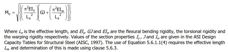

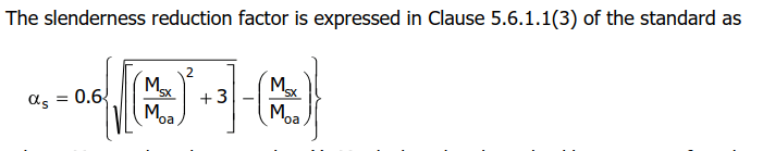

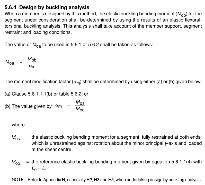

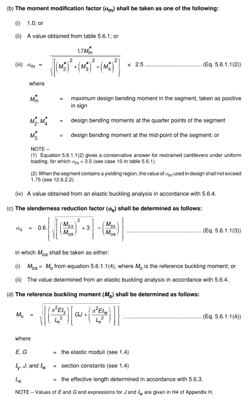

Hi RFreund, you're mixing a whole lot of ideas here that's going completely off target.
You're not multiplying alpha_s by Moa. You multiply the full plastic moment capacity (M_sx) by alpha_s x alpha_m x strength reduction factor. Moa is only required to calculate alpha_s. Otherwise it has no bearing on the capacity value or buckling values.
The moment coming out of the mastan2 buckling analysis is M_ob. This is M_oa x alpha_m. So to calculate alpha_s you need to determine alpha_m for the critical segment. Divide M_ob by alpha_m to get M_oa. Then work out alpha_s. Then work out M_bx the member moment capacity = phi x M_sx x alpha_m x alpha_s. If product of alpha_m and alpha_s is greater than 1 you have full lateral restraint, this means you can achieve the full plastic capacity of the beam. Phi is the strength reduction factor typically 0.9. M_sx is equal to plastic section modulus x yield strength.
Generalised alpha_m equation is as follows and is worked out on a segment by segment basis (I'm sure it was posted earlier but is list in the 400 plus posts above, but good luck finding it!) :-
There's also these equations for specific cases.
Alternatively you work it out from the process in CL5.6.4 which reads (this was the process being described in the SCNZ document I linked to):-
Hope that clears up the process for you?
