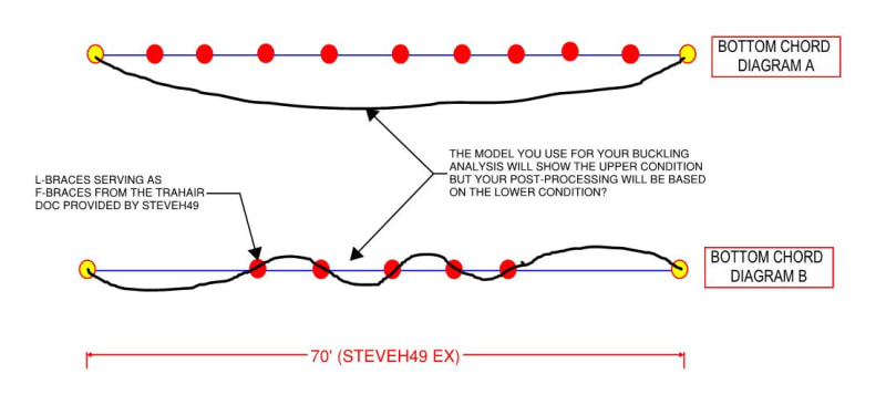

Hold the phone... are you saying that, using the buckling analysis option, you'd still do the AS4100 post-processing segmentally? Even though your FEM model would show you something completely different (sketch below)? I had not anticipated that and it strikes me as a terribly inconsistent mix-match of the stories being told. Consider the following as it would pertain to the 70' beam example:
1) Your FEM shows buckling as a single half sine wave. Your post processing assumes six half sine waves.
2) Your FEM has provided you with information about a single buckling mode and you are applying it to six different cases, none of which match the FEM.
3) I would think that your slenderness parameter would be badly overestimated by segmental treatment and would be much more appropriately calculated based on the 70' beam length.
How do you rationalize this?

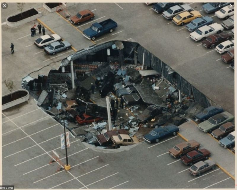

Also in the same breath though, I'm reminded of the number of structures that I've seen with continuous beams and no stiffeners/braces at columns and have not had issues (yet?).
The failure shown below happened in my neck of the woods and was judged to be the result of missing beam/column joint stiffeners allowing web side sway buckling to take place: Link.

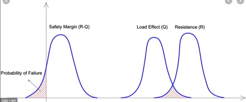

The graph below is largely responsible for why failures don't happen and has two important, negative consequences for us:
1) it makes it difficult for structural engineers to demonstrate their value to society and;
2) it makes it difficult to separate luck from skill / correctness over the horizon of any one man's life span.

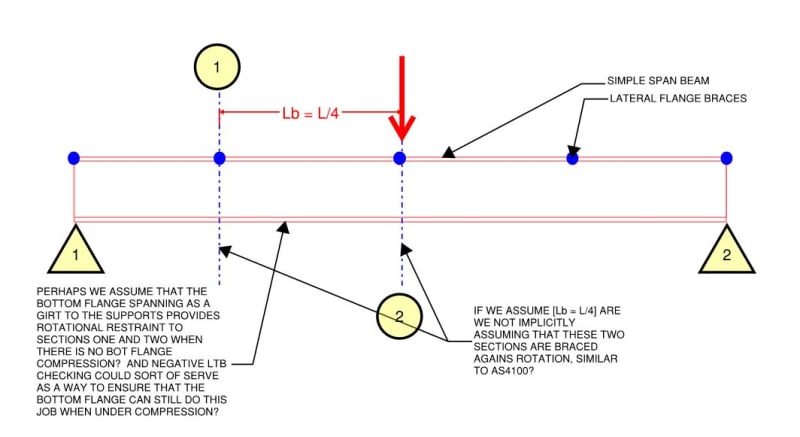

Kootk said:
pretty much every simple span beam ever (sketch below/attached). What to do...
I think in the simple span case the bottom flange doesn't move at the position of the L restraint, thus increasing restraint level to F by bracing the bottom flange is redundant in those instances, and thus you can treat them as equivalent. That seems to be a large part of the basis for AS4100 saying L's are F's are equivalent.
Maybe you could run some mastan analyses with simple span with top L restraints and see if you can get the bottom (non critical) flange moving?

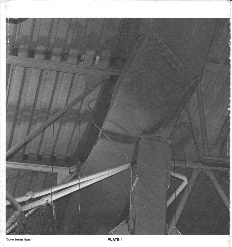

Below is Plate 1 from the Station Square Report by Dan Closkey. It shows the configuration of the cantilevered beam after failure but before collapse. The joists would normally be considered lateral supports for the beam, but the dark rectangle at the underside of one joist shoe suggests to me that the welding of that joist may have been omitted.
BA
This is a photo of the drop-in span after failure of the cantilevered beam. The darkened rectangle under each joist shoe suggests that these two joists were not welded to the beam. If so, the lack of lateral bracing of the top flange of both the cantilever and supported beam could have been a contributing factor in the collapse.
BA

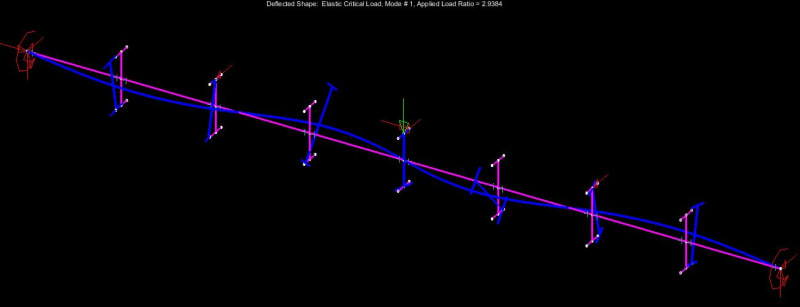

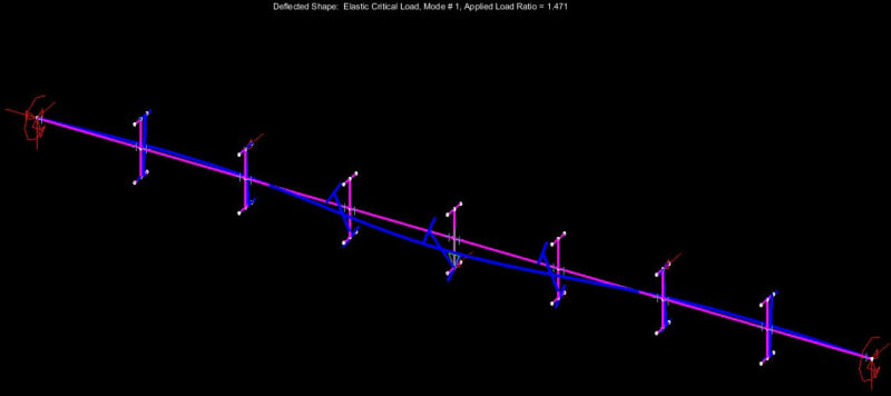

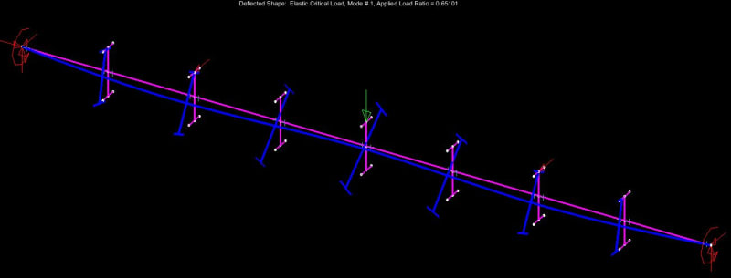

All three runs are the same W27x84, 32' beam with L-restraint at the first and third quarter points.
CASE 1. ALR = 0.65 which is actually less than the negative bending on our test case (0.69). Gobs of section rotation at the 1/4 point L-restraints. This case has a concentrated load at mid-span without lateral restraint at the point of loading. This would be a rare occurrence in practice but might be something to bear in mind at, say, a beam transferring a column from above. Makes the default practice of a stiffener pair under the column seem quite prudent.
CASE 2. Point load at top flange and accompanied by lateral restraint. A little section rotation at the 1/4 point L-restraints. ALR = 3. Not worth thinking about.
CASE 3. Point load at bottom flange accompanied by lateral restraint there. ALR = 1.5. Next to no section rotation at the 1/4 point bracing. Normal positive bending LTB check with the unbraced length equal to 0.5L would pick this up perfectly so not an issue.
CONCLUSION: tough to find a practical situation where cross section rotation at an L-brace would be in issue for a simple span beam.

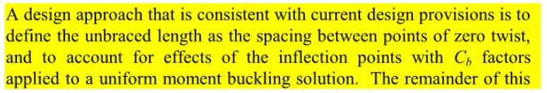

Kootk's Reference said:
A design approach that is consistent with current design provisions is to define the unbraced length as the spacing between points of zero twist...
Is this in AISC? Or where is the this from?
I've always understood that you can either restrain the compression flange from lateral movement or prevent twist. Which in the fixed end beam the bottom flange is only braced against lateral movement at supports.
