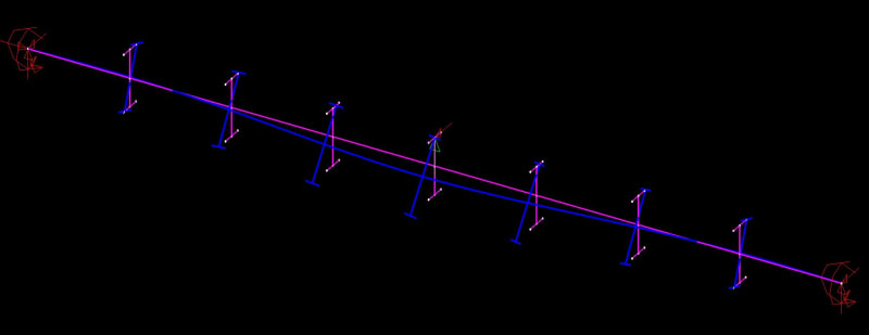

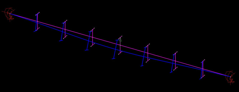

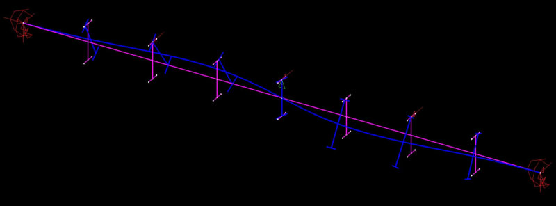

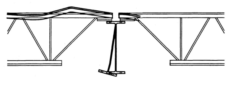

I stumbled across an interesting case of the weird stuff that can happen when exploring the uplift situation. The combination of a few L-braces, and a load applied in a high stability vertical position. created the effect of a an F-brace at mid-span. There is much that makes this example only weakly analogous but, again, weird stuff happens in the land of stability.
In order, below, you're seeing:
1) No L-brace.
2) L-brace at mid-span only.
3) L-brace at mid-span and each 1/4 point immediately to the side.
My best explanation for this is that, once the top flange L-bracing is effectively continuous, the load being applied in a stabilizing position overpowers the tendency towards a single curvature buckling mode.

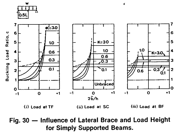

Agree. My confusion is because Agent's graph says an L restraint on critical flange provides identical performance as an F restraint, and that an L restraint on non critical flange is identical to no restraint. The graph refers to simply supported beam, but the same logic applies to our scenario.
Likewise human's buckling examples show the Laterally restrained beam acting as though it's Fully restrainted. It is confining the bottom flange buckles to very short wavelengths, of (approximately) same length as the top flange restraints spacing. That again would suggest L is as good as F. But I can't understand why the beam would bother doing this, as opposed to a gentler wavelength similar to the mastan buckled shapes, and your original paint sketches.

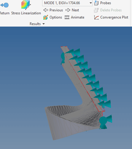

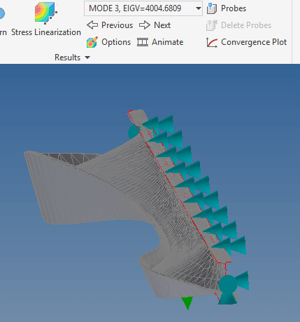

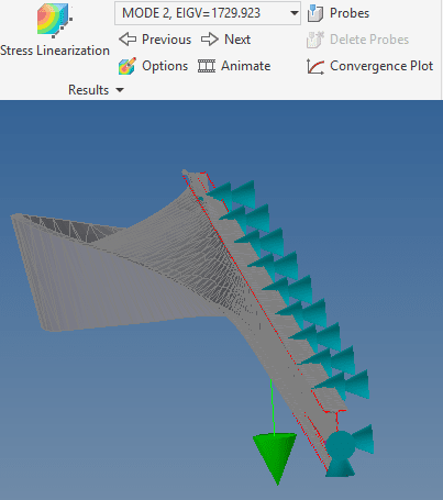

Ok here are some picures of the different modes for Kootk's 70ft beam:
First 3 modes in order including the calculated buckling forces in kN. (You'll notice the first one is about 5% less than I previously reported this is due to me refining the restraint points to a smaller point on the mesh.)
The bottom mode is essentially Kookt's full wave buckling mode. It comes in much later. Not suprising really because it takes a fair bit more energy to buckle a 21m beam than a 2.1m sub section.
Human, Are those restraints pin? The top flange doesn't seem to be rotating, and the web appears to be bending? I could be wrong. It's a bit hard to see...

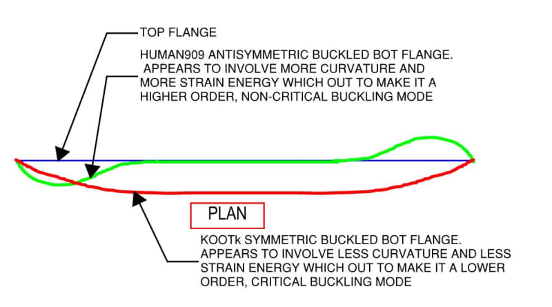

1) My software and yours disagree. Obviously they can't both be right. If your software showed my buckling mode, or my software showed your buckling mode, I'd feel a lot more confident.
2) As Tom mentioned above, your buckled mode shapes would seem non-optimum from an energy perspective with respect to the shape that the bottom flange takes on. That doesn't necessarily mean that shape is wrong but I would like to find an explanation for it before collectively agreeing that it's right. Are you able to offer any explanation for the double curvature mode shape at this time?
I believe that it's the reverse actually. The longer unbranded length should require less strain energy to initiate buckling. That's what makes it go first.
I can see both sides of the argument. The shorter length means less beam involved AND only involves on 2.1m segment unlike you drawing which shows two 2.1m segments. It also is occuring where the compression in the bottom flange is the greatest.

Can you confirm what the top restraints are? See my question 25 Nov 19 01:19. I'm trying to understand why your images appear to show web distortion.

Top restraints are lateral only every at 10% spacing. They are currently area restrains so some rotational restrain might come into play. I can try line restraints and see if there is a significant change.....
Okay.... Thanks for pressing me on this Tom. With single point vertex restraints my model starts to look alot like Kookt's model. And does imply massive unconservatism from AS4100 in this circumstance. In fact I'm now down to 159kN with non linear elastic analysis! (compared to 1154kN member capacity from AS4100) Whether this unconservatism manifests in reality is a good question. The lack of ANY stiffness given at the restraints is not realistic and as we have seen the theoretical buckling analysis is very sensitive to even minor rotational stiffness at points.
-My modelling has used small face restraints that has implicit rotational stiffness even if the restraint is translational only
-These implicit rotational stiffnesses in the restrains have had significant affects from a TRUE point restraint
-With tighter meshing and better use of point restrains I'm seeing similar behaviour too kootk's modelling
