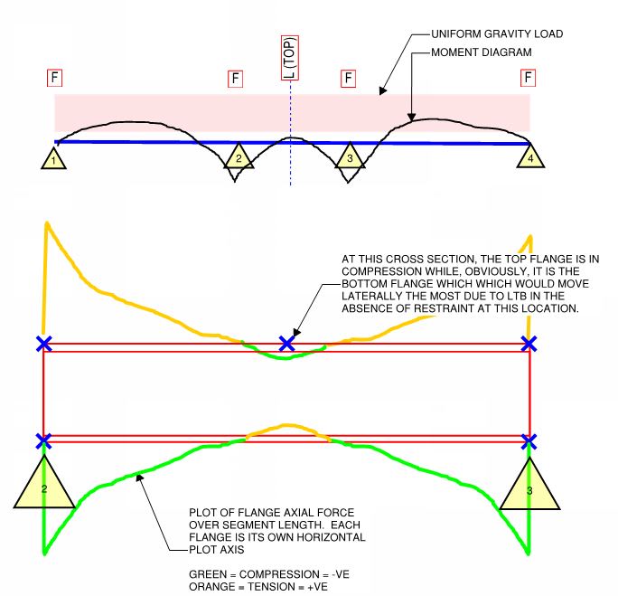

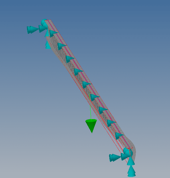

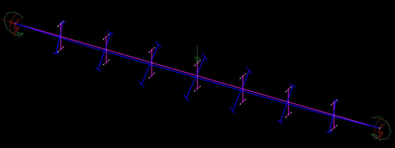

Back to this with Mastan using this file and the methodology described below: Link
Doing it this way, I was able to create a situation in which the following is true at the mid-span section where one might contemplate a brace;
1) The bottom flange is in tension.
2) The top flange is is in compression.
3) The bottom/tension flange would move the most (+1.00 for the bottom/tension flange; -0.68 for the top/compression flange).
4) One might rationally expect that the bottom/tension flange would be the best place for this brace.
And yes, this was very much a contrived example designed to produce this effect. As such, the example's practical significance is limited.

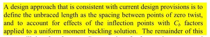

RFreund said:
It seems like everyone has agreed that it should be defined as the length between "columns"
Oh no, not at all. Me, Yura (read that attached paper), and most AISC practitioners see it that way. The Aussie code seems not to and treats the effective buckling length as the length between L-braces. This was the initial source of contention. At this point, we've established that the AISC and AS4100 methods are practiced quite differently. My current bones of contention are these:
1) I don't understand the underlying theory that justifies AS4100 treating the unbraced LTB length as something much shorter than it obviously is in the real world (distance between points of twist restraint) and;
2) The AS4100 method seems to operate on a single, unrestrained LTB buckling mode rather tackling the multiple, possible modes in a hierarchical fashion as we do with AISC. Again, this is a theoretcial understanding issue for me. I just don't undertand how AS4100 works the magic that it seems to. I want a look at the wizard behind the curtain.

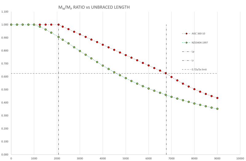

Agent666 said:
This is what the alpha_s factor does. I've mentioned previously on two occasions now in this thread that I can remember that it savagely scales back the theoretical capacity until every test (159 I believe) which they compared results to was above the line. Whereas AISC goes somewhere through the middle of the test data, and isn't a lower bound approach, more of an average. This can easily be seen in the graph I posted a few posts back. NZS3404 capacity is way lower than AISC for example. I posted a specific comparison much earlier in the thread without all the other cases included. Edit: this was the 'The YELLOW section' graph posted right at the beginning that you commented on.
I've reviewed and considered the graphs that you posted repeatedly. In doing so, however, they appeared to me to be:
1) Graphs comparing single buckling modes over a range of unbraced lengths and not;
2) Graphs comparing envelopes of multiple buckling modes over a range of unbraced lengths per Tomfh's explanation.
If the graphs are #2, then that's great to know. I don't see how I could have been expected to know that, however, unless someone mentioned it. The shape of these graphs look like every other buckling curve fit that I've seen that were all in reference to a single buckling mode rather than envelopes of several buckling modes.

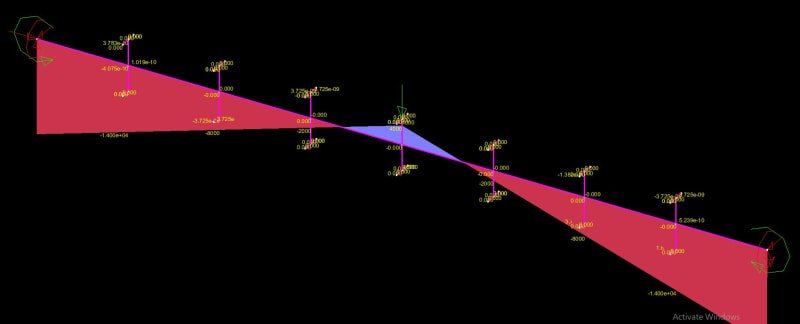

Kookt said:
- Fails at 2768 kip*in end moment = 313 kN*m (25% of your phi.Ms. value of 1240 kNm)
CONCLUSION: if I've not screwed anything up, I believe that this would suggest that the beam length at which constrained axis LTB would occur can be expected to be significantly shorter than the value at which AS4100 would predict that LTB would govern over phi.Ms.
SURPRISE OBSERVATION: the moments at the ends are different from the moments in the middle. I should have anticipated this, in retrospect, but did not.
I am getting the first positive buckling mode failure at 2844kN. Well past the beams capacity.
And for good measure 410kN according to AS4100

Human909, what are your end restraints? Are they restrained against minor axis bending? I think others are releasing this. And are both ends restrained longitudunally, so pinned-pinned rather than pinned-roller?
Buckling length looks like ~30% of total length as used by AS4100. Is that the case?
What are you and kootk doing different in your buckling analyses?
Can you elaborate upon the point that you intended to make with that statement? For as long as we're discusding elastic buckling capacity, other failure modes are not germane to the discussion. They'll govern over elastic stability... or they won't. Either way, they'll be checks separate, and uncoupled, from LTB.
Kootk, he’s saying the beam is yielding well
before it buckles.
