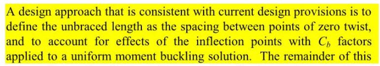

Yura's take on it is repeated below. I'll be waiting with baited breath to hear what AISC has to say about this but I'll also be utterly astonished if they break with Yura on this. It may we Yura providing the answer to your question, either directly or indirectly.

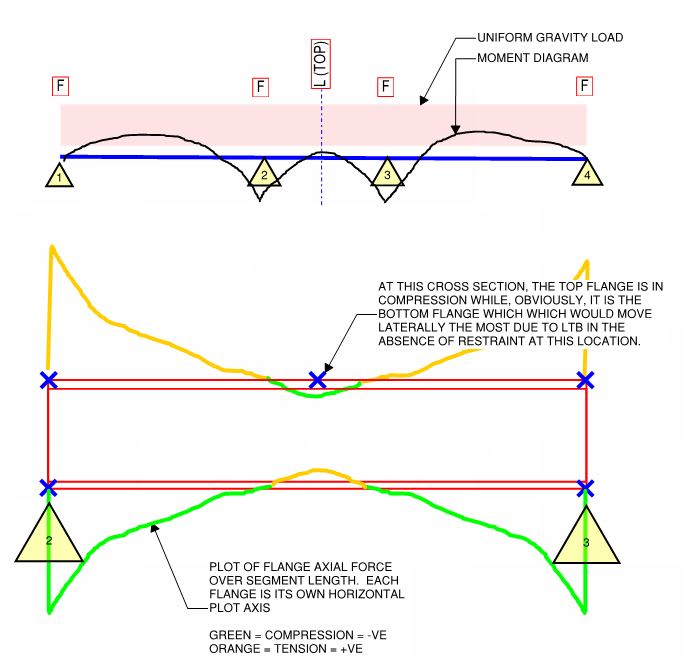

If I do a buckling analysis for a scenario like this, I get the top compression flange buckling the furthest at midspan where you proposed the L restraint. So I'm just never seeing this effect you are noting at that mid point of the middle span that the tension flange is buckling the furthest like you're stating/proposing?
My intent was to propose something almost like a calculus/limits scenario whereby the zone of compression in the top flange would effectively shrink to zero. Or, say, 6". In such a scenario, you'd have virtually all of the top flange in tension and virtually all of the bottom flange in compression. I had thought, with great confidence, that this would produce a situation in which:
1) The compression/critical flange for the first, central L-restraint would be the top flange but;
2) At the location of the central brace, it would be the bottom flange that moved the most.
But, then, your FEM says otherwise. I may have to fact check that with my own FEM, however, as I'm not sure that you modeled thing as I would have. Changes I would make include:
4) I'd shrink the zone of top flange compression a great deal.
5) I'd model the central span on it's own without weak axis end fixity.
If that still doesn't show the results that I expect, I'll just a have to accept that my instincts on this one led me astray. It won't be the first time.

But I am seeing in the negative moment region that the top flange in tension is moving further than the compression flange, which I assume is the point you're getting at?
Nope. That is interesting and meaningful but I did not anticipate that and was not looking for it.

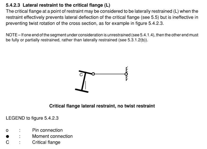

Celt, check out CL 5.4.2.4 (in AS4100) or CL5.4.2.3 (in NZS3404) for the definition of a lateral L restraint. Basically it's pinned to the flange, preventing lateral deflection, but not preventing twist, if attached to the non-critical flange then its considered to do nothing.
In NZS3404 commentary (unsure if its in AS4100 commentary as well), there are some conditions to meet regarding classifying restraints and the moment/pinned fixity. For a beam or purlin, if of sufficient depth with an appropriate connection, then most certainly it may be able to meet the P restraint condition you highlighted.
Beta_m in NZS3404 is defined as:-
I believe this is the correct interpretation, because you'll get quite a different answer if you used the eqn for alpha_m for comparison than what your calculation was in taking it negative.
I'll need to read over the AISC guidance, that compression flange criteria you've noted essentially seems like the same thing AU/NZ standards are considering to be honest, even if most people may not have picked up on it.
Since I checked and AS4100 does not have the same clarifying provisions, here is the NZS3404 provisions for classification of a restraint:-

Start with the Yura paper. And, if you want more, I highly recommend the book below. They derive much of the AISC stuff from first principles and show in enough intermediate steps on the math that you should have a pretty good shot at following along.

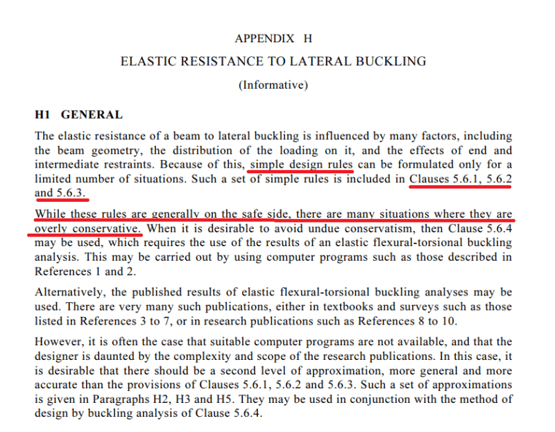

All our codes take short cuts for the sake of simplicity and ease. As long as they don't lead to unconservative outcomes then there isn't an issue. (Choosing the compression flange definition might be LESS conservative sometimes, but not necessarily unconservative. If you get my distinction.)
I view it exactly the same way. Sometimes the compression flange is a worse place to brace, but if it works it works.
It is a bit sad though that the simplified rules have led so many engineers into believing that the compression flange is always the best place to brace, and that bracing the tension flange is automatically inneffective.
I guess that this is just a philosophical difference. Sure, everything in engineering involves simplification and approximation. I don't, however, see that as justification for failing to understand the theoretical foundations of the simplifications and approximations that we use. Quite the opposite in fact. I think that shortcuts can be dangerous in the hands of those who don't understand the theory behind them.
