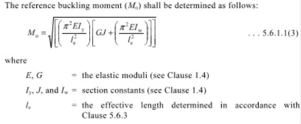

Mo:
where Iw = Cw in AISC = Warping Constant
E = 29000 ksi
G = 11200 ksi
Iy = 106 in4
le = 171.74 in
J = 2.81 in4
Iw = Cw = 17900 in6
Mo = 14527.68 in-k * 1 ft/12 in = 1210.64 ft-k

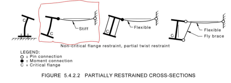

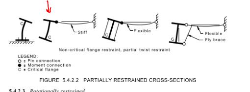

Question I am left with on this is the detail for partial restraint shows a fixed connection to the tension flange, would standard composite construction satisfy the fixity requirement? If not then I'd say you'd fall into an unrestrained condition and land back at an unbraced length of 32 ft which from quick numbers following the same procedure in AS4100 yields only 443.31 ft-kips, or less than that of my current AISC approach.

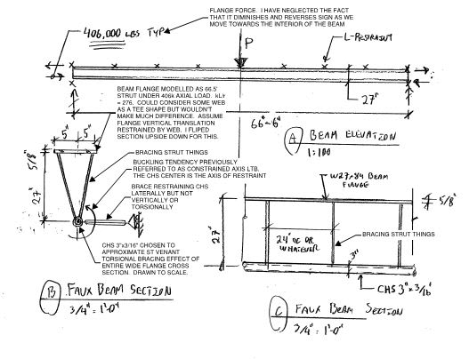

1) I could run it in Mastan. I may do this eventually but I wouldn't hold your breath.

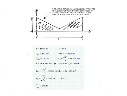

2) I could transmogrify your example into one of my own that I feel does an excellent job of teasing out the salient issues and placing them into a context in which "reasonableness" may more easily be judged via intuition. Truly, you'll have to just download the sketch and read the damn thing start to finish. Brief summary:
START
a) I assumed that bottom flange buckling is restrained by two, torsional stiffness components: the St. Venant and the Warping.
b) In the context of constrained axis buckling, the warping stiffness "is" the flange buckling laterally. So that's baked into the cake.
c) I replaced the St. Venant stiffness of the entire wide flange with a CHS member having nearly the same St. Venant stiffness. Everything is drawn to scale.
d) To make the thing tractable, I neglected some things such as the fact that the axial force in flange varies spatially. Still, it is a strut with 406K axial load applied to its ends.
e) The example considers the compression flange of the beam as a 66.5' flange-column having a slenderness ratio of 276. The flange-column would have axial compression loads to the tune of 406,000 lbs applied to the ends. This is actually more than the {As x Fy = 312k] of the flange. That's immaterial really though. 312k or 406k, it's a crap ton of of axial on a 66.5' column with a 276 slenderness ratio.
f) Naturally, we must consider that the flange-column is actually braced along it's 66.5' length. That bracing:
a) comes from the St.Venant torsional stiffness of the section;
b) varies linearly in it's effectiveness;
c) is at a maximum at near the supports and;
d) is at a minumum at the center of the beam.
This is what I have represented with the CHS section in the faux representation.
FINISH
So, assuming that I haven't screwed something up in my rush to pull this together, the question becomes:
How reasonable is it for us to expect that the 66.5' flange-column of my faux model will not buckle under a 406,000 lb load?
Seriously, what do you think?
EDIT: here's a dropbox link to the sketches in PDF format: Link. The file upload feature here is no longer working for me either.

Celt, the restraint you're assuming isn't classified as an L restraint. That's a P restraint. An L restraint is just preventing lateral deflection of the critical flange, not preventing twist. So only the restraint at 8' is effective, I've argued I'd only take the one at 12' being effective due to the proximity of the inflection point.

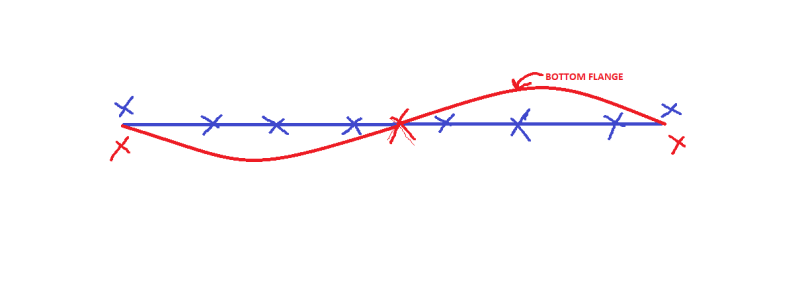

A challenge for you Human909: sketch me a single bucking mode that would be further up the list in terms of its eigenvalue and could possibly occur in the presence of the lateral restraints. Just one.

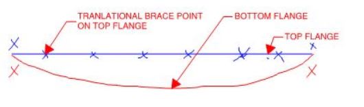

Probably should have said I looked at the segment from 4' to 8' which looks to only classify as P restraint on either end, which is why I chose that segment.
All the definitions for L restraint seem to contain a "and act at the critical flange" clause, so seems I'd agree with you that the first x in KootK's sketch that could count as L bracing would be at 12', so my take on the lateral bracing classification across the beam would be:
F P P L L L P P F

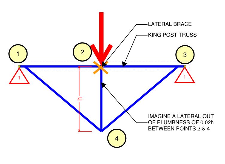

I disagree. Following your lead, I'll try to persuade by way of a hyperbolic example.
Would you say that the lateral brace at [2] makes this truss immune to LTB? Of course you wouldn't. But wait, isn't this different because it lacks rotational restraint at the ends?. Nah, not fundamentally. The rotational restraint at the ends increases the resistance offered to LTB but does not eliminate the fundamental tendency towards LTB. We could do something similar with a flat truss having end rotational restraint but it would take me all night to do a decent job of the buckled shape.
I thought I've answered that. There has never been any disagreement that if the top flange is FULLY restrained then the next up on the list is bottom flange buckling as you have illustrated. Christ I even posted a picture of it myself several dozen posts ago.

KootK said:
Ideally, I would have you each post a sketch similar to mine showing the expected movements of both flanges in plan.
How hard is it to just draw two colored lines and send that over to me? Surely, after all the effort that I've poured into assisting you here, you could do that much for me before your withdraw?
This statement is basically saying that constrained axis lateral buckling IS the critical buckling mode. And that's in complete opposition to what you've been telling me for some time. What gives? If this means that your sketched, critical buckling mode would be identical to mine then please just say so. In that case, no sketch from you required.
You've posted a ton of pictures. How on earth am I supposed to know which one you meant to answer my question with? Regardless, wouldn't reposting that picture -- or just giving me the two lines that I seek -- be far less effort that fighting me on this post after post?
Lastly, note that any buckling mode should have the beam pinned with respect to weak axis bending and the supports. Otherwise, it's not an apples to apples comparison with the base code methods. Your models seem to consistently show weak axis rotational fixity at the supports.
I didn't see Kootk's bottom flange buckling mode in Human909's images, but Agent666 mastan2 results seem to show it.

Regarding your other checks, with AS4100/NZS3404 and the L restraints to the top flange, when the bottom flange is in compression, it's deemed the critical flange. Therefore the L restraint to the top flange is basically nothing and has no consideration. Therefore the first restraint to the critical compression flange is at 8' or 12' depending on your view.
So saying there is a P restraint at 4' isn't a correct approach.
Best way to think of it is as follows, just determine if a flange is in compression at the point of restraint and pickup the appropriate restraint. Noting an F restraint to the tension flange can be a P restraint in terms of the compression flange. But other than the designation changing an F & P are the same analytically for determine the effective length.
Code:
Top flange restraints
FLLLLLLLF
F-------F
Bottom flange restraints
- = no restraint if the flange is in compression at this station.
so is it then a fair assumption to say that standard construction doesn't satisfy the P restraint condition indicated in figure 5.4.2.2, otherwise this would seem to be at odds with your statement?

From a purely semantic view the definition of Lb very specifically says "..points that are either braced against lateral displacement of compression flange or.."
so at 0' the bottom flange is in compression and braced at the support
in the range 0' < x <= 8' the bottom flange is the compression flange and unbraced
at 8' neither flange is the compression flange as this is the inflection point
at 12' the top flange is now both the compression flange and braced
so by a literal interpretation of the definition of Lb the unbraced length could be taken as 12'.
Reviewing all of the FEM results presented by Agent666 and Human909 this would seem to align with the buckling results they are getting.
My use of the full length for the bottom flange check was really just an extension of what you would do for a roof beam controlled by wind uplift, or put another way a beam that experiences negative bending across the full span. In this case I think AS4100 would seem to treat the beam identical to AISC.
I need to do a lot more reading/research/re-learning on my end to bring an approach founded in first principles to this though.

This procedure brings me back to my questioning of the interpretation of 5.5.1.1 and, in particular, the importance of the word "that" in that clause. Given a hierarchical procedure like that described above I would revise step #4 as follows:
4) If LTB governs over the other stuff and capacity is insufficient, add one brace to the critical flange at the proposed location of the the brace. The critical flange shall be that flange which would move the most under LTB buckling at the location of the proposed brace with the restraining effect of all previously added braces accounted for. Otherwise STOP.
For example, in checking constrained axis LTB, you'd come to that already assuming the presence of all the top flange restraints. As such the only flange capable of moving would be the bottom flange. So the bottom flange would be the critical one across the entire length of the beam for this particular LTB mode which is, of course, exactly as it would have to be if one were seeking to add a bottom flange brace in order to progress to the next possible LTB buckling mode.
What I find particularly interesting about 5.5.1.1 is that, in my opinion, a literal read of that clause should suggest exactly the interpretation that I've outlined. No "bending to my will" required. Were I a martian spending my first day on earth, my interpretation is how I would read 5.5.1.1 from the get go. I was surprised to learn that it is not, in fact, interpreted as I have outlined.
