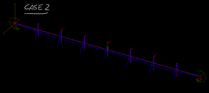

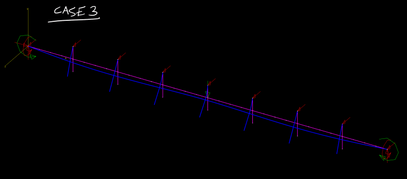

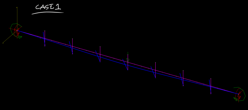

steveh49, I'll try setup the following cases over the next few days in mastan2:-
1. no intermediate restraints as per AISC.
2. adding only the L restraints in the middle portion where the top flange is in compression (comparable to how you would apply the code provisions).
3. all L restraints to the top flange as per original sketch.

steveh49, results below for an elastic buckling analysis in accordance with AS4100/NZS3404 for kootks test case. Same capacity more or less as human909s Spacegass test calculation (phiMbx = 544kNm vs 543.6kNm). Not entirely unexpected.
Haven't worked out the alpha_ m factor using the elastic buckling analysis method, but don't think it will change.
For case 2, phiMbx = 1206.7kNm (not quite FLR)
For case 3, phiMbx = 1240kNm (just made it over FLR condition)
Agent, does that show buckled shapes for those cases?
Sure, though I will say once you start working with restraints that are not on the member centerline, the answer does become sensitive to what stiffness you have to represent the web upstand for locating the restraint at the flange level. I've found taking a bit of plate equivalent to the beam depth at the web thickness seems to give a lower bound type approach representing some some deformation in the web to centerline. In reality the continuity of the flange spanning horizontally probably helps. No real bench-marking of this approach though, just engineering judgement. If there were stiffeners I'd make it stiffer.
Note that the scale is severally distorted here (scaled up ~400x)

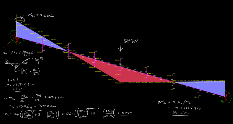

For case 1 if I determine alpha_m via the buckling analysis, for the alpha_m=1.0 scenario the buckling moment is 416.5kNm. (note very close to the alpha_m calculated in post above from the table 5.6.1)
So alpha_m = 718/416.5 = 1.724 (vs 1.71 calculated via the table for alpha_m.
These results for case 1 are not unexpected, after all the equations in the code are intended to represent the theoretical buckling behaviour. The buckling analysis is simply solving the underlying finite element derivation for lateral torsional buckling.
