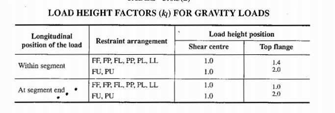

I take the table below as meaning that you only need to account for the destabilizing effect of vertical load position when the load is physically applied to the segment (mid-length or at the ends). I assume that this applies to sub-segments as well as full segments which seems to be consistent with your calculations.
With respect to the W27 example, this would mean that the negative moment capacity check would be unaffected by load position (kl=1.0). Yet, when the bottom flange kicks out at mid-span as a result of negative moment LTB, the load will move closer to the earth because it is top flange loaded rather shear center loaded. This is because a load applied at a higher elevation will lower more for the same beam rotation. So how does this make sense from an energy conservation perspective? It's almost as though the design procedure assumes F restraint at the ends of all sub segments for this purpose.
The negative moment segment has no load applied to it, so yes k_l is taken as 1.0.

Human909 said:
Kootk I've updated the results. It changes the story a bit.
It does indeed. Now AS4100/AISC = 1.53 which is becoming a substantial discrepancy. And that's with the AS4100 capping out at yield. Take that cap off and I'm sure the discrepancy would be even greater.

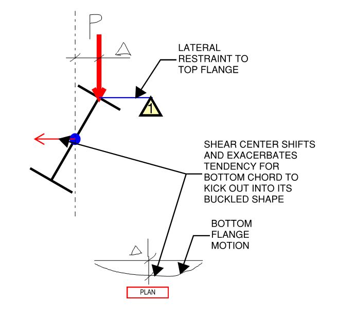

I get that's how the code reads. What I'm questioning is whether or not that's theoretically correct. It appears not to be.
Agent666 said:
The load is constrained to act through the shear center.
I don't believe that it is. When the bottom chord kicks out, the shear center moves. And that creates the same eccentricity as though the top flange had moved.
Agent666 said:
L restraint prevents lateral deflection of the critical top compression flange, in doing so the load cannot move laterally which is what this factor is accounting for.
Lateral motion of the load isn't really what the factor accounts for in my opinion. Much more precisely, what it accounts for is the eccentricity between the load and the shear center. Like a localized P-delta effect.

I think the difference is that the tension flange wants to move back to where it was, whereas a compression flange with the load applied wants to carry on and buckle. So in effect the tension flange even if it moves sideways still reaches a new state of equilibrium that is not inherently unstable, apply more load and it tries harder to stabilise itself as opposed to wanting to get all unstable and so forth.
Its sort of similar to applying the load to the bottom flange below the shear center, tension flange is doing its best to help keep thing stable if you've prevented movement of the critical compression flange.
I agree that the the tension flange would fight movement more than a compression flange. That said, the tendency for exacerbating bottom flange kickout still exists and, therefore, so does my minor concern with this.

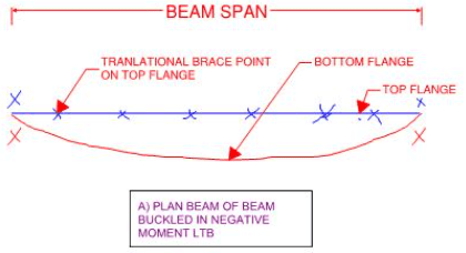

KootK +/- said:
A) THE CLAUSE IMPLIES THIS
When studying brace point #7, it is prudent to consider the absence of brace point #7 concurrently with the presence of all other compression flange brace points. It is this mental experiment that guides us to our determination with respect to which flange is critical and which flange moves the most in the absence of restraint.
B) THE CLAUSE DOES NOT IMPLY THIS
When studying brace point #7, it is prudent to consider the absence of brace points 2,3,4,5,6,7,8 (no restraint other than at the member ends).
I still feel that interpretation [A] may be correct. It's tough to articulate why but I'm ready to give it a shot.
Consider two buckling modes:
1) The completely unrestrained case which is the lowest energy buckling mode and;
2) The case below which I have submitted is our "real" LTB case and is a higher energy buckling mode.
I think it stands to reason that one set of assumptions regarding bracing, critical flanges, etc can only apply to one buckling mode. And if you go with option that bucking mode will the the unrestrained bucking mode. So, given that, how could that same set of assumptions regarding bracing, critical flanges, etc also apply to buckling mode #2? I don't think that it can.
I feel that this might warrant another search for published examples to show what is actually done in this regard. My SSDM example from above doesn't have anything to say about this. Note that I haven't yet scoured the available examples myself. You know, time being finite and such.
Kootk,
Your mode 2 is a much higher energy state, thus more resistant to buckling, and isn't critical for design purposes.
When the top flange is restrained the bottom flange isn't nearly as free to buckle as you are imagining.
