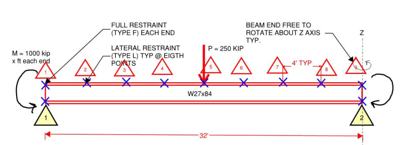

I'd also like for all parties to agree on the interpretation of the clause below.
THE CLAUSE IMPLIES THIS
When studying brace point #7, it is prudent to consider the absence of brace point #7 concurrently with the presence of brace points 1,2,3,4,5,6,8. It is this mental experiment that guides us to our determination with respect to which flange is critical and which flange moves the most in the absence of restraint.
THE CLAUSE DOES NOT IMPLY THIS
When studying brace point #7, it is prudent to consider the absence of brace points 2,3,4,5,6,7,8 (no restraint other than at the member ends).
THE POLL
Anybody disagree on this point?

This sure does get complex. I was reading the doc below and, based on that, it sounds as though Trahair would have actually have preferred several methods even more complex that the current AS4100 one. I pitty the fool who finds himself a structural engineer in AU with English as a second language.

That was by design (see my mathcad work in the problem statement). For modelling, I'd recommend either:
1) Jack up fy so it doesn't yield and accept a purely elastic buckling analysis or;
2) Keep the inelastic analysis and just report an ALR (applied load ratio) on a dummy applied load.

I'm not so sure. This might be yet another case where the wording is actually perfect in the literal sense. It's also partly why I was harping on the one stage vs two stage procedure previously. Done as separate checks for bottom chord and top chord buckling as we do in North America, it would go:
1) Study top chord buckling and cycle through each brace considering it removed with it's neighbors at compression location present.
2) Study bottom chord buckling and cycle through each brace considering it removed with it's neighbors at compression locations present.
Like anything else, judgement would eliminate 3/4 of the cases and it would go quickly. This would also be easy to program because it's methodical.

@Human909: Can you force your tool to run it at Le = 32' somehow? This would be how I would have done it if left to my own devices, pre-thread.
I gotta dissapear for a bit but here you go Kootk:
Le=32ft

Well can I confirm a couple of things to get underway:-
The A36 material, is it actually 248.2MPa for both web and flange like human909's example implies (i.e. not different yield stresses for flange and web like many AU/NZ sections), only important for shear capacity I guess if there was shear and bending interaction.
Whats up with the section dimensions of the W27x84? Me no understand given my ignorance with american sections?
The web is noted as 7/16" thick, then how is 1/2 the web thickness = 1/4"? Trying to work out root radius also results in no agreement between the k-t_f and k_1-t_w/2 dimensions. F#$%@%@g imperial rubbish? How are we supposed to work out section properties to AS/NZS standards without knowing the exact dimensions? Can someone please post this so we are working things out to the same dimensions.
is the decimal value correct? as just noticed many don't equal the imperial fraction.....

kr = 1.00 (5.6.3) Le = 2.438 m (Bending) (5.6.3)
Lx = 9.754 m (Compression) Ly = 9.754 m (Compression)
Lz = 9.754 m (Torsion)
Ly/ry= 185.4 (Compression) Le/ry= 46.3 (Bending)
Arf = 0.0 mm^2 Arw = 0.0 mm^2
An = 15935.5 mm^2 Ae = 0.0 mm^2 (6.2.2)
Kf = 0.00 (6.2.2) Kt = 1.00 (7.3)
αm = 1.82 (5.6.1.1) αs = 0.89 (5.6.1.1)
αcx = 0.00 (6.3.3) αcy = 0.00 (6.3.3)
αb = 0.00 (6.3.3) βme = 0.00 (8.4.4.1)
βmx = 0.50 (8.4.2.2) βmy = 0.00 (8.4.2.2)
γ = 0.00 (8.3.4) ϕ = 0.90 (3.4)
N* = 0.00 kN
Vx* = 0.00 kN (not considered) Vy* = 556.03 kN
Mx* = -1355.82 kNm (Compact) My* = 0.00 kNm (Compact)
ϕNt = 0.00 kN (7.2) ϕNs = 0.00 kN (6.2)
ϕNcx = 0.00 kN (6.3.3) ϕNcy = 0.00 kN (6.3.3)
ϕNoz = 0.00 kN (8.4.4.1) ϕMo = 4476.96 kNm (5.6.1)
ϕVvm = 876.75 kN (5.12) ϕMf = 847.98 kNm (5.12.2)
ϕMsx = 1240.57 kNm (5.2) ϕMsy = 161.68 kNm (5.2)
ϕMbx = 1240.57 kNm (5.6) ϕMox = 0.00 kNm (8.4.4)
ϕMrx = 0.00 kNm (8.3.2) ϕMry = 0.00 kNm (8.3.3)
ϕMix = 0.00 kNm (8.4.2.2) ϕMiy = 0.00 kNm (8.4.2.2)
ϕMtx = 0.00 kNm (8.4.5.2) ϕMcx = 0.00 kNm (8.4.5.1)
Mx*
---- = 1.09 > 1.00* (Fail) Flexural-torsional buckling (5.6)
ϕMbx
Le=L As per KootK
AS4100 1998 CALCULATIONS FOR GROUP 1 (*=Failure)
Critical load case is 1, out of 1
Section: *W27x84 (I or H section, Rolled/SR)
Failure Crit Start Finish Axial Major Minor Major Minor Load
Mode Case Pos'n Pos'n Force Shear Shear Moment Moment Factor
Section 1 0.000 0.00 0.00 556.03 -1355.82 0.00 0.91*
Member 1 0.000 9.754 0.00 -1355.82 0.00 0.40*
Shear 1 0.000 0.00 0.00 556.03 -1355.82 0.00 1.03
(1.00)
Grade= 50 Fy = 344.7 MPa
Fyw = 344.7 MPa Fu = 448.2 MPa
Ltot = 9.754 m Lseg = 9.754 m (FF Bot-Bot)
kt = 1.00 (5.6.3) kl = 1.40 (5.6.3)
kr = 1.00 (5.6.3) Le = 9.754 m (Bending) (5.6.3)
Ly/ry= 185.4 (Compression) Le/ry= 185.4 (Bending)
αm = 1.70 (5.6.1.1) αs = 0.26 (5.6.1.1)
αb = 0.00 (6.3.3) βme = -1.00 (8.4.4.1)
N* = 0.00 kN
ϕNoz = 0.00 kN (8.4.4.1) ϕMo = 378.60 kNm (5.6.1)
ϕMbx = 543.63 kNm (5.6) ϕMox = 0.00 kNm (8.4.4)
Mx*
---- = 2.49 > 1.00* (Fail) Flexural-torsional buckling (5.6)
ϕMbx
So according to your calc the beam has FLR which I'd expect as in it's a fairly large beam restrained to hell and back, its just the moment is higher than the section capacity so it was never going to work.
I'd probably take the next L restraint back from the IP just because it seems like you're assured it'll be to the compression flange which is the critical flange at this location. But I'd imagine the same or similar result given the moment gradient and resulting alpha_m and alpha_s product being easily greater than 1.0.
