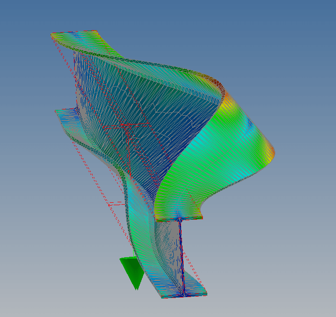

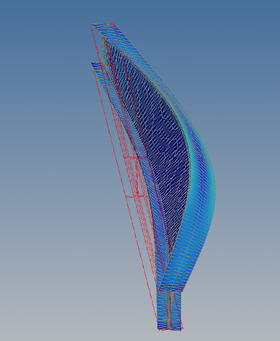

I've done some buckling analysis with Nastran In-Cad with various loading scenarios, simply supported and continuous. Top flange loaded and centre of beam loading. I've been getting the top flange buckling every time as the first buckling mode. I haven't really thought much was worth posting... AS4100 seems to be consevative by at least 50% for the scenarios being discussed on the particular model I chose. (8m long 250UB31)
Of course you can always resort to LTB theory or simply run ask yourself which buckled shape has lower energy under gravitational load.

Human, what type of analysis are you performing an elastic critical buckling analysis? And what is the loading and restrain conditions for the model picture you posted? You say you tried a whole lot of different things in the post but didn't make it clear what scenario you posted (just so we are all on the same page)?
Hey Agent. I've been performing linear buckling analysis. Non-linear is slower and seems to be virtually identical so I've stuck with linear for speed.
-Loading in the model picture was centre point load located central to the web. Fixed restraints at the end.
All the scenarios displayed similar top flange buckling as would be normally expected under gravitational load.
(Though you can get potentially get bottom flange bucking if you have no lateral or rotational at a support.)
Sorry for the lack of detail. I just posted the picture more as an example to people rather than evidence of anything. Like I have said nothing was surprising so there isn't much to post. But if you want a scenrio run I can do that. When I say nothing is surprising I mean it buckles as expected and as indicated by AS4100. When restraints are placed on a cross section of the critical flange the buckling load significantly increases.

If you have a chance could you do one with no lateral rotational restraint.
Sure. But you are going to have to be more specific. We need some rotational restrain otherwise it is unstable.
I mean without lateral rotational restraint at the supports. I.e. make the beam pin ended in plan. Currently it appears fully fixed against lateral rotation, ie the supports are providing very significant restraint to the lateral part of the buckle.
No matter how you spin it. With a single span you still have top flange buckling. There is no scenario that I'm aware of where the bottom flange buckles that reduces the potential energy.
