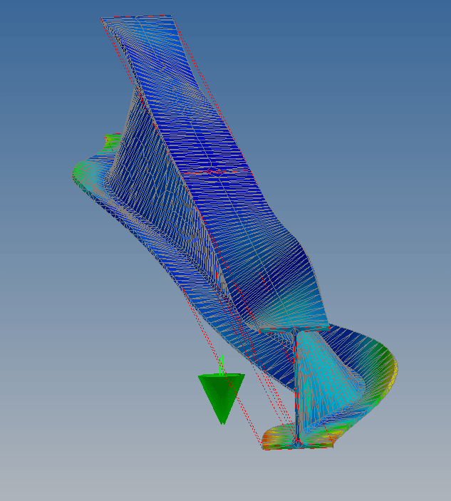

For this, I submit that you're using incorrect assumptions. The "next in line" buckling mode for the beam under consideration is section rotation about the intersection of the web and top flange. So there should be no lateral movement of the top flange to consider. And yes, the lateral restraints to the top flange do improve capacity. That's what changes the buckling mode from:
1) Rotation about a point in space above the shear center and, in all likelihood, well above the beam to;
2) Rotation about the point in space where the web intersects the top flanges, sometimes termed constrained axis buckling.
Just an FYI. I looked at multimodes and still didn't see the buckling mode you described. I ran a large variety of gravitational load cases with different restrains, different load heights and included some continuous beams. The only time I ever got significant movement of the bottom flange was bottom supported unrestrained at the support. (Which isn't surprising if you view the support as an upwards load.) I haven't posted all this because nothing I found was particularly noteworthy.
I'm not surprised. As I mentioned somewhere above, I think that it would take a pretty contrived example to make OP's real world situation go south. But I'm going to do my darnedest to contrive just such an example. We. Shall. See.

HUman said:
As I showed above I did force the buckling mode out of the closet with the restraints you mentioned and plenty of load.
Did you restrain only top flange? I would have thought you'd see a half wave buckle of the bottom flange. That's what kootk is concerned about.

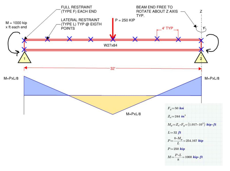

Revised, proposed test case attached and shown below. Closer to OP's case and should do more to exacerbate effective length discrepancies.
think that 24 ft in your diagram should be 32 ft
Edit:
I know you all are focused on the AS4100 and I'm interested to see the various results after reading all of the above.
As some one that was taught AISC's method this is how I learned to check KootK's above example:
Lb for postive moment = 4 ft < Lp = 7.31 ft determined via equation F2-5 -> Lp = 1.76 ry sqrt(E/Fy)
LTB not applicable for this case
Mp = Zx Fy = 1016.67 ft-kips equation F2-1
Lb for negative moment = 32 ft > than both Lp and Lr -> LTB must be checked

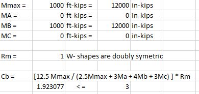

Calculation for Cb:
Calculation of Yielding, LTB, and Compression Flange Local Buckling:

As I see it, the buckling mode shown below is the only practical LTB buckling mode worthy of consideration here. OP didn't tell us the joist spacing but I presume it's close enough that the top flange can be thought to be continuously braced.
Does anybody disagree that the LTB buckling mode shown below is "the thing" as far as this discussion goes? We're wasting our time on the rest if we don't all first agree on this.
Yes.
I've never seen this in my modelling and I've tried hard to make it happen. (short of imposing loads upwards) It also doesn't make sense to me as a possibility because a full wave would mean an increase in height of the loaded points on the beam. Which goes against energy conservation. (If the beam buckles you must have a weighted net movement of the load on the beam in the direction of the load, otherwise conservation of energy is violated!)
Other codes for comparison are just as important. Thanks.

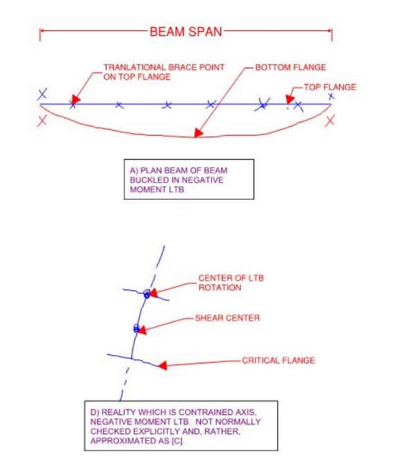

Kootk said:
It should be what everybody is concerned about.
From my perspective the conversation long moved away from the example you posted because we spent a while discussing and analysing the UNRESTRAINED case. If we are talking about continually restrained top flanges then that is an entirely different scenario. The effective length according to AS4100 is heavily reduced as previously discussed. To reiterate we get 3 segments with their effective length the distance from the restraint to the inflection point, inflectio to inflection and inflection to restraint.
The inflection point isn't a restraint, but it is where the restrainst become effective if you follow AS4100.
SpaceGass and Microstran implement it this way.
Correct. Gratitude.
1) I was intending to do this anyhow so you've saved me some effort.
2) This serves as a nice check that the example makes sense and produces the result that I was intending.
3) Acknowledging that I'm surely bypassing a lot of nuance, it seems to me that the AS4100 effective length would need to be about 400% of the segment length for equivalency.
4) I would have calculated this as you have. That said, it's prudent to acknowledge that this method is not the constrained axis method which would yield a higher capacity. This is what I was alluding to in the statement below from long, long ago. This is yet another thing that I'm starting to wonder about. Perhaps the AS4100 method does actually account for the contrained axis effect in a way that the stock AISC procedure does not.
KootK said:
6) As shown in sketch D below, our real world expectation is actually constrained axis buckling about the top of the beam. This usually has a higher capacity than sketch C but is a serious pain the the butt to calculate so we just go with sketch C and call that good enough.
I disagree. Anything that rolls the beam on its side and results in deflection tend towards the Iy value rather than the Ix satisfies the energy conservation. That said, these points are germane to this. The effect of the top flange rotating and initially raising the joists would be an example of the secondary peak/trough business.
