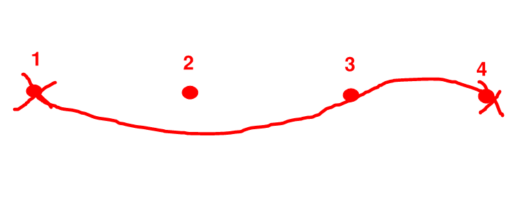

Agent said:
but in the interim I and others want to know what situation you are interpreting the tension flange as wanting to buckle the furthest at a point of restraint?
The continuous beam scenario. Continuous beam with full restraint each end, but no lateral restraints.
Look at kootks post on 17 Oct 19 22:56. like that with no lateral restraints. Just F restraints at the supports.
The bottom flange has varying stresses, ranging from compression at the ends, to tension in the middle.
The top flange has the opposite stresses.
I think the bottom flange will deflect further at every cross section when the beam buckles. Even where the bottom flange is in tension.
On the other hand human is saying his buckling runs show the opposite, and always show the top flange buckling more (which in itself would contracdict the compression flange always being critical, since much of the top flange is in tension).
And you're saying I'm completely misunderstanding it because you need to take the cross section in isolation.
So I'm not really sure what to make of it..
