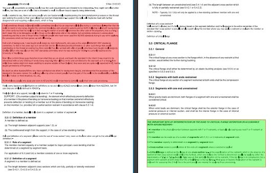

This post will concentrate on stating exactly how the code requirements are intended to be interpreted. They might not reflect other realities, but they are a set of rules that is intended to result in a lower bound capacity being determined.
Firstly I wanted to say, there are some people who are fundamentally misinterpreting the AS4100/NZS3404 provisions in this thread and twisting the words to their own related but incorrect interpretations. I suspect this reply will maybe be meet with further disagreement and requiring endless proofs, which is fine.
I feel sometimes threads on lateral stability sometimes devolve into an argument a little like trying to convince a flat-earther that the world is round or vice versa, despite the common knowledge and education systems and so forth (including real proof) having known for a few centuries that the world is in fact round. No matter of proofs will convince the other side of the argument, this is a fact. I don't mean this to be derogatory at all to those on the alternative side of the debate, but sometimes everyone is wrong about something and this is one of those times I feel with people who have never used the AS/NZS standards trying to say we're applying the provisions which we have grown up with all wrong.
First a bit of background, I was taught steel design by John Butterworth, who was on the original NZS3404 1997 standards committee, he died a few years ago so I cannot ask him for clarification/proof/confirmation or other such things that people contributing to the thread are asking for. More recently I've also worked with a lot of people who have been taught steel design by Charles Clifton who was also on the 1997 standards committee when he was working for HERA. He currently teaches at the University of Auckland.
Now I like to think those guys therefore know what they are on about, and teach the standard in the intent it was meant to be interpreted without any twisting of words being required. After all they wrote and contributed to the standard as it is today. Now while those names might not mean anything to anyone outside of New Zealand, they were and are quite well respected in NZ, having taught generations of Engineers.
No doubt as other Aussies/NZ'ers who have contributed can attest to having been taught, and interpreted the provisions of the standard in the same manner I'm outlining below by other eminent people from this part of the world in the steel/stability world like Nicholas Trahair or Mark Bradford, etc, etc.
TLDR - Believe people who study and work in NZ and AU would know how to correctly apply their own code provisions.

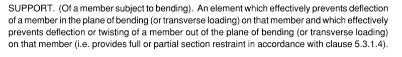

Firstly some background/clarification on definitions so we are talking AS/NZS nomenclature (note all taken from NZS3404, but I'm sure they are similarly defined in AS4100).
Firstly let's look at a support, basically boils down to F or P restraint.

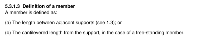

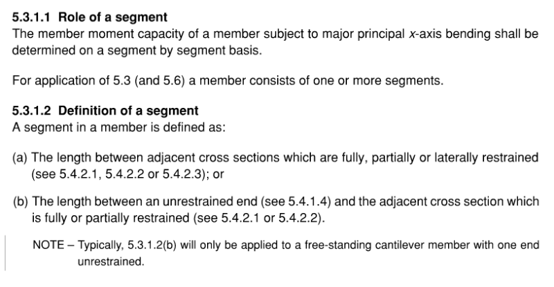

Definition of a member, basically boils down to a segment or number of segments:-
Role and definition of a segment (please note the use of 'cross section' here, more on this later when we get to the critical flange definition):-
Definition of a cross section:-
Well one isn't included, but it's fairly obvious based on the segment definition and the language in the entire remainder of the standard that 'cross section' is actually simply a point along the member where you may apply a restraint or evaluate the member or section capacity.

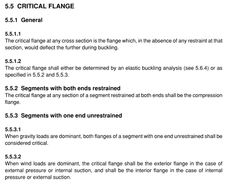

Definition of critical flange

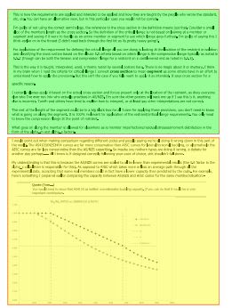

THE IMPORTANT BITS OF INTERPRETATION ON THE ROAD TO CRITICAL FLANGE DEFINITION IN ACCORDANCE WITH AS4100/NZS3404:-
1 - A member is the physical member between supports with F or P restraints, or basically also saying you need F or P restraint at supports
2 - A member can be made up of a number of segments with F, R, L or U restraints at segment ends
3 - The member capacity is determined on a segment by segment basis
4 - Cross section means a point/location at the ends of a segment where a restraint is applied
5 - Critical flange is defined as the flange at any cross section (i.e. at the exact location of the restraint) which in the absence of a restraint at that cross section would deflect the furthest, which one deflects the furthest is determined usually by applying either the requirements of 5.5.2 or 5.5.3. Basically 5.5.2 says at that particular location of the restraint, if the top flange is in compression (for a segment with restraint at both ends) then the critical flange is the top flange. What goes on beyond the location of the restraint is irrelevant for assessing this (I feel this is the point people are missing for applying these provisions).
This is how the requirements are applied and intended to be applied and how they are taught by the people who wrote the standard, etc, etc. You can have an alternative view, but in this particular case you would not be correct.
I'm guilty of not using the correct terminology, the reference to the cross section in the definition means just that. Consider a small slice of the members length as the cross section. So the definition of the critical flange is not based on looking at a member or segment and seeing if it were to buckle as an entire member or segment to see which flange goes furthest. I'm guilty of saying this I think earlier on in the thread (I didn't read back through the first bit as its pretty heavy going!).
For application of the requirement for defining the critical flange all you are doing is looking at the location of the restraint in isolation and classifying the cross section based on the clause 5.5 criteria based on which flange is the compression flange typically as noted in 5.5.2 (though can be both the tension and compression flange for a restraint on a cantilevered end as noted in 5.5.3).
This is the way it is taught, interpreted, used, a theme noted by several posters here. There is no magic about it or mystery. I think in my brain when I read the criteria for critical flange I convert cross section to mean segment as some others have in an effort to understand how to apply the provisions. But this isn't the case if you fully want to apply it as intended. It says cross section for a specific reason.
I certainly always apply it based on the actual cross section and forces present only at the location of the restraint, as does everyone else who I've ever run into who actually practices in AS/NZS. I'm sure the other posters will back me up if I say this is it, anything else is incorrect. Tomfh and others have tried to explain how to interpret, or at least say other interpretations are not correct.
The rest of the length of the segment could be in a big black box for all I care for applying these provisions, you don't need to know what is going on along the segment. It is 100% irrelevant for application of the restraint/critical flange requirements. You only need to know the compression flange at the point of restraint.
What goes on along the member is allowed for elsewhere as is member imperfections/residual stresses/moment distribution in the form of the alpha_m and alpha_s factors.

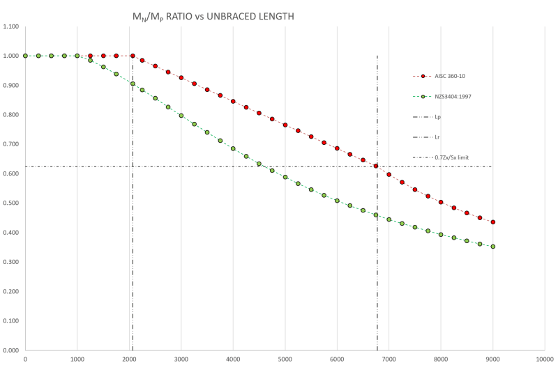

I would point out when making comparison regarding different codes and people saying we're all doing it wrong down in this part of the world. The AS4100/NZS3404 curves are far more conservative than AISC curves for lateral torsional buckling, or alternatively the AISC curves are far less conservative than the AS/NZS capacities. So maybe you nothern types are doing it wrong, a debate for another day perhaps..... All I know is if designed correctly following your code of choice, shit shouldn't fall down.
My understanding is that this is because the AS/NZS curves are scaled to all be lower than experimental results (the 0.6 factor in the alpha_s calculation is responsible for this). As opposed to AISC which takes more or less an average path through all the experimental data, accepting that some real members could in fact have a lower capacity than predicted by the code. For example, here's something I prepared earlier comparing the capacity between AS\NZS and AISC codes for the same member/situation:-
Tom... said:
You would need to show that AS4100 as written overestimates buckling capacity. If you can do that it would be a very important contribution.

Yes Australian practice is to assess the cross section at the location of the lateral restraint. The flange can be considered laterally restrained if it would buckle farthest in the absence of that restraint, or if that flange is the compression flange. These L restraints define your segments (“sub segments” in AS4100 terminology), which defines your effective length. So we appear to be in full agreement here.
The part I find murky is the critical flange definitions. Sometimes the flange which will buckle farthest is not the compression flange.
I’m not sure if this is deliberate and the code is saying that it’s fine to take either flange as critical on these situations, or if something else is going on. It would be interesting to see some buckling charts comparing the effectiveness of
1. Restraining the flange which will deflect farthest
And,
2. Restraining the compression flange.
Maybe both are perfectly adequate. I’ve run a few buckling analyses and it seems like much of the time it really doesn’t matter where you brace the cross section as far as preventing lateral torsional buckling.
So maybe the critical flange logic isn’t so much about identifying which of the two flanges will prevent buckling, and which one won’t, but is about weeding out especially crappy points of restraint.
All the code is saying is restrain the compression flange at the point of the restraint, because it defines this as the critical flange being the one that would deflects the furthest at that point. It defines this 'deflecting the furthest' thing as being satisfied if you basically restrai whichever flange is the compression flange for a segment with restraint at both ends, or both flanges for free at one end.
It's not expecting you to do some fancy analysis to prove it which I think others are getting bogged down on, its just a criteria that you apply directly. Whether the flange at that location really does deflect the furthest in reality is irrelevant, as you say even a 'L' restraint to the non-critical flange actually does something if you go through the buckling analysis route (i'd ignore it though, but just saying), even if it's not relied on in terms of the code.
Providing the right type of restraint to the non-critical flange like twist restraint still results in a P restraint at that cross section. Which for all intents and purposes is no different to direct restraint of the critical flange. Providing restraint to the flange in compression irrespective of where the restraint is improves the effective length.

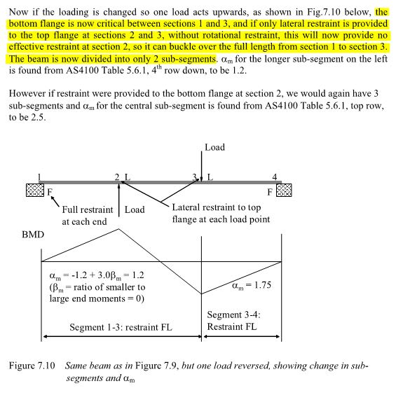

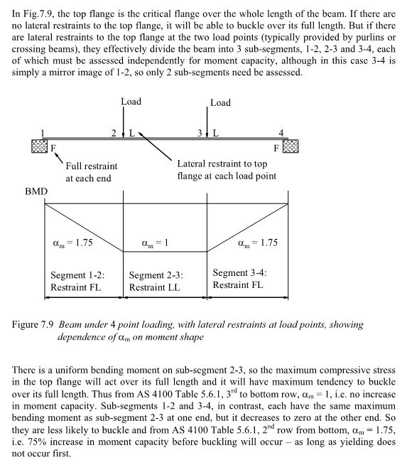

So I got to thinkin'... if this wonky design method that Tomfh and Agent666 keep going an about is so ubiquitous, it must show up all over the place in Australian steel text books and design guides, right? And if that's the case, surely such documents would be worthwhile examples for us to ponder. So I set about trying to find such an example in my limited, antipodean library.
My quest was not an easy one. I have a text by the legend Trahair that, somehow, contained not a single example of an LTB check on a beam with an inflection point. But I hit pay dirt with a publication titled Steel Structures Design Manual to AS4100. In the preface, the authors describe the manual as "a self-instruction manual for beginners". Now we're speaking my language. I've attached an excerpt the relevant section of the manual to this post as a PDF.
So, when I read the example below, here's what I see:
1) And example from an authoritative, Australian source, dealing specifically with AS4100.
2) An example prepared by real antipodes rather than sketchy foreigners who don't know what they're talking about.
3) An example prosecuted according to the methods that I've espoused, verbatim.
4) An example prosecuted in a fundamentally different way to the methods espoused by Tomfh and Agent666
5) An example demonstrating that there's at least one Australian walking the face of the earth that sees things as I do.
Kootk.
That example contradicts everything you’ve been saying. It considers lateral restraints to be effective when they are attached to the compression flange. That is we’ve been saying from the start, and what you have been condemning.
Edit: Thanks KootK for posting you example above. But I don't see how this contradicts Agent666's previous posts. His 'interpretation' does not seem to contradict mine. But to be honest I'm now all a little confused about where the disagreements between people here exist. (But maybe I just get confused easily.) Either way am reading all posts with interest.

Tomfh said:
Thus at midspan you could take the bottom flange as critical, given that it will deflect farthest in the absence of restraint
How do you figure this?
KootK said:
I believe that you and Agent666 may be misinterpreting AS4100 and, as a result, overestimating LTB capacity
Could you please give an example where the (mis)interpretation results in overestimating LTB capacity?
Human said:
Sorry. Which example is this?
Continuous beam under gravity load. In the absence of the lateral restraints the bottom tension flange often buckles further than the top compression flange. Eg at midspan the bottom tension flange will often kick out the most during buckling, in the absence of intermediate lateral restraints, despite it being the tension flange at midspan.
Agent seems to be saying I’m doing it wrong to consider it that way, but I don’t really understand why. I thought that’s what the code meant by running a buckling analysis to see which flange buckles furthest in the unrestrained situation.
In any case I otherwise agree with Agent, and we approach it the same way in practice - by taking the compression flange to be critical. Eg the standard situation of counting purlins and joists as L restraints when they are attached to the compression flange.
Ok. I'm not seeing this in various buckling anaylisies that I'm looking at. But that isn't to say that the small range of scenarios I'm looking at are representative. Anyway debating this is probably distracting from the point. The simple rules regarding determinining critical flange can never be perfect. Hence the clause "The critical flange may be determined by an elastic buckling analysis.".
One would hope though that the simple rules regarding determinining critical flange remain conservative.
I am wondering if everyone is in furious agreement here. [smile]
Do you have an example of this. I believe if you look at the mechanics of an unrestrained beam in positive bending it is the compression flange that buckles laterally, the tension flange is affected only by the buckling of the compression flange. Or are you meaning when the top flange is restrained but the bottom is not?
No, because kootk has been arguing from the start that you cannot count L restraints to reduce your effective length.
I am not talking about when the top flange is restrained. I am taking about the case with no restraints, except the full restraints at the supports.
When a beam buckles it tends to do so globally, it doesn’t necessarily buckle in and out as flanges change from compression to tension. In these examples it’s often the bottom flange which buckles the most at every location (in the unrestrained case), even where the bottom flange is the tension flange.
