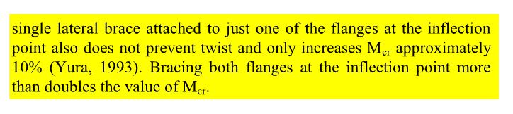

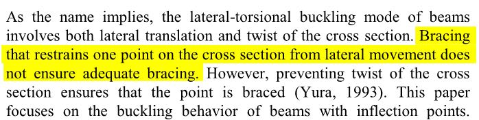

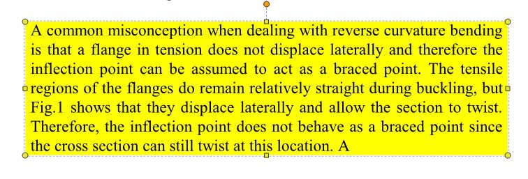

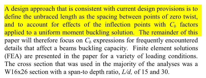

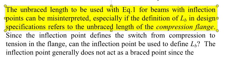

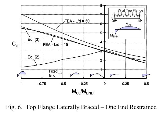

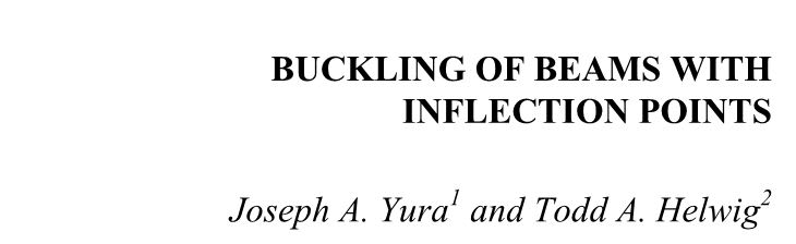

Agreed. As a next step, when you have some free time, please review the attached article by Yura. You'll find that it agrees with my stance. And that's no accident given that much of my understanding of LTB has come from reading Yura's other works. So it's a bit incestuous in that way. Still, if you digest that article and still find yourself not agreeing with my position on this, please report back so that we might reconcile our respective opinions. Who knows, perhaps all this time while I've been claiming that you've been misinterpreting your code, I've actually been misinterpreting Yura.
I've included some samples of the article below to whet your appetite for more. Among other things, they suggest the use of Cb = 1.14 as a simple way to deal with most every practical inflection point beam bracing situation out there. Good stuff. Also, while much of the article deals with designers inappropriately using IP's as brace points, the article really is about a great deal more than that. Namely, the bracing and buckling of beams with moment reversals in general.

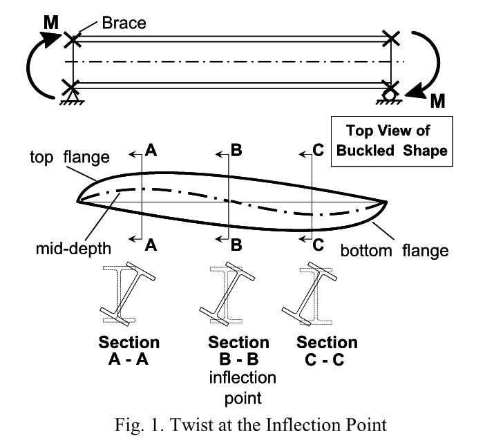

Concept #1: assume IP points represent full LTB brace points. False because the cross section can rotate about the shear center at such points.
Concept #2: assume lateral braces just beyond IP points represent full LTB brace points. False because the cross section can rotate about the lateral braces at such points.
#2 is obviously an improvement in that any capacity short coming will be lessened. It appears to be very much the same conceptual misunderstanding however.

Interestingly, you'll find that Yura tackles the exact same scenario that Agent's blog post does. A salient takeaway from that example is that a lateral brace placed at the IP also does little to restrain LTB. More precisely, LTB is greatly improved for rotation about a point above the shear center and improved about 10% for rotation about a point below the shear center.

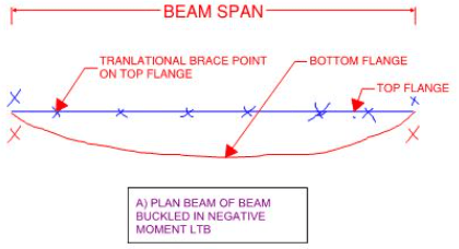

Hey Kookt,
We are back on this topic again. Which I see as a good thing as I believe there is plenty of misunderstand around. And certainly a bunch of learning for me needed. From what I can see you have are fairly on top of things, but I do have one question about one of your statements. (And I believe you made a statement of similar effect in the last thread on a simlar topic.)
Re critical flanges:
Kookt said:
a) that is the flange that moves the most during bucking (constrained axis buckling about the top flange) and, practically, is the only flange capable of moving here and;
The latter part of "practically, is the only flange capable of moving here" seems to assume the top flange is restrained which goes against the definition:
"The critical flange at any cross-section is the flange which in the absence of any restraint at that section would deflect the farther during buckling.
Your statement seems to mistinterpret the code and is a little bit recursive if you determine the critical flange in the context of existing restraints. Could you possibly elaborate? Am I just misinterpretting your statement. Thanks in advance.

In my opinion they are fundamentally different. An inflection point provides no actual physical lateral restraint. A lateral restraint however - whilst not providing twist restraint - nonetheless significantly inhibits the lateral component of the lateral torsional buckle. It is harder for the beam to buckle. The beam can non longer just kick out sideways.
I don't agree with that either. It inhibits the overall lateral component of the buckle, and forces the beam into a more difficult buckling mode. Run some buckling analyses....

I agree that inflection point and brace point are two very different concepts. Though they have been (historically) mixed together in the past. I think the current codes have them pretty separate. However, in the thinking of many engineers they're similar.... Not because of first principles, but because of past design practice.
Now, we're probably getting to the point where engineers who were educated in the mid 80's or earlier may no longer be practicing. However, there are LOTS of people who worked under them for years that still conflate the two concepts. Again, not because of first principles, but because they learned under people who mixed the two concepts together.
Also, when the code calls the variable the "unbraced length of compression flange", there is an obvious reason why folks would mix the two concepts. Because the terminology suggests that when the flange ceases to be in compression, then it may not contribute to the unbraced length. Now, that's merely a terminology issue that doesn't have to do with first principles. But, I can see how that leads to confusion.
What's there to disagree with? Yura did the buckling analysis in the article that I provided and arrived at the conclusion that IP bracing for that example amounted to a paltry, 10% improvement. Perhaps you should run some buckling analyses and report back. So far, this is all just me digging up the quantitative stuff.
It's more than 10%. But put that aside for one second - Jura says it's not effective to laterally brace a flange without providing twist restraint. He (and you) say you can only count points of twist restraint. If that's true, then AS4100 is wrong to allow lateral bracing (without twist restraint) of any flange, regardless of whether it's the critical flange. The question of which flange is the critical flange is surely a moot point if a lateral (pin) brace alone fixed to a flange is assumed to provide no reduction of effective length?

Joe Yura (if I remember correctly) wrote in the notes, a good explanation for why the "rule of thumb" of using the point of inflection hadn't been a problem in the past and why some older engineers where so attached to it.
Cb = 1 surely is one reason for the dearth of consequences and dovetails nicely into the stuff in the Yura article suggesting that one could safely cover most any case with Cb = 1.14.

1) When the top flange is restrained laterally, LTB is basically the bottom flange kicking sideways.
2) The bottom flange kicking sideways is substantially resisted by the bottom flange acting as a girt.
3) We assume that the bottom flange is pinned at the ends for girt action. Often, it's not.
4) We assume that the cross section is free to warp at thee ends for girt action. Often it's not.

in summary Yura says this:
Yura said:
The unbraced length that should be utilized in design should be the spacing between points with zero twist.
It seems to agree with your approach
