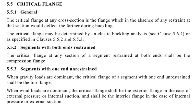

My reading of AS4100 is that you can treat restraints on the compression flange as lateral restraints, which reduces your effective length.
Agent666 said:
I concur, this is the intent of the 'L' restraint, provided you are preventing via external means deflection of the critical flange. It can rotate, but no lateral deflection of the flange.
I believe that you're both incorrect in that interpretation on the basis that the bottom flange is the critical flange and therefor the [L] restraint provided by the floor joist is not efficient in restraining negative moment LTB (lateral torsional buckling).
Tomfh said:
What I find a bit murky...Is that the intent you think? Is it saying that in such a location you can happily restrain either top or bottom and achieve an L restraint.
3) I don't believe that is the intent.
4) Regardless of the intent, I'm confident that interpretation is out of step with fundamental, LTB stability principles.
5) I think that I can de-murkify this by adding some custom commentary to the AS4100 provisions based on the fundamentals. Next post.

AS4100 says we may take the compression flange as the critical flange, which is suspect is the codes way of recognising that floors etc do indeed provide reliable resistance against buckling.
So the argument here is down to whether the top flange may be considered the critical flange in the positive moment region. You and I (and I believe AS4100) are saying yes. kootk is saying no, hence him saying the effective length is 8m

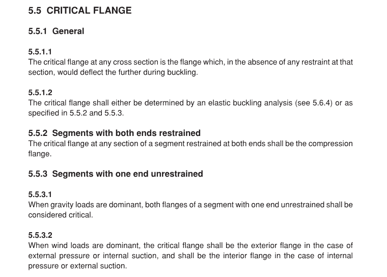

Any chance you could post the NZ3404 definition?
As far as I can tell who cares whats going on between the restraints, the restraint clarification is only based on the location of the restraint.
Having said that the critical flange is strictly defined as the flange which moves the furthest in the absence of the restraint. To determine this for sure you need to do some buckling analyses. So totally impractical for day to day design. But I see where the discrepancy is coming from now.
In terms of applying this for practical design (Keep in mind these provisions are from NZS3404 and the last time I looked at it in another thread a while back there were subtle differences when compared with AS4100), basically for the purposes of defining the critical flange for a segment with restraints at both ends the code says it is simply taken as the compression flange, end of story.
Edit - Commentary clause to go with this
Agent666 said:
To those of you noting the AS4100 definition is a bit wonky, take a look at the definition in NZS3404, it attempts to clarify the non compression flange being the critical flange in some instances.
If anybody would be willing to post snips of either the AU or NZ definitions on this, that would be peachy.
EDIT: my dream has come true...

Yes. And this is generally not the top compression flange in these types of situations. The bottom flange buckles the most within the positive bending zone.
Yet for practical design purposes (no buckling analysis) the code says take the compression (top) flange as the critical flange. This contradicts the “flange which moves furthest” premise.
Thanks for supplying NZ3404. It seems essentially the same?

These codes allows you to take the compression flange as a critical flange (clause 5.5.2), which reduces effective length and thus enhances capacity.
Rational buckling analysis also show significantly enhanced buckling capacity with restraints on the top flange.

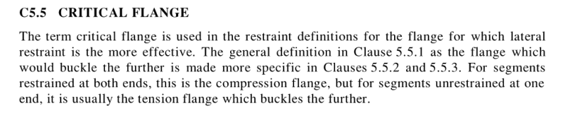

Here are the AS4100 provisions for comparison Kootk:-
The definition of what is the compression flange is simply the flange under compression due to flexure at the location of a restraint.
I.e. nothing in between in terms of the moment distribution matters, nor does axial load (dealt with separately via combined actions checks and the like), the moment distribution is taken care of by the alpha_m factor, similar to Cb factor in AISC.
All the restraints give you as a factoring up or down of the length to give an equivalent effective length over which buckling occurs.
Thanks for posting the 4100 commentary.
It’s strange that it refers to 5.5.2 as being a “more specific” version of 5.5.1, when in reality 5.5.2 contradicts 5.5.1. I’d thought 5.5.2 was an override of 5.5.1 rather than a refinement of 5.5.1
If you follow 5.5.1 then you can’t count a laterally restrained top flange anywhere (which is what kootk is arguing). But if you follow 5.5.2 you can use a laterally restrained top flange when it goes into compression, which is what pretty much everyone does, and what the design packages do.

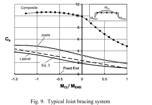

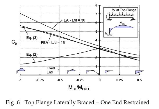

Yes, they do. The graphs below quantify that effect for any interested parties. Cliff notes:
1) EQ2 is the north american version of the moment gradient.
2) EQ3 is a modified version of EQ2 suggested for when inflection points occur within a segment.
3) Fig6 quantifies the improvement associated with having inflection points within a segment.
4) Fig9 quantifies the benefit accrued from the slight rotational restraint supplied by a typical joist seat connection.
So, yes, there absolutely are improvements associated with these things. From my perspective, the question really becomes:
A) Do we qualitatively take these things to simply mean that the buckling mode shown in the last sketch below is impossible/impractical OR;
B) Do we use a Cb based approach to rationally asses the buckling mode shown in the last sketch below?
For me, it's path B without question.

When I look at the Aussie steel code on LTB, this is what I see:
1) Code provisions that do a good deal more designer spoon feeding than you see in North American codes. Is that good? Bad? Prudent? Insulting?
2) On balance, I would have to say that the spoon feeding is prudent. Structural engineers are notoriously bad at stability because, frankly, the math is well above our comfort zone on average. I've worked with a wide variety of designers in Canada in the US and my experience is that mistakes get made often. And I suspect that an Aussie style spoon feeding would improve that situation a great deal.
3) In my opinion, the Aussie code falls on it's face with respect to exactly this issue: beams with inflection points. Good for simple spans; uncommonly good for cantilevers; misleading for for beams with moment reversals. The trouble with spoon feeding is that it's near impossible to make it perfectly applicable to all situations. It is, after all, an attempt to make a very complex thing simpler than it really is.
So here's my my dream:
4) I convince you guys that my way is the right way from a purely theoretical standpoint. Maybe I pull that off and maybe I don't. I feel that my odds are pretty good if you guys give me some room to run and make of point of being flexible. And, if I can't convince you guys, that will be appropriate vetting to prevent me from pursuing what would come next.
5) We attempt a rewrite of the Aussie LTB provisions to sort this out. I expect this will be quite a challenge given that a) some smart cookies obviously composed the original and b) it would require great linguistic precision and the ability to anticipate the ways in which things may be misinterpreted by designers.
6) We put our proposed rewrite in front of the Aussie steel code steering committee, whomever the heck they be.
7) For the rest of our days, we vaingloriously point to the Aussie LTB provisions and say "hell yeah, we're the dudettes that got that written properly".
