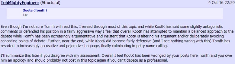

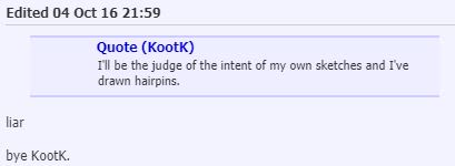

6) It kinda feels as though we're heading back into this territory again, as shown below: Link.
7) If you don't value my input here, then stop engaging with me. I'm happy to continue the conversation with only those who would wish to continue it with me.
