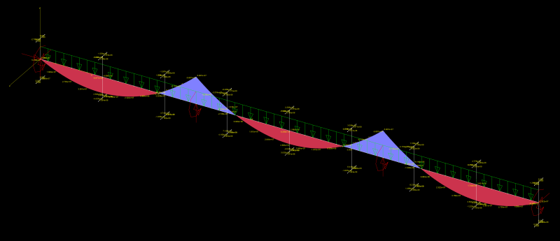

I am designing rafters to AS4100 and wondering what if I don't use fly brace. I understand that with fly brace it will give you full restraint. But if I don't use fly brace, will the purlin above be considered as lateral restraint for rafter under uplift? If so. can I take the purlin spacing as segment and the only factor that changes without fly brace is kt?
I have the same question when it comes the continuous steel floor beam design where Z/C floor joints sit on top of the beam. What segment should I take for the beam near the support? Can I take the floor joists spacing as segment with lateral restraint? Can anyone give me some examples? I have read some manuals but the examples they have are simply supported beams only. Thank you.
Tomfh, no worries. Because as far as applying the standards provisions go, that's exactly what it says to do (rightly or wrongly). Theory is one thing, designing a beam in 4 minutes is another even if not theoretically correct, it will in all likelihood be conservative when you review the brutal curve fitting that went on in the alpha_s factor compared to real world beam behaviour. I used to have a book that had the derivation in it but for the life of me cannot find it again.
Which post exactly from human909 are we referring to here, so I can go back and review further to make sure I'm not missing the point and interpreting things the same or different to you? Given I don't know the moment diagram it can be harder to interpret his 3D printouts, also if I'm reading things right its not a elastic critical buckling analysis, more of an FEM thing, so need to explicitly model or allow for 2nd order effects (residual stresses, initial imperfections, plasticity). If you model these then you should get a similar answer to taking the results of the elastic critical buckling analysis and applying 5.6.4. Least thats the takeaway I took away from working through the mastan2 stability fun modules where they had some full FEM results from ADINA or something like that (from memory). Humans posted a nice picture but not 100% sure how he got to that point. I'm sure he can elaborate to add creedence to his analysis.
But I never recall seeing in any buckling analyses at a particular cross section the tension flange moving further than the compression flange (but to be fair never paid too much attention as not something that is important as you just want the reference buckling moment so you can apply CL5.6.4 requirements for real design). So it may happen, I'd have to go back and fish some old analyses out to see if I see this or not.
If you think you have a situation that warrants a buckling analysis, then you always have the option of doing a buckling analysis in AS/NZ standards.

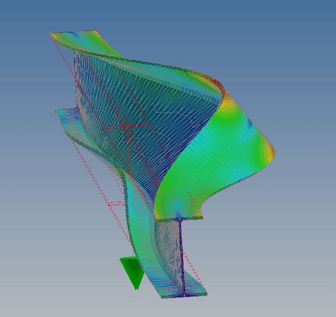

I tried to give a description with my buckling analysis. The moment diagrams are pretty simple to work out from the description. But even without any buckling analysis it is pretty clear that the compression flange isn't always the critical flange.
-As been previously discussed in most cases of a beam with restrained at both ends, the first mode of buckling will be full beam length with the top flange moving the furthest.
-A continuous beam or a beam that has fixed ends will have moment reversal.
-Thus the flange that moves the most won't always be the compression flange.

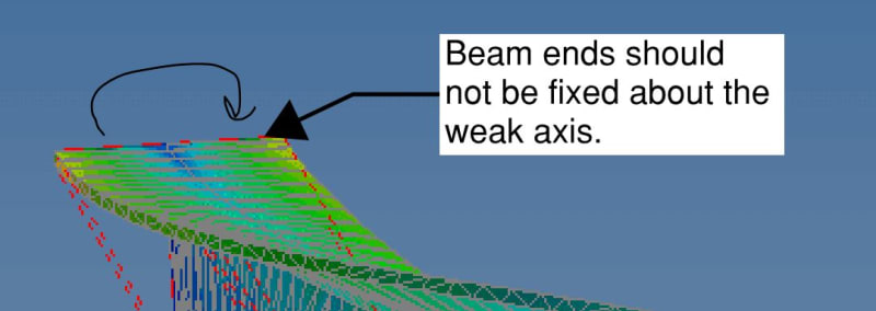

I though I added all the description necessary to aid this discussion but feel free to ask if you want.
eg
8m long 250UB31, fixed ends and centrally loaded. So a nice triangula moment curve with plenty of the beam having bottom flange compression. But the top flange is deflecting the most in the absence of restrains.
Human909:
With the absence of restraint in your model isn't the top flange deflecting the most in the region of the beam for which it is the compression flange? Also illustrating the point that an inflection point doesn't act as bracing.
Open Source Structural Applications:
It’s a continuous beam so the top flange is in tension near the ends.
According to buckling analysis the top flange near the ends is critical flange.
According to compression flange definition the bottom flange near the ends is critical flange (how most people and most software designs in practice).

I don't get why you are saying the flange axial force is at a maximum at the beam ends, when the moment is zero... but forgetting about that inconsistency for a bit:-I see what you did, it's a blowup of the middle span! Looking comprehension....
If I do a buckling analysis for a scenario like this, I get the top compression flange buckling the furthest at midspan where you proposed the L restraint. So I'm just never seeing this effect you are noting at that mid point of the middle span that the tension flange is buckling the furthest like you're stating/proposing?
But I am seeing in the negative moment region that the top flange in tension is moving further than the compression flange, which I assume is the point you're getting at? So in effect if you had an L restraint to the top flange in this region it is restraining the flange that appears to be moving the furthest (even though it was the tension flange).
But on a segment basis, the compression flange always is the one that goes the furthest overall.
Keep in mind for practical design you'd almost always be putting a restraint out in the middle somewhere where the compression flange is the one trying to go the furthest to get your best bang for buck in terms of equalising the effective lengths either side of a restraint location. Or alternatively aim to restraint the flange at the point where it wants to go the furthest
F restraints interpreted/applied to prevent lateral translation and twist of the cross section.
Refer screenshot below of the mom.ent, and displaced shape. I-sections added for visualising the twist and which flange moves the furthest. Click the link to download the full resolution image as hard to see details otherwise.

What I meant for clarification:-
For the middle span/segment in my images, of all the infinite number of cross sections making up that particular span/segment, the compression flange moves the furthest right at the middle in that segment. So on a segment by segment basis the compression flange always seems to move the furthest (based on a limited number of runs this morning playing around with it + previous experience on real world scenarios).
I didn't read any of his simply supported beam images like you did? Compression flange seemed to go the furthest? Please take his image and markup where you are specifically referencing so I'm interpreting your opinion correctly.
