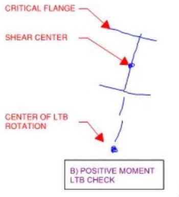

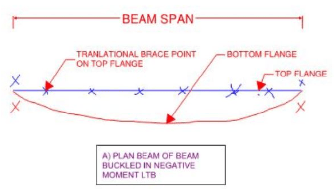

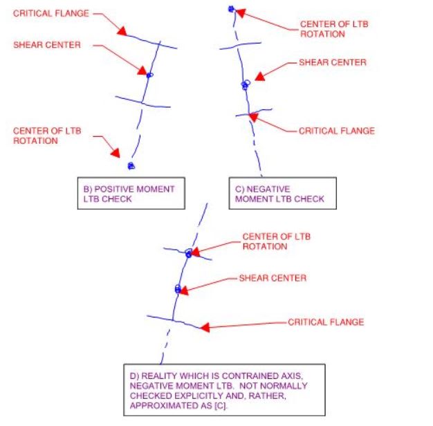

To recap, mode two is shown below and is what I have been referring to as constrained axis buckling. And it would indeed have a substantial capacity; I don't dispute that.
In my opinion, one cannot approach any LTB assessment without first having a buckling mode in mind to assess. For OP's problem, and for my W27x84 test case, the buckling mode shown below is the one that I believe is critical and the one that I would mean to assess, either via constrained axis buckling or, far more commonly, by running a negative moment LTB check on a beam with no intermediate restraints as Celt83 did in his analysis. This is what is commonly taken to be the AISC approach and I acknowledge it as a lower bound solution rather than an especially accurate one.

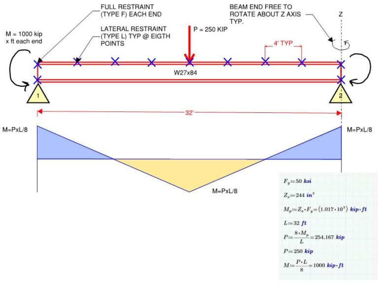

@ Human909 & steveh49. My question to you both is this: when you check LTB for the something like the W27x84 test case via AS4100, what IS the mode of buckling that you feel you are checking? Seriously. Ideally, I would have you each post a sketch similar to mine showing the expected movements of both flanges in plan. If that's not in the cards, please provide a verbal description. I'll attempt to translate any such descriptions into sketches for your approval.
This may seem trivial to the point that you wonder whether or not I'm attempting to poke fun at you. I assure your that I am not. We seem to have a fundamental disagreement here on what I consider to be the root starting point for LTB checking. Once I understand the source of this discrepancy, I may gain an important new insight into the inner workings of AS4100 which, presently, I find baffling.
Thanks very much, Agent.
So the AS4100 hand method gives alpha_m * alpha_s * phi.Ms = 2009 kNm using Human909's Space Gass numbers from 14 Nov, but the elastic buckling analysis gives about 1240 kNm. 62% unconservative it seems.
Compared to Celt83's AISC capacity, 719 kNm/1240 kNm = 59%. AISC seems quite conservative. If the Cb factor were 3.31, AISC would give the same as the AS4100 elastic buckling method used by Agent666. This is right in the range suggested by Yura (probably a similar method as used by Agent666).
In practice, it would seem that the AISC requirement to restrain both flanges near an inflection point has a lot going for it.

Buckled shape for the test case: I'd have guessed similar to your sketch but straighter in the middle where the bottom flange is in tension. You were drawing a sine wave? (Which is pretty straight towards the middle, but I think straighter still.) Cheating by looking at Agent's pictures, it looks as though the load at midspan is stabilising that point which makes sense to me as the section must rotate about the restrained top flange so the shear centre load tries to restore the section to upright.
As above you seem fixated on the notion that a codified buckling check needs to focus on ONE buckling mode. That is a bit inefficient really. A check that covers ALL buckling modes is more efficient, if such a beast is achievable. Thus a drawing like what you want is impossible.
AS4100 sets a threshold where if it is doing its job properly NONE of the buckling modes will occur.
I'd not really gotten into that level of detail as to whether it was a sine wave or had a flattish spot. It definitely does have a flattish spot as Yura touched upon.
Your answer surprises me though in comparison to the comments of others. Based on your desicription it sounds as though you see the critical buckling mode being checked as being the constrained axis model that I've described. Human909 and Tomfh have both made statements suggesting that model is not the critical buckling mode being LTB checked in the AS4100 procedure.
steveh49 said:
So the AS4100 hand method gives alpha_m * alpha_s * phi.Ms = 2009 kNm using Human909's Space Gass numbers from 14 Nov, but the elastic buckling analysis gives about 1240 kNm 62% unconservative it seems.
Sorry. What? How do you figure this?

This is the part that strikes me as being hugely in error. Of course I'm focused on the bottom flange bucking mode. Given that the top flange is effectively continuously braced, there is no possibility of top flange buckling. So, in practical terms, is bottom flange buckling not the only mode of buckling in play here?
A challenge for you Human909: sketch me a single bucking mode that would be further up the list in terms of its eigenvalue and could possibly occur in the presence of the lateral restraints. Just one.

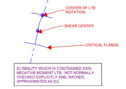

Yes! So consider:
1) In North America, being the ignoramuses that we are, we have an LTB checking procedure that checks just one lousy buckling mode at a time. We're the Homer Simpsons of LTB.
2) In AU, apparently, you've devised an LTB checking procedure mode that somehow checks ALL buckling modes simultaneously. This is a pretty good trick.
Given this, just imagine how magical the AS4100 procedure seems to North American eyes? Just imagine how badly we'd like to know how this magical procedure works??
But alas, so far no one has explained how it works so magically. And that is why I keep asking questions targeted at finding out. Once I understand this piece of the puzzle, I suspect that most of the rest will just fall into place.
Given that your a practitioner of this incredible, all in one, LTB checking method, do you yourself not feel an onus of responsibility to understand how it manages to check all possible buckling modes in one go?
Don't get me wrong, my issue here is not that I question whether or not AS4100 LTB works. My issue is that I don't understand how it works and, frankly, my impression thus far is that I am far from being alone in my ignorance. If you strip out my contributions, this thread reads something like:

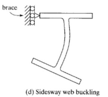

HS_PA_EIT said:
For the bottom flange to buckle, the web must fail
I disagree.
One way for the flange to buckle would certainly be for the web to fail in transverse flexure. And this sort of resembles a reaction / concentrated load phenomenon that we call web sidesway buckling in the North American parlance (first sketch below). Back in the spring of 2018, WARose and I hammered out what I suspect still stands as the definitive Rumble in the Jungle on that topic if you're curious to learn more: Link. In my opinion, it's next to impossible to generate this failure mode away from concentrated loads and reactions however.
Another, more likely, failure mode is shown in the second sketch below and taken from early on in this discussion. And it does not involve the failure of the web. About the same time that I first posted that sketch, I was describing LTB as:
KootK paraphrase said:
..rotation about a point in space above, below, or at the elevation of the shear center an horizontally in line with the shear center
I made a point of using that particular phrasing because I believe that it is the only, wholly accurate what to describe the physical phenomenon of lateral torsional buckling. That said, one can only repeat such a mouthful of jargon so many times before wanting to claw out their own larynx. So now I'm just using the more colloquial "bottom/top flange buckling" which seems to do a much better job of speaking to people's intuitions. It is important to recognize that there is a difference however.
In my next post, I'm going to do something nifty and related as it pertains to some of steveh49's previous work. It will also bear some similarity to celt83's previous work on flange buckling which has since been retracted. Stay tuned.

For determining the critical flange, don't you have to consider the "section" in the absence of any restraint for AS4100?
As you ponder my statement, it is absolutely crucial that you think only in terms of what you feel will actually happen, physically, in real life. No code talk. Once you start putting it into the context of AS4100 (or AISC), everything gets irrevocably muddied by:
1) Your assumption that your code is correct and;
2) Your assumption that your interpretation of your code is correct.
Those two things probably are correct. However, using them as a crutch form of theoretical evidence to prevents us from discussing the theory in a meaningful way. I've been battling exactly this effect for the better part of a month now.
HS_PA_EIT said:
I would think that because of this definition, either flange is in play
For physical, real world buckling, the top flange is out of play by definition as it is laterally restrained at such close intervals as to be continuously restrained. Ask yourself this: could the LTB buckling mode shown below physically occur with the top flange prevented from displacing laterally? If it can't, then top flange buckling has to be off of the table and the constrained axis LTB buckling would become critical.
A big part of what I'm striving to understand myself is how it can possibly make sense to make all of your LTB design decisions assuming an unrestrained system when, in fact, the actual, critical buckling mode will be anything but unrestrained. It would appear to be related to Human909's assertion that the AS4100 LTB checks actually preclude all relevant buckling modes as apposed to a particular mode.
