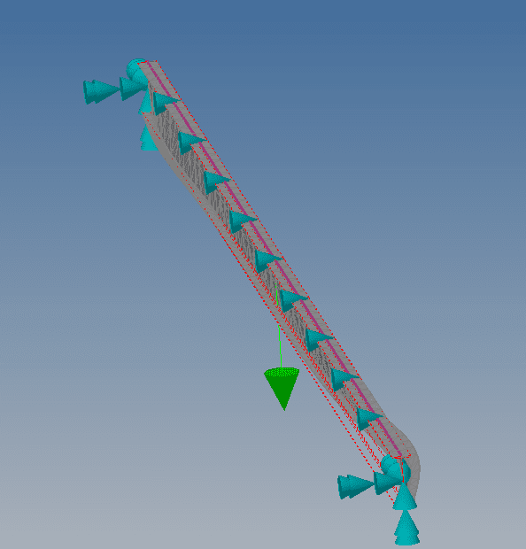

My end restraints on the previous model was on the two edges of the web which did give some degree of stiffness in the minor plane. I re-ran the model with no stiffness in the minor plane and got 1845kN Picture below.
(Though having completely restrained in the major axis and completely pinned in the minor axis is a unusual connection!)
Beam restraint viewed from below.
-Full translational restaint Rotationally restrained in the major axis, rotationally unrestrained in the minor axis.
-Lateral restrains on top falnge as described by Kootk

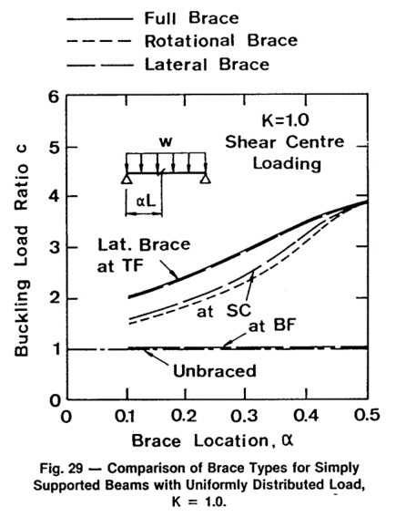

See the graph I posted 23 Nov 14:27 which shows a case where the L restraint does the job of an F restraint and is better than a twist restraint.
What is that graph based on?
It doesn’t agree with Mastan analyses above, and isn’t very intuitive. I’m not sure how an L can really be as good as F in reality, or how L on non critical flange can do literally nothing...

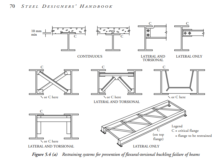

I would like to define the braces again becasue I think that is important:
F-brace: Lateral deflection and twist are prevented.
P-brace: Lateral deflection of the tension flange is prevented. Twist can occur (i.e. the compression flange can move relative to the top flange)
L-brace: Lateral deflection of the compression flange is prevented
U - Unrestrained: No restraint.
To prevent lateral-torsional buckling you either need to prevent deflection of the compression flange or prevent the rotation of the flanges (i.e. both flanges can translate laterally but cannot rotate).

RFreund, your definitions are off a little, especially in the restraint of twist department for F/P types. Bang on for L/U types though.
Best to see below regarding F/P restraints rather than me trying to re-hash it in my own words.

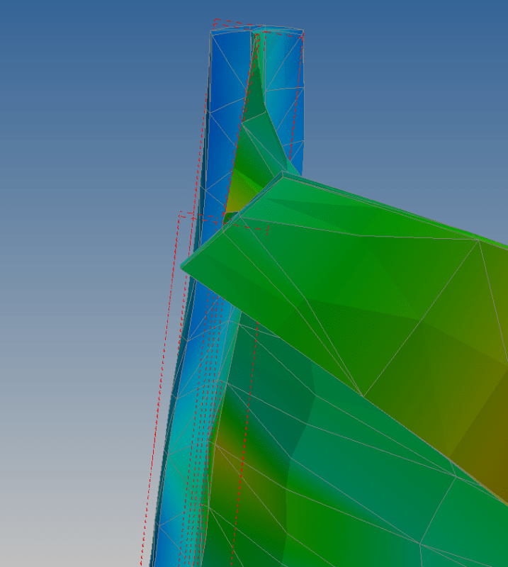

I find human909's latest buckling shape image interesting as it appears to match the AS4100 assumption: the bottom flange is only moving near the beam ends where it is in compression and the top flange restraints are ineffective at restraining the bottom flange. It looks straight and along its original alignment in the middle of the beam where it is in tension. The top flange L restraints are acting as F restraints. But this is very different to the Mastan buckled shapes and key to the AS4100 'magic' being correct for moment reversal within segment.
Mastan and Human909's stuff are both just FEM models. One way or another, they have to be made to agree. In my mind, the differences between software models cannot stand as the "key" to explaining the AS4100 magic. Three things about Human909's model catch my eye and, hopefully, he can speak to them:
1) If I understand the symbology correctly, there is still some degree of weak axis rotational restraint at the beam ends.
2) The bottom flanges buckle in opposite directions. That S-shape suggests that this is something other than first mode behavior. This may be related to my next point.
3) Graphically, it appears that the load may have been applied at a point lower on the cross section than the top flange.

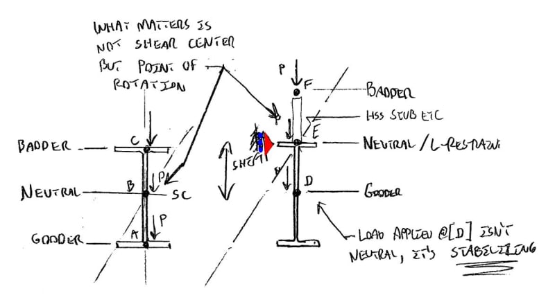

But I now agree that top flange loading at a top flange L restraint should use K_l>1.0 if the bottom flange is going to move sideways.
That's too bad because I've since changed my mind and rescind my concern. This is neat... and cleaner than most things here. Start with a full read of the attached sketch.
Yesterday, you asked for the W27x84 with a single L-restraint at mid-span to be modeled. I did that and thought to myself "Great, I'll run this same model with the load at the shear center and the load at the top flange. The top flange loaded model will buckle earlier and this will support my position that k_l should be greater than unity for that." I did this exercise and the results were just as I expected: capacity is less with the load at the top flange than it is with the load at the shear center. Unfortunately, this was never the right question to ask so the answer was meaningless.
The right question to ask is really this: of the various vertical positions available for the load, which one represents neutral stability? That, because the LTB capacities are calibrated to the neutral stability condition. And the neutral stability position is not, strictly speaking, the beam shear center. Rather, it is the center of rotation for the critical LTB buckling mode. Once the mid-span L-brace is added, that center of rotation becomes the top flange and, therefore, the top flange becomes the neutral load position. Everything shifts up as shown below. As a way to "feel" this, imagine the load applied at point [D} in the sketch below, with the top flange L-restraint in play. Obviously, in this position, the load is actually stabilizing rather than just neutral.
Neat huh? In a way, this dovetails into your hypothesis that, in many cases, L-restraints are effectively F-restraints. It is, after-all, acknowledged by all that the destabilizing effect of a load in a destabilizing position ends at the nearest F-restraint where it gets absorbed into the bracing.
No. In the last picture showed there is none.
That was the first mode with the seecond buckling in the opposite S shape. Full mode buckling doesn't have to be full lenght. I'll go back an grab pictures of a bunch of modes if that will help.
Loaded on the top flange directly above the web.
I don’t believe it. I’m perplexed by the suggestion (and the graph) that L restraints are as good as F restraint.
It’s one thing to treat L as the same for design purposes, but really and truly just as good?
When a beam buckles the cross sections move and rotate. So how can a pin do the same thing as full restraint?
Question for everyone: Why do the Mastan models predict Kootk's bottom flange buckle, but human's FEM model (and the graphs) predict localised buckling between lateral restraints?
