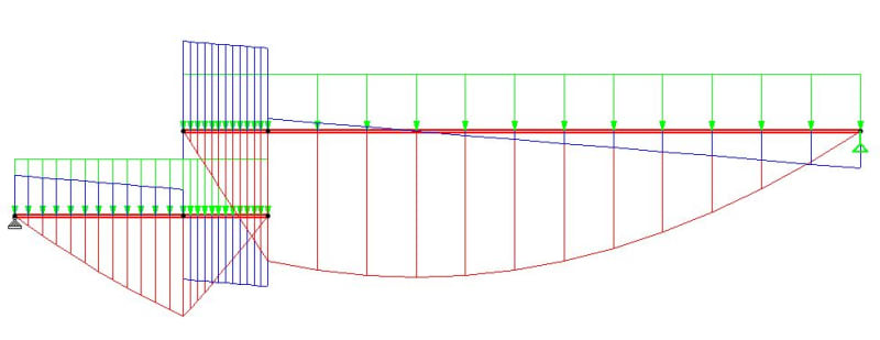

Yes, they are corresponding to the same loading scheme. Something "suspicious"? Here is the sketch with everything: load, shear, and moment (for clarity beams are shown further apart).

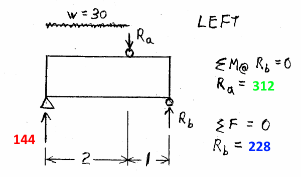

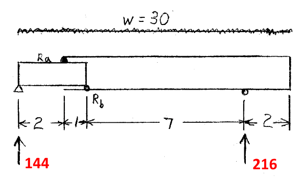

Here is a simple statics exact solution for the forces at Ra and Rb, and I have added a cantilever:
1) Since forces at Ra and Rb are internal, the "assembled" mechanism is a simple beam with an overhang:
2) Calculate the forces at the supports (Results: 144 and 216).
3) "Disassemble" the beam and consider only the left portion. Sum moments to calculate Ra = 312. Sum forces to calculate Rb = 228.

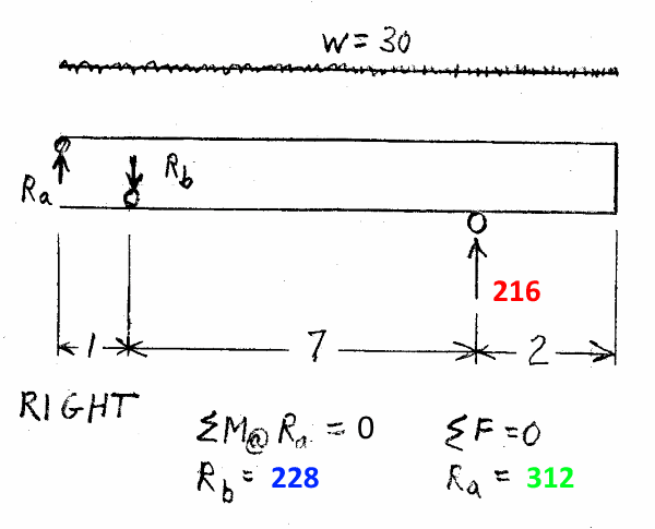

4) As a check, consider only the right portion of the beam. Sum moments to calculate Rb = 228. Sum forces to calculate Ra = 312.
5) "Reassemble" beam, note the following:
Forces at Ra and Rb on the two parts of the beam cancel each other (as they should).​
Both of the rollers at Ra and Rb are in compression (as they should be).​
Note: This is a mechanical engineering machine design approach to the problem.

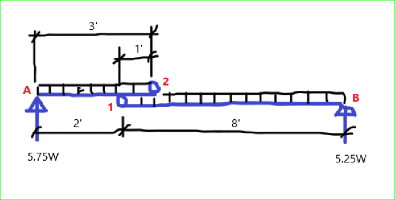

You need to understand the problem correctly and draw the structure, loading and supports correctly as well. The diagram that you presented does not represent original question.
The structure on the wheeled support (right end support) is almost balanced by the loads on both sides. One side on this structure attached on the other by upper and lover rollers (A and B) which provide sliding. Other structure is cantilever with moment connection on left end support. Both structures are connected with sliding support (roller A and B). Therefore the system is stable for this reason.
When right end moves the system slides the bending moment changes on the left end support.
Hope this clarifies everything.
