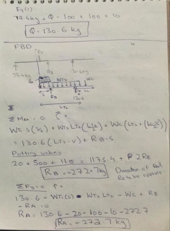

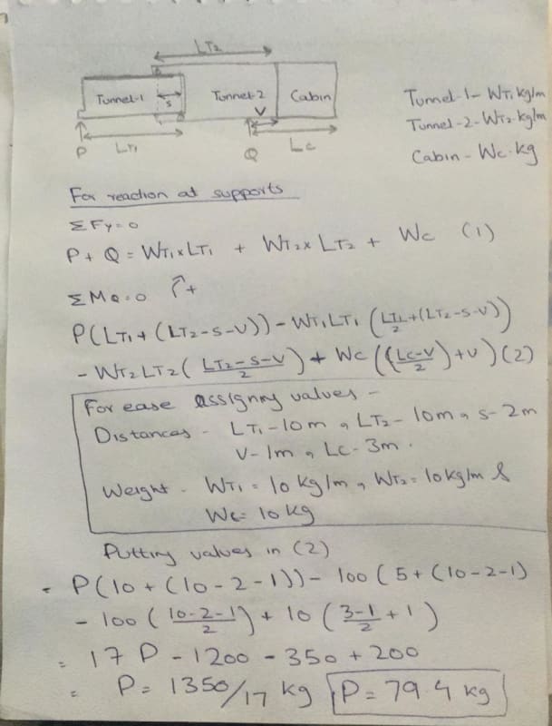

I tried to solve it considering it to be a jetway bridge.
Good for you, adjel. That is what I call perseverance, an admirable quality.
EDIT: But wait a minute. You found RA and RB to be equal? That doesn't sound right. Have you checked your calcs?

Are the following solution correct?
1) If place a force, F, in the center, each support has R = F/3.
2) If place F on one of the knife, then its support R = F/2, and the remaining supports have R = F/4.

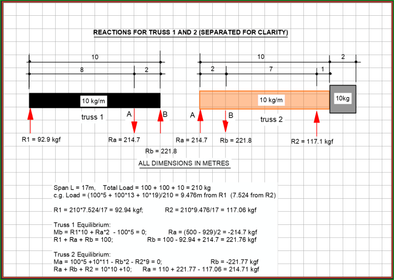

Please see below for truss reactions for dimensions proposed by adjel. Note that Ra and Rb are in opposite directions for each truss (action and reaction).
BA
damn ! don't you hate making a mistake on line 2 (of a long calc) !
Retired,
thanks for the correction. By the way I was looking at your solution, how did you calculate the span length?
rb is correct. See the correction below, if that's your question.
Retired13 thanks, but i was referring to retired own problem solution wherespan lenght was calculated 17
Seems you were asking BA, rather than R13, both are "retired" :)
8+2+7 = 17 between supports. Note that the over lap is 2, that should be added one time only.

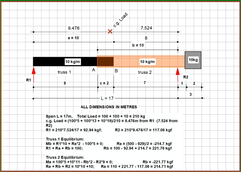

I'm not sure if you were asking retired13 or myself, but I thought the span between supports on your sketch was 17'. Was I mistaken? Please see below.
EDIT: Sorry, that was the wrong image. I'll try to find the correct one.
BA
Yes. I suggest to have a clean "uninstall" using windows' utility "Add and Remove Programs" (do not use any other method, even the "uninstall" came with the software), which can be found by type the phase in the search bar at the bottom left of your screen (Type here to search), next to the window icon. It uninstall the program and re-write the registry, then the problem wouldn't be carried over to the next installation. How you attach the dynamic file to E-T? Very interesting.
BA,
For got to mention, after the uninstall, before download the new version, I think you need to shut down the pc then restart to make sure the registry has been completely cleaned.
adjel,
The dimensions below are the ones I used. Please let me know if they are incorrect.
BA
