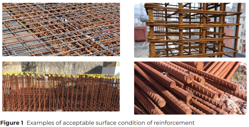

Agree with Littleinch, I don't see any issue based off the pictures. Looks like normal, unharmful rebar corrosion to me.
I've seen much rustier reinforcement than this on job sites before. Unless it's beginning to flake, I don't think it's a problem.

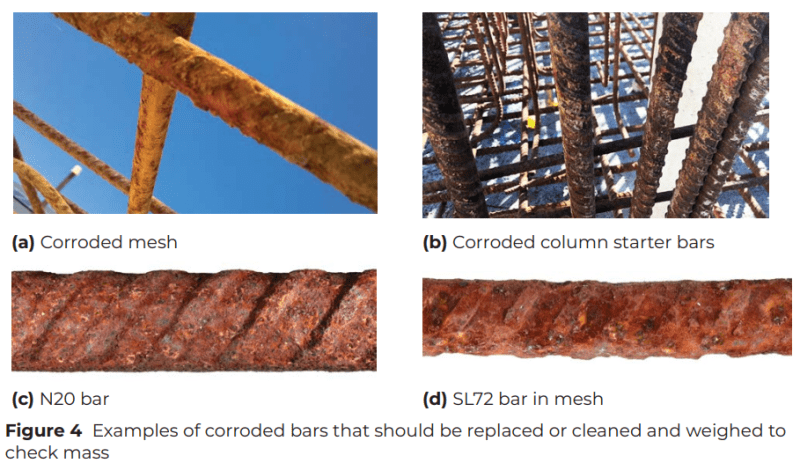

The following is a good guide I think:
A few snapshots from that guide below...

The correct judgement is that surface corrosion on the magnitude of Bugbus' figure #1 is not detrimental, even in bridge structures and bridge decks. Only if it compares to Figure 4 should you consider cleaning.
Since the rebar has already been placed, there is no economical silver bullet to remove rust. Anything powerful enough to clean bars will tear right through your forms. So you're either looking to strip and replace the forms (somehow shoring and bracing the rebar cage to allow that to stay in place during cleaning), or taking down the bar for processing at ground level. And if you're going to take down the bar to clean it, you had might as well just scrap the bar and replace it all with new rebar.
Alternatively, take measurements of some representative bar weights to determine section loss to date, extrapolate with section loss projections over time (using dik's data until concrete will be placed, then a reduced rate after that), and evaluate how much rebar section will be left at the end of the bridge service life. Run analysis using reduced bar section properties, and determine whether the section loss over time will be acceptable.
If not loose rust, then just leave it as it is...

I would remove flaking rust and suchlike by wire brushing and be less concerned about the rest.

3DD... as noted... removal of the rust, if it's tight, may not be beneficial...
dik - as noted, if rust is flaking, it should be removed.

We build things outside in time periods measured in more than milliseconds so of course steel rusts. It has rusted ever since we started using reinforcing steel in concrete. It will continue to rust just as it always has. This is a non-problem.
