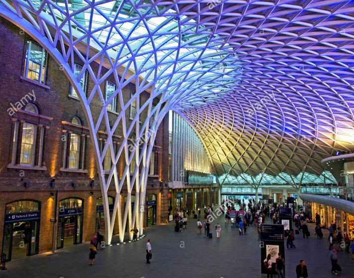

Reminds me of the new entrance at Kings Cross Station, London.

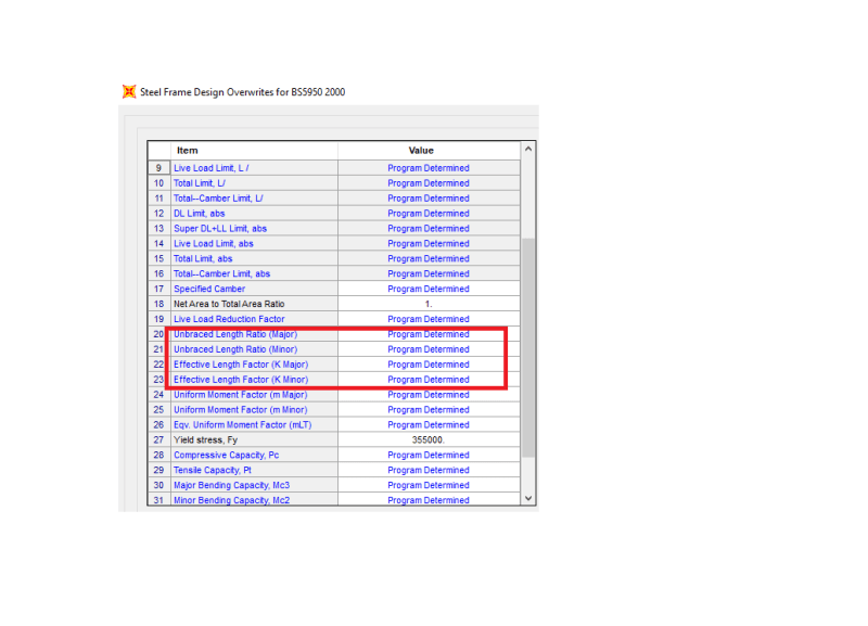

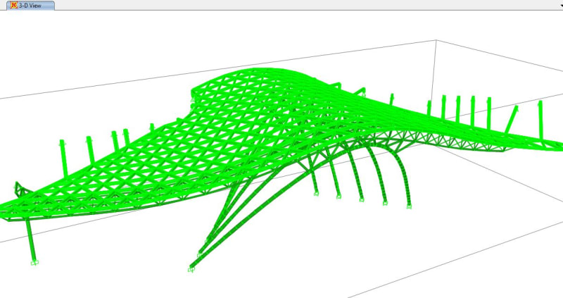

Dear All,
I am doing another single layer frame (latticed) with free form (same as above). In this we have a third party designer for checking our design.
3rd party is modelling our structure in ETABS/SAP000 and they are defining effective length and k factor as programme determined, as in attached image. And running analysis, NO special buckling analysis or second order analysis they are doing.
is this is enough? is SAP2000/ETABS is capable to determine exactly the buckling shape and calculates factors accordingly??
