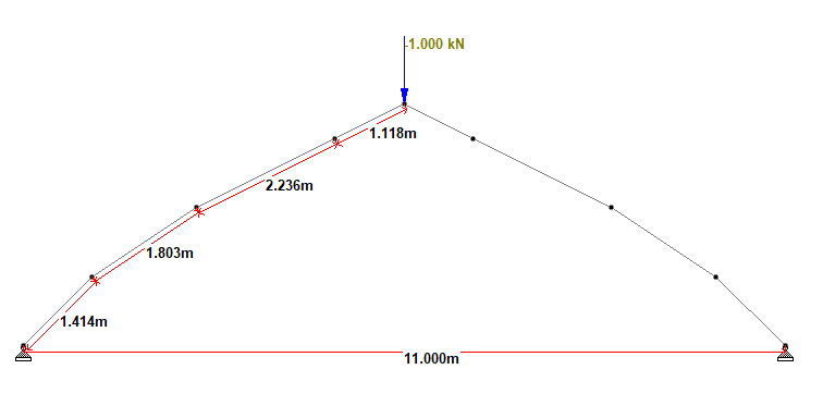

Dear Agent666,
Thank you for your response.
I am trying to follow your above described procedure . For a trail I considered a 11 m arch and applied a dead load of 1 kN at top ridge point. One side I considered 4 members with different lengths as shown in figure. After running buckling analysis I found a factor of 1441.877 and for 1 kN load compression in arch is 0.855 kN.
therefore my buckling load for the arch will be
Pcr = 0.855 x 1441.877 = 1232.8 kN
after this I divided every beam in two parts then I found Pcr = 1231.194 kN
then 4 division per beam Pcr = 1231.055 kN.
After observing Buckling shape it has been found that le = half the length of arch. Le = 6.571 m.
then as per Euler's formula Pcr = Pi^2 x 2.05e5 x 2664e4/(6571)^2 = 1248.31 kN
Now there is approximately difference of 16 kN between theoretical and actual (approximately 1.2 %).

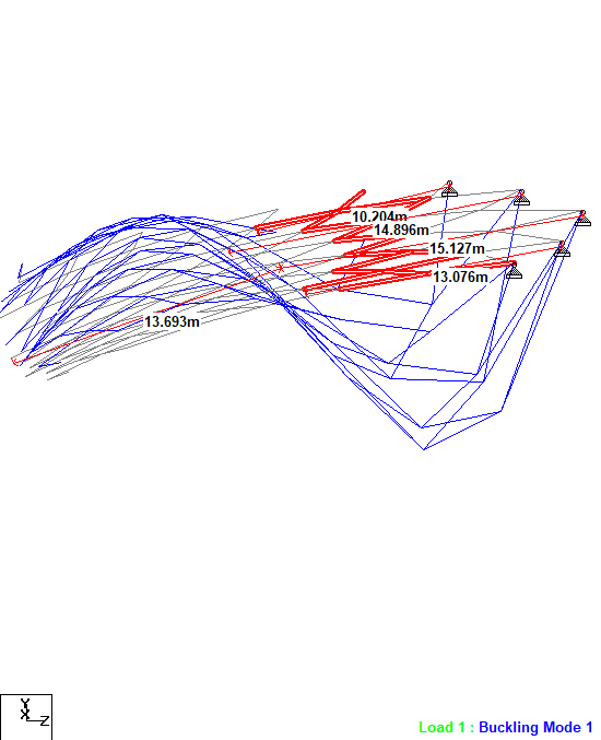

Dear Agent 666,
I tried to follow your above explained procedure. But I stuck as there is difference between your code and AISC 360-10.
Following procedure I followed-
1. I obtained the stiffness coefficient of the top nodes of geodesic as its connecting to space frame.
2. These stiffness's values applied as support springs in STAAD.
3. I did Buckling analysis to get the buckling shape in STAAD pro.
4. By observing the buckling shape (below image- Part of geodesic) it can be seen that approximately 9 members are there in buckling of selected part of geodesic. Each pipe size is 139x6 mm hollow circular section with A_g = 2525 mm^2 and I_z = 5640000 mm^4
5. Taking this portion as a group of members and taking the average length of buckling approximately 14 m.
6. Applying Euler's formula to get P_e1 (As per AISC)
= Pi^2 .EI/(kL)^2 = 3.1415^2 x 200000 x 9 x 5640000/(14000)^2 = 511200 N
7. Now for getting modified slender parameter which method/formula I should use. There are factor Cm and B1 and B2 as K factor, first order and second order analysis factor respectively as per Appendix 7 and 8.
I am attaching the appendix of second order analysis also please check and guide me. There is Pr in the equation of Cm but it not squash load, its showing it as axial load.

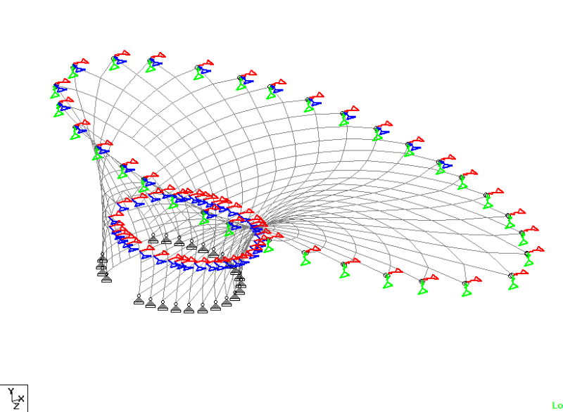

Dear Klaus,
as per your suggestion and my understanding I separated the geodesic structure from the rest of the building for Buckling analysis. I followed below procedure for Global Buckling analysis.
1.separated the Geodesic model (Grid shell).
2. Modelled bottom support as hinge (supported on slab) and top support of space frame with Spring Stiffness (Derived from full Model).
3. Applied loads on geodesic (Acting on it and transferring through space frame both).
4. Added Load combination as repeat load case.
5. Then Run the buckling analysis in STAAD for whole structure of Geodesic.
6. The maximum Buckling factor I got is 4.67 . Which means that- what are the current loads need to increase 4.67 times to buckle the geodesic structure.
7. So in this case as it has been proved in STAAD that the current loads are well within the buckling capacity of geodesic, do Its really need to define effective length in Design parameter?? I think here no need to apply the length factor to check the slenderness as those members are not going to buckle individually.
Please guide. If you have some reference please share.

To aid in your understanding of the concepts forget about your complex model for a while and create some simple models for which you know the answer and follow the code procedures using either an elastic critical buckling loads approach, or a direct analysis method (DAM) approach to show the same capacity.

Arbu, looking through AISC360-16, some comments on applying the provisions in relation to using a critical buckling analysis in lieu of tabulated effective length factors, the K factor in the code:-
The provisions for working out the capacity of a member in compression require you to work out the critical buckling stress, being F_e in equation E3-4. This 'critical buckling stress' is effectively the average stress on a cross section when buckling occurs, it is simply P_cr/A_g, where P_cr is the critical buckling load. This stress is then used in applying the code provisions for determining the buckling load of a 'real' member.
i.e. by applying the code column curve to the column/member/system (this is what eqns E3-2 & E3-3 are doing). You will note in the text for F_e that it notes that F_e can be determined by 'or through a buckling analysis'.
Therefore it stands to reason that when you have the buckling load from a rational buckling analysis that you can use the analysis P_cr/A_g in place of E3-4 equation. Rest of design process is as per normal.
So in summary, how to undertake an analysis using AISC provisions
1. undertake buckling analysis
2. work out Pcr, by taking the buckling analysis load factor and multiplying it by the load in the buckling member.
3. work out F_e = P_cr/A_g
4. proceed as per normal applying eqns E3-2 or E3-3 as required, and finally work out the member buckling force using E3-1
The use of F_e from the analysis embodies the effective length from equation E3-4 (i.e. L_c = KL). There is therefore no need to back calculate or guess lengths like you appear to have been doing. It is simply happening in the background once you have the buckling load from the analysis.
Hopefully this clarifies the process of design by the use of a rational buckling analysis in conjunction with AISC.
Dear Agent666,
Thank you for explaining everything. Seems like it will work, I will try to solve and let you know. Thank you once again.
Dear Agent666,
I tried to follow the procedure u explained above. The steps I followed are mentioned below.
1.Run the buckling analysis of model for load cases and combinations in STAAD model.
2. Out of all load cases and combination the case having least buckling factor has been selected. (Buckling factor = 4.65 for Load 101- 1.4DL in model)
3. Extracted axial forces (for critical load case-101-1.4DL) of members and considered members having Compression only.
4. Multiplied axial compression force of each member by Buckling factor (4.65) to get buckling load in each member P_cr.
5. then calculated F_e = P_cr/A_g
6. Then check F-y/F_e ratio , I found all values greater than 2.25 , that's why my F_cr (as per Eq E3-3) = 0.877 F_e
7. So my buckling capacity will be P = F_cr x A_g
Is this procedure is correct?
So finally I will check the buckling capacity of each member and take the combine check of buckling with moment. right?
I am attaching the Excel of my calculations and STAAD file also please check.
