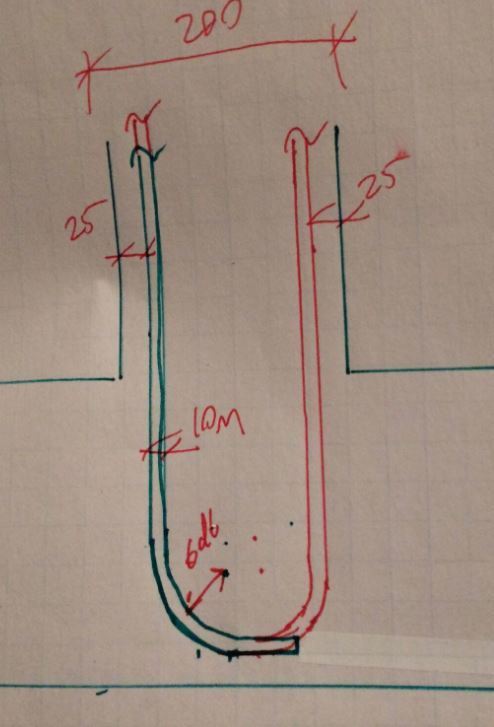

SCALE DRAWING
To help explain away this apparently anomalous results, and preserve the pulley idea, KootK produced a “scale drawing” (4 Oct 16 03:23) of a 180 degree hook superimposed on a very incorrectly drawn 90 degree hook, to show that – despite appearances - a 180 hook in fact provides *superior* lapping to the bottom bars than does a standard 90 degree hook. Hallelulia! That’s why Nilsson’s examples work! A 180 hook touching a horizontal bar is actual a very effective lap, the pulley model is saved.
TROMBONES
Also, to bolster his argument, KootK said he wasn’t even talking about 180 hooks (despite drawing one), he in fact meant trombone hairpin (not that they satisfy Ld + ??? anyway).
And regarding Nilsson’s hairpins, KootK claims that the word “hairpin” in Nilsson’s text proves it is trombones, regardless of what Nilsson has drawn, and regardless that the actual crack pattern traces out an ordinary 180 bend.

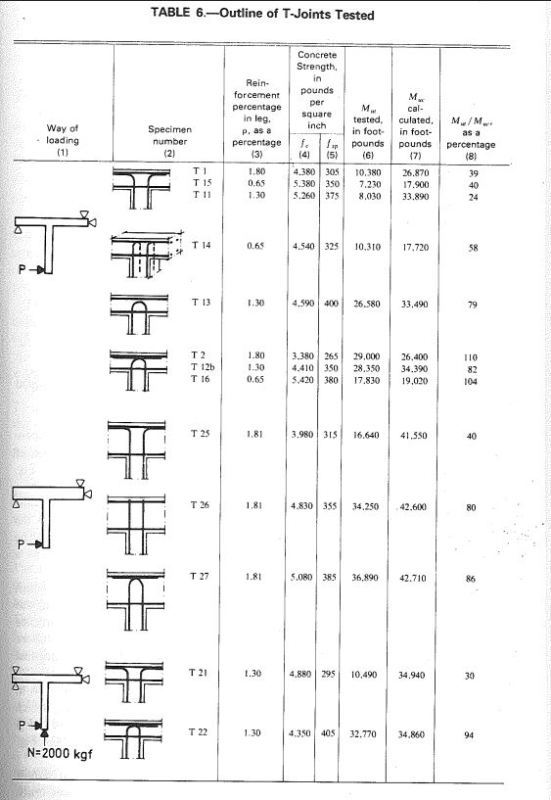

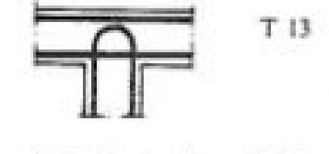

SUMMARY
T13 has negligible lap between vertical and horizontal bars, and T12a has complete bar continuity, and yet – to KootKs surprise - they provide almost identical capacity (79% vs 82%). This contradicts KootKs primary claim that the horizontal bars need a full lap onto the vertical steel in order for the joint to function, and thus undermines the basis of his claim that a standard hook is an abominable detail.

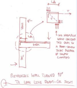

So I get the pulley concept and why that improves the joint. Quick question regarding the hairpin/180 degree hook whatever -
@kootk - your sketch (see below) is the STM explanation for why the hairpin/180 works but not as well due to the reduced "reduced flexural depth". Is that right?
Uhh... In my heart of hearts, I want to just say yes. However, this thread has become hyper sensitive to semantics. So I'll say this instead in the interest of hyper precision:
The STM is an explanation for why a stem bar that is developed vertically within the footing depth, but is not explicitly designed to transfer tension around the corner, will work but with a reduced efficiency which, fundamentally, I believe is a result of that "reduced flexural depth" that I mentioned. In the context of the previous statement, what I mean by developed vertically is one of the following:
1) A developed vertical with no hook
2) A developed vertical with a 90 degree hook.
3) A developed vertical with a 180 degree hook.
4) Perhaps one leg of a trombone style hairpin to the extent that it would function as vertical development for the stem bars.
So, yeah. Yes.

TME said:
Your drawing does appear somewhat continuous in the curve
My green rebar 90 has a definite curve in the corner. My green rebar 90 has a definite straight, horizontal extension. These things are congruous with reality. Where I went wrong is that I measured the end of the hook as 12db from the vertical bar centerline rather from the point of tangency on the curve. So yeah, the straight part is a little short (~60 mm). Hari Kari for me.
TME said:
Further, Nilsson does seem to be showing a continuous curve in his sketches more in line with a 180° hook. While a large enough radius curve seems fundamentally identical to a "hairpin" or "trombone" as you put it, I feel it's worth pointing out that quibbling over the minutia of what is shown is missing the key points of this debate.
It's a small sketch. Maybe it's not drawn in incredibly intricate detail. Maybe it's incorrect of me to interpret the width of the hairpin extending to cover as meaning trombone style. Maybe when Nilsson says hairpin, he actually means 180. Maybe it is a big radius rather than a true "trombone".
- Nilsson said it was a hairpin.
- It looks like a hairpin to me.
- There is nothing that explicitly said that it is a 180.
While my interpretation may indeed not be correct, when you add all of that up, it leads me to believe that my interpretation is at least as valid as anyone else's. Additionally, when I posted my apparently ambiguous sketch, I included text clarify my intent. And then, subsequently, I re-clarified it over and over again. I don't see how, at this point, anyone could be unclear with regard to what my intention was.

KootK said:
Therefore I declare this joint detail verboten as it's potentially dangerous unless we can understand how much strength is lost.
Well then you're going to have to ban just about all the joints in this table, including the case of an unbroken L-bar, as the only joints which reliably give you 100%+ are the ones with diagonals and ties bandaging the knee up.:
The 79% is in the ball park for all these sort of joints.

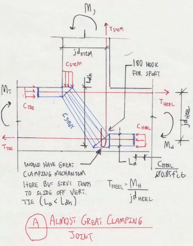

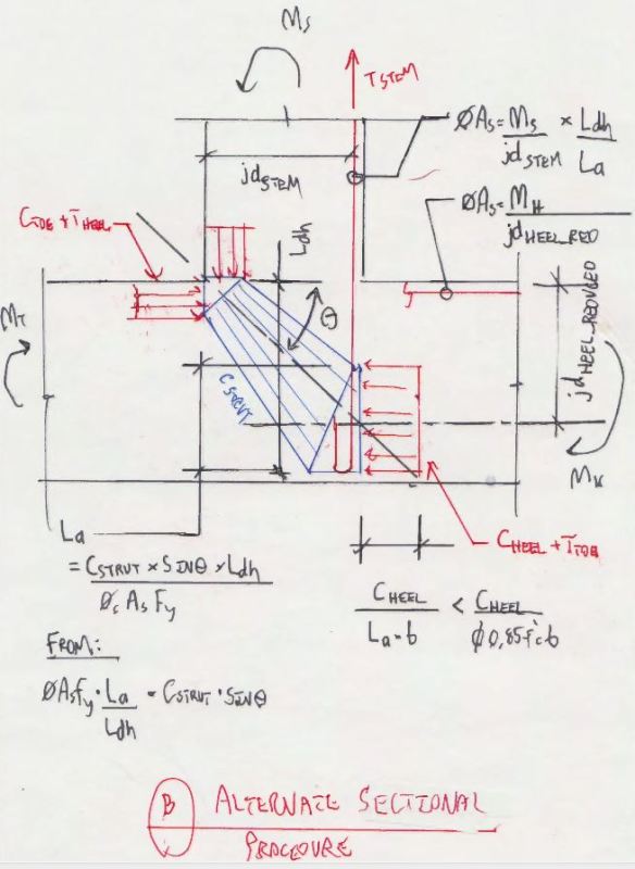

So I woke up this morning, popped out of bed, and realized that I still have a bit more to give on this. And not just petty bickering either. Good stuff.
Everybody seems to want to know how, and how well, the joints work when the stem bars are terminated in a developed hook and no more. Above, I've pitched two explanations for the mechanism/efficiency in such joints: the STM model and the joint clamping mechanism analogous to a perimeter beam column joint.
The major drawback with STM models, of course, is that nobody has time for that stuff in a design office. Additionally, there are some features of the joint behavior that are actually less intuitive when presented in STM than they might otherwise be if presented in terms of traditional sectional design methods.
So... I've decided to generate a proposed sectional method for the design of these joints as illustrated in the two sketches at the bottom of this post as follows:
1) Detail A shows the excellent clamping mechanism that could be relied on if only the strut would not slip off of the stem bars due to lack of development. I've assumed that the tension forces in the footing rebar can be conceived of as being pulled across the joint and manifested as additional compression on the other side. We do similar things in strut and tie so I'm comfortable with the validity of the assumption. Really, it's a big part of what makes the clamping mechanism so effective.
2) Detail B shows a proposed method of adjusting the design for the amount of stem bar development actually available. Again, I've assumed that the tension forces in the footing rebar can be conceived of as being pulled across the joint and manifested as additional compression on the other side. Basically, it amounts to this:
2a) Figure out the dimension La to make things pan out. Some iteration might be required.
2b) Increase the heel reinforcing to account for the reduced flexural depth (jd_heel_reduced).
2c) Increase the stem reinforcing to account for the partial rebar development (La vs Ldh).
2c) Check one way shear on heel based on reduced flexural depth.
2d) Ignore the compression strut as we would with other sectional methods (I guess).
2e) Have faith that the system will "find" this load path rather than initiate an anchorage failure along the way.

TME said:
Fully developing a large radius curved bar around the joint as KootK shows appears the be the most efficient detail when comparing tested results, modeling of forces, recommendations from CRSI/ACI/etc., constructibility, crack control, and ease of analysis. This is probably the biggest reason I'd side with KootK's argument over others.
I agree an unbroken bar is more more efficient. It is slightly more efficient. The hairpin (T13) gives 79%. When all else is equal and the bar continues into a decent length lap (T12b) the capacity goes to 82%. Different reinforcement ratios (T12, T16) can see the lapped/continuous bar capacity increase up to 100% capacity (perhaps the hairpin case would increase too, or maybe it maxxes out around 80%)
What I disagree with is that this proves the STM/pulley model, that it proves a bar with less than full lap is "abominable" and that it proves simply wrapping a continuous bar "guarantees" idealized performance. It is a silly to say 79% reflects a dangerous joint and that 82% is perfectly good reliable joint that we needn't look twice at. If one is questionable, the other is too.

As for the reason for the loss in strength in the hairpin - it is anchorage failure, as noted on nilssons images. The hairpin can pull out easier than a continuous/90degrees bar beacause there is nothing crossing the pullout interface - see image below. This is in line with KootKs ideas, but is not nearly as bad as he imagines.
Since the continuous bar cases start failing at only 3% more load, at 82%, these joint has other problems anyway. You can't simply make a continuous bar, dust your hands, and give yourself a pat on the back.
If you want the guaranteed 100% performance you are demanding, with no questions as to reduced capacity, you need diagonals and bandage bars, etc
