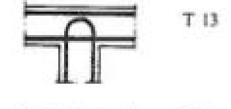

However the T13 hairpin doesn't perform that much worse, and it has no lap whatsoever between the horizontal bar and the hairpin!
I think that the explanation for some of the unexpectedly good performance one gets from poorer joint details originates from the clamping action that one gets when one has both a toe and a heel in play. Under that arrangement, you're getting an averaging effect between the capacities of a weaker joint on the toe side and a stronger joint on the heel side (analogous beam column joint below). I suspect that testing on heel-less retaining wall joints would lead to a greater disparity in the results.

Our case with a standard hook lapping with the horizontal bars presumably does better than the hairpin with virtually no lap.
I think that you're underestimating the extent to which the hairpins are just improved standard hooks. I've drawn a 10M standard hook to scale over top of a 10M hairpin below. It's almost the same lap splice dimension with the hairpin having the benefit of the extra upturn on the right to help restrain the strut coming into the corner.

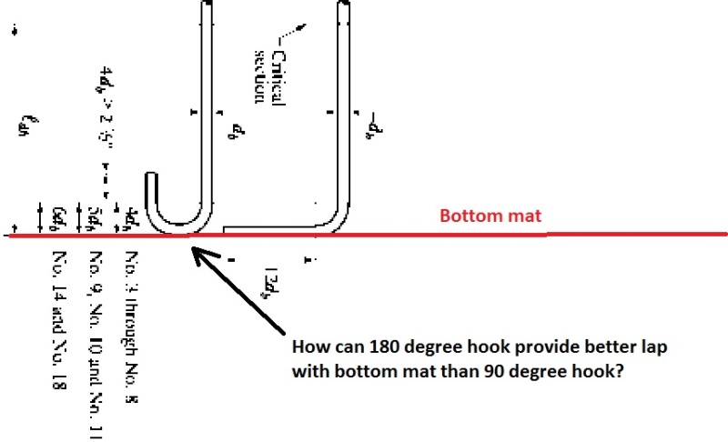

You said your precise concern was to give the bottom bars something to grab onto.
How does a hairpin, which provides a much shorter lap with the horizontal bar than does a standard 90 degree hook, provide more to grab onto?

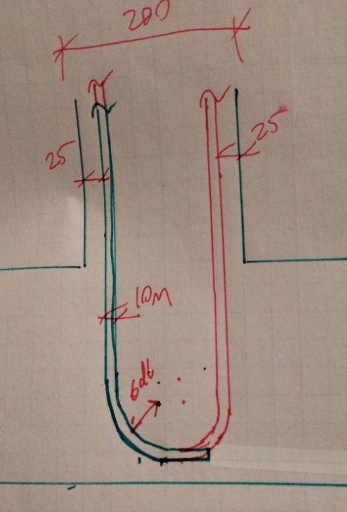

Also, is that cog you've drawn truly "to scale"? I don't think it is. This here is more like what a hairpin vs a standard cog looks like:
ANotehr version of same thing:

As I showed in my to-scale sketch above, the flat part of the hook/hairpin that lap splices is nearly identical for the small bars that would typically be used for a hairpin. So, as I see it, the lap length for the two arrangements is nearly identical and the hairpin has the added benefit of an extra "hook at the end of the hook" as it were. I don't see how that could do anything but help matters with regard to splicing.

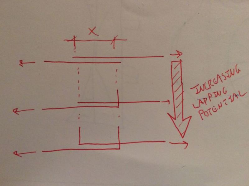

I think of it as I've shown in the sketch below. For the same lap length X, it seems intuitive to me that the versions with one or more hooks would do a better job of splicing.

It is indeed to scale including: member size, bar size, bar radius. Obviously, I didn't spend hours and hours making it perfect. Probably about five minutes.

This here is more like what a hairpin vs a standard cog looks like... How can a 180 degree hook provide a better lap with bottom mat that 90 degree hook?
A hairpin and a 180 hook are not the same thing and do not have the same geometry. In general, a hairpin will have a longer flat spot at the bottom.
Tomfh said:
This doesn't work at all according to pulley analogy yet in reality, is almost as efficient as unbroken bar

I've never seen a 90 degree bend that looks like that, and it doesn't look like any of the standard cogs in the various concrete codes. 90 degree bends have a straight extension.
These are to scale (again, yours isn't). You are claiming a hairpin 180 degree bend provides better splice to the horizontal bar than a 90 degree bend. I'm very surprised you would argue such a thing.

Nope. I didn't say a thing about 180 bends. I'm claiming that a hairpin would be better than a 90 bend. Everywhere that I've practiced, hairpins and 180 hooks are physically different things. Namely:
1) 180 hooks have no flat spot at the apex.
2) Hairpins will have whatever flat spot is required to fill up the space between the faces of the member, less cover.
The sketches below show the difference conceptually, by somebody else's code. The 4 x dia dimension on the right would be extended to suit the member width.
Nilson's results show 180 degree bends. I've been talking 180 degrees bends. You drew 180 degree bends (in your "to scale" sketch).
Now you're trying to sneak in trombones.

KootK repeatedly denied drawing a 180 degree hook, claming he drew a trombone hairpins. Here is what he drew:

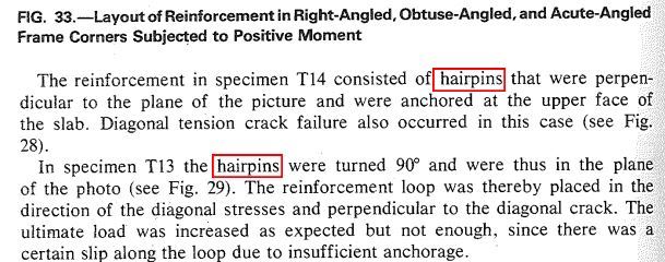

KootK denied Nillson drew 180 bends, but drew tromboine hairpins. Here are Nilsson's drawings.
I corrected KootK, and he again denied Nilsson drew 180 hooks, and again denied drawing 180 hooks, claiming Nilsson's hooks "look like [trombone] hairpins to me", and "I'll be the judge of what I drew, I drew [trombone] hairpins"
- The pictures do not state whether the bends are hairpins or 180 hook.
- You have interpreted the pictures as 180 hooks.
- I have interpreted the pictures as hairpins because they are 10M and appear to extend to the cover distance.
My interpreting a diagram differently from you doesn't make me a liar Tom. "Hairpin" may just be a term that is used differently in our respective markets. For what it's worth, the blurb below is from the Nilsson document. Obviously, you don't have the whole thing so there was no way for you to know definitively one way or another. I didn't know definitively until just now either. I just checked it out now to make sure that I wan't an accidental liar. At the very least, I think that this demonstrates that my interpretation of the diagrams was at least as valid as yours.
