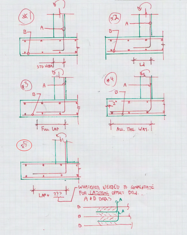

Not sure. I'm familiar with five versions of your detail, as shown and listed below.
#1. Standard hook. Abomination. I see this in about 45% of cases where a detail like yours is used.
#2. Ld. Better but still a fail. The A & B bars need to be lapped, not just developed. I see this in about 10% of cases where a detail like your is used.
#3. Full tension lap. Close but not quite good enough. The lap needs to account for the lateral offset between the A & B bars (via non-contact lap or STM). I see this in about 5% of cases where a detail like yours is used.
#4. Maximum extension to end of toe. Adequate but probably by accident rather than understanding. At this point, there's really no need to have the separate bottom mat of reinforcement unless there is some oddball reason for it in the heel. We're just wasting material and telegraphing our ignorance. I see this in about 40% of cases where a detail like yours is used.
#5. All good. I've yet so see this once in practice.
Perhaps your are that one dude in all of the milky way who's doing a legitimate #5. You tell me.
Why is a hook an abomination if the bar embedment plus hook is sufficient to develop the bar?
Is there any evidence of standard hooks embedded 10 inches deep tearing out of retaining wall footings?
At this point, I'll have to assume that you're either joking or trying to get me to embark upon a program of cutting / self-immolation.
Im not joking. It's a genuine question.
If bars break before concrete breaks then what's the problem with that arrangement?
Forgive me but shouldn't there be no effective difference in the lap-splice length for contact or non-contact lap splices? Why do we need to account for it here? Apparently my retaining wall joints fall in your 5%... So close.

There is a major difference between non-contact and contact lap splices. The distance of separation must be added to the length of the lap splice. This is well treated in many codes, though I do not know the ACI code well enough to swear to it being addressed, it *is* well addressed by the ACI committee on lap splicing. See
Back to the point at hand: The "all the way" detail is standard practice in New Zealand, and what I typically detail unless it is a particularly long toe in the footing. It is is particularly long, then I do No. 5. I'm not kidding, and can probably dig up three or four examples from my records if you want to see it done in practice.
Quick question: Do you really not like the steel extended to the heel? I actually like to include this as temperature and shrinkage, and just to keep the thing easy to construct. I would worry that if you curtail these bars, and the Contractor mixed things up, they might curtail the TOE bars! Take that plus an over-zealous pour, or a pre-pour rebar check by a green intern who misses the issue and blamo you've got a real problem...
WAIT... Just checked my records and I don't do five. I would have to call mine an option "6", where the full development length, including compensation for offset lap splice, starts from the toe-side of the stem to footing interface. So my lap is longer than you think it needs to be; You may continue to believe that no one does it your <<All good/Never seen in practice>> option. *friendly rib jab*
And while I have no reason for doing that beyond my hatred of development within a beam-column joint (which is likely a habit from all my seismic and blast work), I will keep doing it and much prefer to start my development lengths outside of anything that looks like a beam-column joint.

13-28 shows the bar leaving the beam-column (like) joint and being developed into the toe, not just a plain 90 deg hook development. You can't reliably develop a 90 deg hook in a tension or high (unconfined) shear zone. That's why it needs to go through to the toe, where it will be in a mat of concrete under compression/subjected to the compression strut coming from the stem.
Yes, that's what I was referring to. Sorry for the confusion. The cog leaving into the toe so that the hook grabs onto nicely confined concrete. The other way isn't as efficient...
Personally I do #4 except with the steel going under the bottom mat.

Nope. I was a bit imprecise with my terminology. I consider there to be two types of non-contact lap splices per North American codes:
1) Non-contact laps between bars less than 6" apart in which case no addition need be made to the lap length.
2) Non-contact laps between bars greater than 6" apart in which lap lengths need to be extended via STM theory, methods found in foreign codes, or judgment.
So yeah, depending on your bar spacings, there are cases where regular tension laps would get the job done.
Obviously, it's not a problem from a performance perspective. It makes me queasy on two fronts:
1) It seems to befuddle designers. Most of the time when I see the bottom mat, I also see the hook bar details that I dislike.
2) It strikes me as wasteful in many applications.

So we're in agreement then? #1 is a detailing abomination?
No, I don't agree with that. I agree with your link that it appears a satisfactory detail. Not necessarily the absolute best detail, but satisfactory. It's silly to call it "an abomination" when it can yield the bars and has proven itself the world over.
An "abomination" is detail posted above where the cog is barely embedded at all, and sitting in the very top of the footing.
Personally I do #4, except the cog goes under the bottom cross bars.
