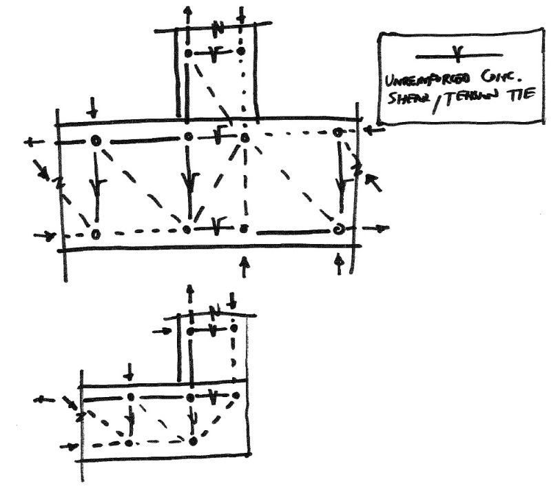

1) Developing the strut and tie method? Lot's of effort there.
2) Developing joint design guides like this and this.
Why publish hundreds of pages on joint design when it could just all be summed up with "develop the bars"? That would take what, a paragraph? Silly researchers and code committees...

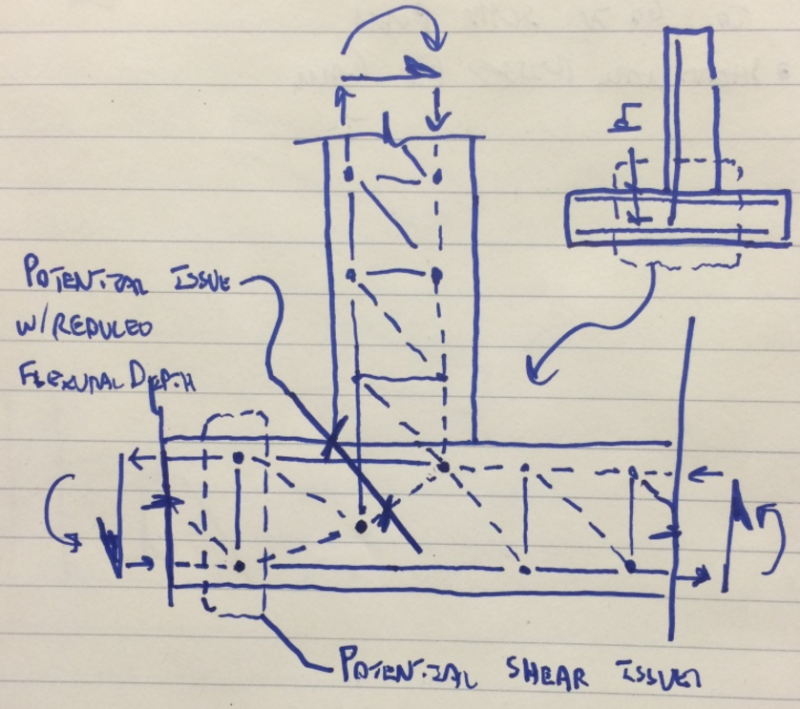

Detail #1 has a version of the problem show below from this document by one of the gods of concrete design. And whether or not the hook sits above or below the bars make no appreciable difference. It's not as though reinforced concrete design is about hanging reinforcing bars from other reinforcing bars. Of course, it's the very same anchorage issue that I highlighted in the STM model that I posted back in March. It would be the concrete breakout potentially represented by those two struts coming up from the hook location.
A slab hanging from a beam is different problem. That being said, only Gilbert would think that slab is going to fall off that beam due to the slab diagonal struts not being anchored up to the top of the beam. I've always wondered that - why are STM proponents so happy to rely on unreinforced concrete to resolve the diagonal tension struts in regular slabs (and beams for that matter). If STM is the new state of the art, and we aren't to rely on unreinforced concrete surfaces, shouldn't we be scrapping all notions of inherent shear capacity? Ties throughout in all slabs from now on?
It is a different problem but the detailing issue at play is the same: planes of weakness being created where concrete must resist tensile stress for a complete load path.
While Gilbert's suggestion will lead to better detailing in my opinion, I agree that it shouldn't be strictly necessary. It's probably more important to address hanger bar issues with the stirrups.
Well, this STM proponent has no intention of abandoning the use of diagonal concrete tension to resist shear. It works and is the most economical solution in many instances. When you're in the Bernoulli region of a member, STM is quite unsuitable as a design tool and really morphs into just a framework for the discussion of how load moves around. To that end, a lot of folks will draw STM models using diagonal concrete tension shear resistance as "phantom" ties. That's what Teguci's done in his model below. Everywhere that you see the SQRT symbol over a tie, it's diagonal tension rather than reinforcing. Sadly, it took me a few months to realize that the SQRT symbol was chosen in homage to SQRT(f'c), the driving parameter behind diagonal tension resistance. Sometimes I'm a little slow on the uptake.
Why this double standard? Why is the former abominable and the latter perfectly reasonable?

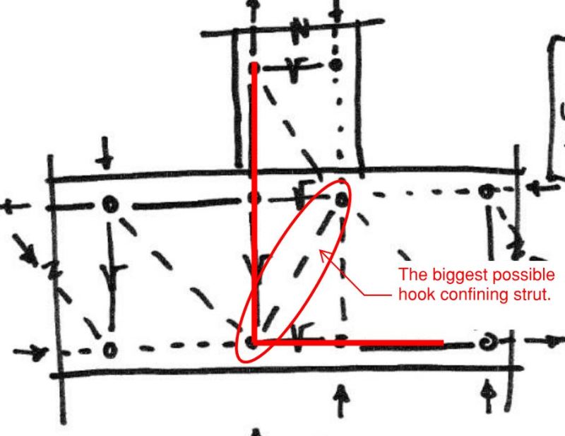

"Am I missing something?" Yes; As the distance of the gap between the bars goes above between 3 to 6 bar diameters, you are not getting the assured stress field transfer you need. The ACI Code (which I openly stated I don't know) apparently treats this by eliminating what I call non-contact lap splices. A lap splice within 3 bar diameters *is* a contact lap splice according to the codes I am familiar with, and only those which need to be extended because of the gap are called "non-contact".
Like so:
Leading to code clauses like:
This is the effect that Kootk was talking about, so I presume he said that you hadn't missed something because he is actually familiar with US practice where I am not...
But my fault entirely; I linked the wrong ACI paper and now can't lay my hand on the correct one. *sigh*

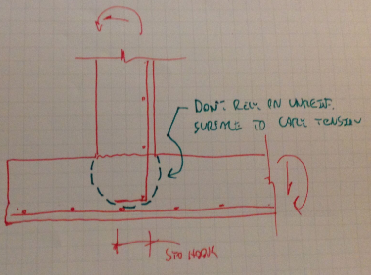

"The whole point of a hooked anchorage is to quickly develop the tension potential of a reinforcing bar. It would be useless if it didn't apply in tension zones. Most exterior beam column joints have hooked development taking place withing a region of flexural tension and high shear. The reason that the bars need to go around the corner is because the tension force needs to go around the corner. And that's not the same thing as bar development."
No. The way a hook works requires either a compression field or a tension field provided by confinement. That's STM; you can't have it both ways.
Perhaps I could have been more clear, try this: "You can't reliably develop a 90 deg hook in an unreinforced tension or high (unconfined) shear zone." Both are for the same STM reasons; You have to have something to grab onto, and that actually needs to be a compression field, regardless of how it is provided.
I still strongly disagree with your idea that the same force goes around the corner through the bar in all situations. That's frame thinking and doesn't apply to mass concrete, deep beams, or retaining walls. If you have an alternate load path that will result in a lower total stress on the concrete, that is the equilibrium state the concrete and bars will seek.

Huh? The intent behind the detail and the research doesn't affect the conclusions? I'm afraid that I don't follow.
Firstly, one way shear has been shown to work reliably whereas breakout of concrete anchors (rebar in this case) has not. Are you familiar with the much maligned ACI Appendix D used in the US? It exists because of this problem. The Wheeler research that you keep coming back to intentionally created an environment where concrete breakout would be precluded: mass concrete and stirrups at 125 o/c. As such, that research is not relevant to the concrete in tension issues that are at play here.
Secondly, STM is just one possible method of analysis. Nothing about STM precludes the use of alternate methods that may utilize concrete in tension, particularly in Bernoulli regions. Same goes for folks that are proponents of STM. Being an STM fan doesn't mean that I deny diagonal tension shear resistance.

Really? Perhaps look a little closer then. Like most laboratory work, the testing was done on tiny little bars for which a standard hook would be on the order of 120 mm. The tested bars extended out to the end of the toe creating hook extensions ranging from 400 mm to 600 mm.

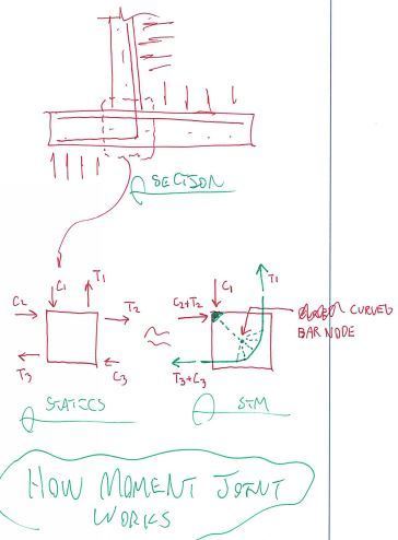

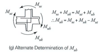

Oh my. I can see now why we're having trouble finding common ground. The retaining wall joints is absolutely a frame joint and I encourage you to revisit your stance on that. Do you have a access to any of the CRSI handbooks? The shabby sketch that I posted on Jan 14, and have repeated below, illustrates the idea.
I was confused about your intent. I thought that you meant that you couldn't have a hook in a flexural tension zone. I agree, a hook ought to grab on to a diagonal compression strut. That's a big part of what lead to my confusion. You indicated that you didn't think that the concrete directly below the stem was a good place for a hook. In fact, that is the location where you would have the largest possible compression strut/field available to restrain such a hook. Using corner bars to restrain that monster strut, with properly anchored vertical and horizontal legs, is really the crux of this thread.
I agree with KootK, the joint from wall base to stem is 100% moment connection joint. Here's a nice little figure from the CRSI retaining wall manual KootK referred to that shows the flexural forces going into this joint:
This is what KootK is showing with his curved bar node sketch. If possible I highly recommend picking up a copy of the CRSI retaining wall manual (ugh, all broken up into individual manuals now), lots of good info in there.
