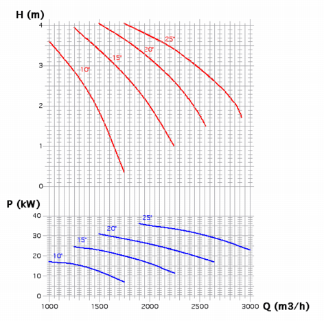

Pump must be a special version of this:
Note that flow rate is specified as cubic meters per Hour!
Pump was designed(?) and made in China where power is 220 V at 50 Hz, and power in Philippines is 60 Hz, so what could possibly go wrong with pump-motor performance?
Walt

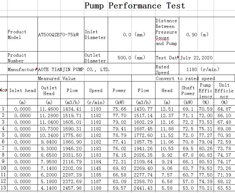

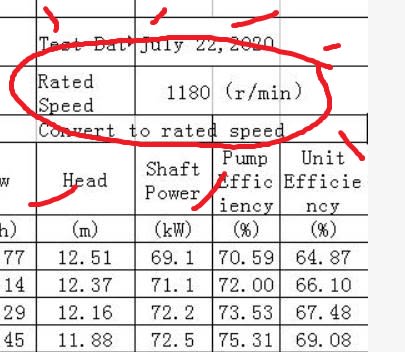

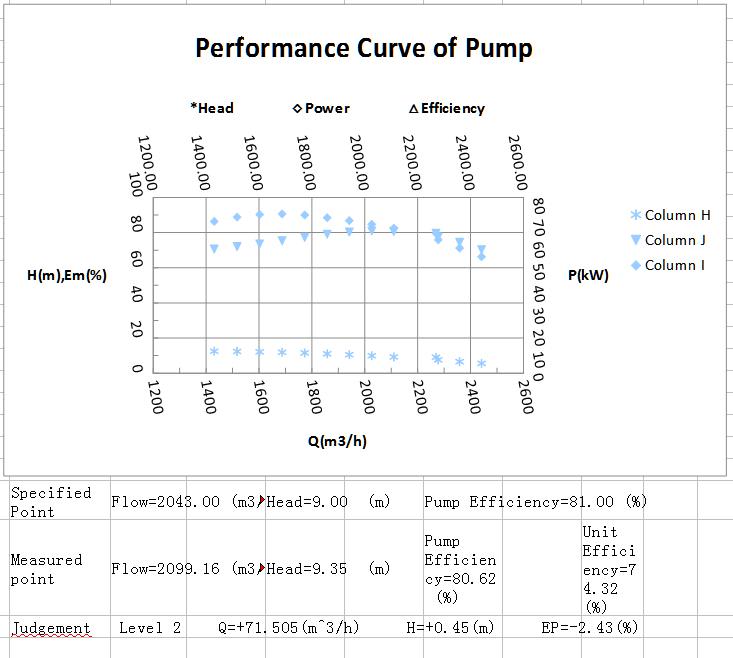

Still scratching my head on this. Note the performance data above?
That is a 60Hz induction motor speed for a 6-pole motor.
While spinning a 50Hz axial with 60Hz gets you 20% more flow as the problem seems to be, I'm flummoxed by the data above stating 89hp.
Keith Cress
kcress -
The data is not consistent and doesn't match reality.
However when I stuck in 380V instead of 440 it started to get close. 380 wan mentioned in a few places as being the 3 phase supply in the Philippines...
Or the efficiency is not as good due to fouling of the blades or things wrapped around the shaft out that the data you have is for a different pump.
As for the OP flow numbers, keep in mind that in many countries the meaning of commas vs decimal points in numbers is the reverse of what we mean in the US or UK.
