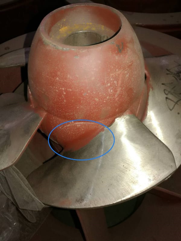

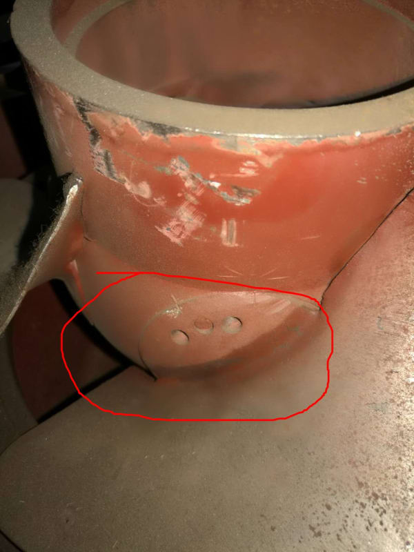

The manufacturer informed us the blade angles are adjustable. By reducing the blade pitch by 4° the output will drop by 12% and this should drop the current down.
Does this work for us?
Keith Cress
kcress -

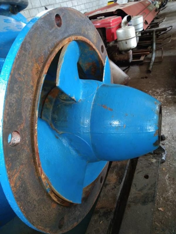

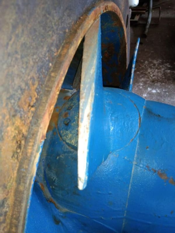

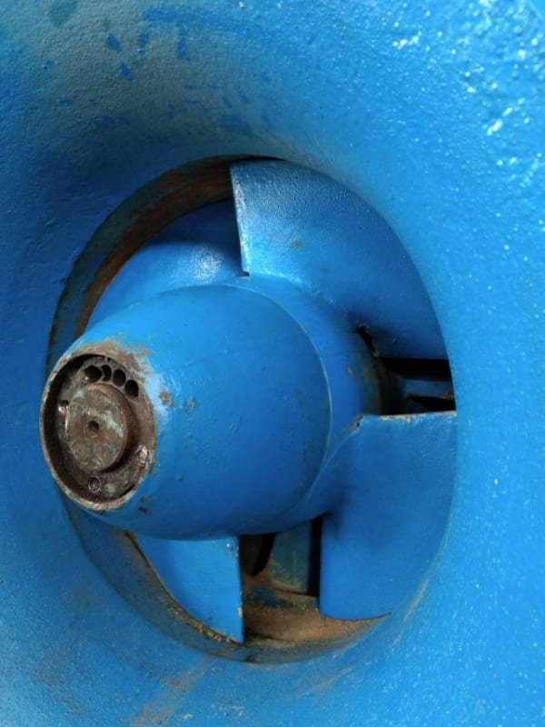

I would be much more concerned with the intended gap or lack of gap between blades and the inlet tube. What is it supposed to be?
Those look like scrape marks to me on the blades.
Only other thing is whether the pump is designed to operate at an angle as shown in one of your sketches above. Is this causing extra friction or bending of the body given the very small gap between blades and body.
A lot of corrosion on the bowl ring, enough to cause interference with the impeller blades..as demonstrated by the contact marks on the blades.... whether enough to show up as overload - don't know. Is the pump free to rotate by hand?
They are showing 2 different impellers, one painted one unpainted is this telling us anything?
And if the angle change is those two marks on the last photo they look an awful lot more than 4 degrees - more like 40 degrees.
But I agree with artisi, there seem to be photos of different pumps all the time, never the same one.
Also is it my eyesight or does the outer bowl taper in?
Are the blades hitting some of the bowl when it is fully pushed back in the slot?
That is two different pumps. The "primed" looking one is in the Chinese factory and are just there to illustrate the setting pins and fasteners involved in a pitch change just sent by the factory.
As for scratch marks... how could there not be any? This thing sits in a river and no doubt pumps sand particles a bazillion times a day cramming them thru the gap.
I'll check to see if it spins freely though the guy seems pretty sharp to me so I doubt a hanging-up blade would escape his notice.
A bending body.. Hmm. I mention that too.
Generally the tighter the gap the more efficient but at some point you certainly would have a fail on getting stuff stuck in the gap.
Yeah seems like a bunch more than 4° for a pin change but since we don't see the pin details it may be the pin holes are a vernier type thing where you pull the pin and move it over a hole in both the prop and the cone. Note there are three holes in the prop and three holes in the cone.

For this type of pump I don't think clearance is that crucial to performance but it looks very tight to me both radial and at the back of the bit where the propellor sits.
Those scratches look like metal to metal to me not gravel, but if they are getting bigger pebbles stuck in there and jamming the blades then it will add a lot to the power losses.
