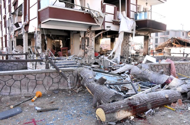

I assume that , you know the origin of 34kN/m2 .. If the façade and partition walls weaker than slabs, and the structure is monolithic ,still IMO, you may assume single storey ht .
The following picture is aftermath of natural gas explosion.. I found at web.. Notice that, the columns and the main structure still intact..

In this case, the extreme event ( was also the case Ronan bldg) , gas explosion. In your case, if the FRS is a frame system ( rather than load bearing walls, pc load bearing walls etc.. ) the collapse of weaker exterior walls and partition walls will be fuse for the main FRS during gas explosion. IMO, the ductile design and detailing of the CIP slabs will justify single storey height as your column effective length.
The other accidental and extreme loadings which are applicable shall also be studied.
