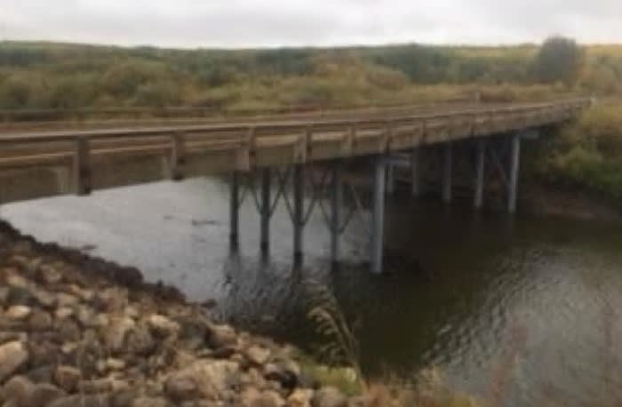

Undoubtedly the pile bent(pier)settled. Note the cross bracing elevation at the water line difference between the two piers showing the near one has settled significantly. My guess is these pipe piers were made by jacking pipe sections down, one at a time with the existing bridge as the reaction load. Could be the jack was not accurately calibrated and maybe way undersized. The "pile cap" WF section has not bent or distorted due to excessive loading by the jack. These piles were not preloaded to any degree. Of course maybe there was no jacking.
Yes, obviously a failure by settlement. Also obvious that it was the result of a total lack of any subsurface investigation whatsoever. Blaming God for not creating something solid to hold it up was a nice touch, though.
I'm kinda with IRstuff on this one. If the new piers were placed at the same location as the old ones then there would have been pile conflicts. Possibly they cut the old piles off below the waterline and attempted to tie into them with new piers and cap beam. Then the new piers slipped off. Perhaps the old piles were heavily affected by scour and the new piers were tied in off-center applying an eccentric load which failed them.
Otherwise I have trouble understanding the sudden and immediate failure of continuous piles under the same reaction loads that were used to press them.
Here is a photo of the bridge before failure. Note that pile bracing connections are far above water level. Pile bent must have settled uniformly not to bend the x-bracing. Also, in the "after failure" photo the the bracing connections to piling are underwater, as OG mentioned... must have been many feet of settlement before the span slipped of the pile cap.
