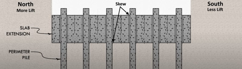

No, dauwerda, they are in a 36-inch casing for about 100 feet, then in Old Bay Clay for another 100 feet, then sands and gravels of the Lower Alameda formation for about 50 feet, then a "rock socket" into Franciscan melange. So, initially like 200 feet unsupported but then the 24-inch pipe piles rest against the bottom of the 36-inch casing, having squashed the soft stuff they inject in between the 24's and the 36's. Seems a bit iffy to me, but I am just a dumb dirt engineer.
I have not reviewed any technical documents, I just watched the video that I mentioned.
It (the video) states that the holes will be overdrilled so that no part of the new piles will come into contact with the old bay clay. I take this as the oversized casing (36"?) will be installed all the way down to bedrock. The pile itself will fit inside the casing (24"?) and be socketed into the bedrock. The video then states that the annular space will be filled with low strength material - after jacking. This is to ensure no weight is transferred to the clay incidentally through skin friction. If the jacking is happening prior to filling the annular space the pile must be designed for the unsupported length extending from the bedrock to the top of the pile. Are you saying this is not the case?
The way this has gone, so far, maybe I'm not too confident of that statement...
My recollection from the EDRT comment log, is that they will be using an Anti-Friction coating on the lower 24 inch casings, passing through the OBC.
I still don't know how they intend to adjust the tilt with these piles threading through an annulus of about 1/2 inch. If you start at the southwest end of the tower and move to the northwest corner, with incrementally more lift to the northwest corner than to the southwest piles; then skew within the annulus between the pile and the foundation extension is inevitable.

But you are correct about the anti-friction coating on the 24's. What that does to the lateral capacity I don't know for sure, but I guess it reduces what little lateral support is provided by the OBC!
dauwerda PRACTICAL ENGINEERING did a nice presentation for laypeople but it comes up short on some technical issues. The 36-inch casings definitely do not go to rock - they go only to the top of the OBC.
epoxybot one more thing. I like your cross-section of the 24's going through the mat extension but, while the design team has sometimes talked about "lifting" the NW corner, there is no way that the jacks are going the actually lift the building. The jacks are just to transfer load rather than to cause any movements. If anything moves it will be the 24-inch piles compressing and buckling rather than the building lifting. They have talked about the load transfer relieving the pressure on the OBC which, over time, might cause some rebound, which would lift the sand layer, the existing forest of concrete piles, the mat and the mat extension, which would cause relative movement of the 24's and the mat extension, but I don't know if that will actually happen. What will happen is that the south and east sides of the building will continue to settle. At what point that locks the 24's into the mat extension I don't know. One other thing, someone I know who talks to Jaxon van Derbeken at NBC Bay Area told me that Jaxon would like to talk to you. Not I think on camera but just because you have a lot of good information. Up to you whether you contact him or not.
