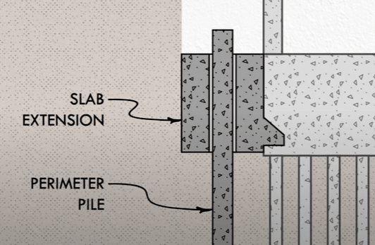

Towards the end of the video, there's a drawing showing how the current attempt to right the building is supposed to work (at around 9:30). It includes adding an additional piece of concrete under the sidewalk, and keying that piece to the existing foundation, and then lifting both with hydraulic jacks.
My problem is with the design of the key. The "upper lifting surface", because it is angled, would appear to cam the new additional concrete away from the foundation. This would increasingly lessen engagement, and lower the effectiveness of the concept.
Or so it appears to me.

I noticed that too, but I assume that Grady's illustration is simplified and not based on any drawings.
"simplified"?
Not the word that comes to my mind.
spsalso

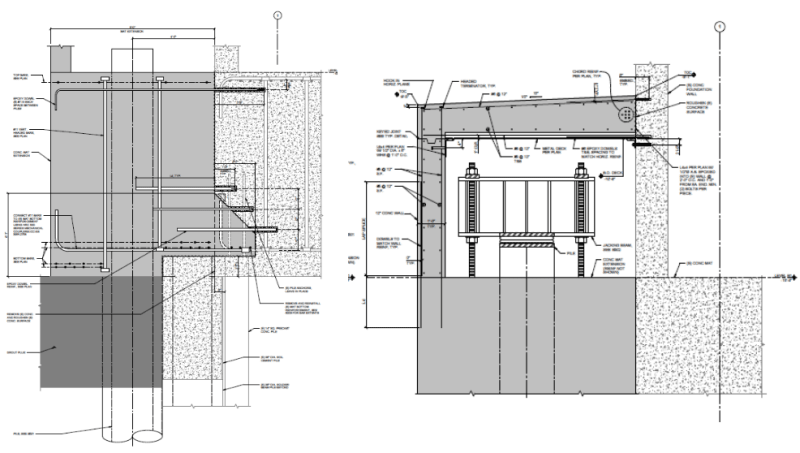

The direction of the keyway is incorrect in the sketch.
Grady has it consistent with SG&H:
PRACTICAL ENGINEERING schematic:
SG&H detail:
I have no idea of what they want the keyway for, but if they are uplifting, the keyway is in the wrong direction. Maybe part of the problem is that they don't know what they are doing.
I think the upwards slope of the keyway allows for better filling without voids.
With properly consolidated concrete this would not be an issue... even a slope of 5deg would suffice if they needed one. A slope of 45deg is way too much.
Drill/core on a sloped concrete surface will be difficult.
Having the key cut at an angle like that increases the cross section area of the rod in the shear plane.
The "keyway" is there to also expose the original bottom rebar mat and mechanically couple to new added rebar.
Whilst the moment component of the uplift reaction (a horizontal force at the keyway location) tends to 'open' up the joint, the key does provide reaction for the vertical component via bearing.
What alternative direction/location would you make the key, dik?
I agree with Ingenuity, the keyway is not meant to transfer shear at all, it is there to allow them to tie into the existing reinforcement.
You can still achieve that without the excessive slope without causing a significant 'wedging' action.
As the slope of the keyway allows the new section of concrete to pull away horizontally, that will then tension the new horizontal rebar.

OK, I'm maybe corrected. I still don't think there's any reason to pretension the steel, and it just adds to the connecting force caused the the cantilever jacking.
