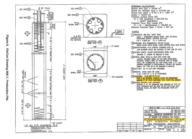

The production pile reinforcing was given in SG&H's 2017 Seismic Safety Report. SG&H butchered their description of the tops of the piles on page 5 of the report. There are so many mistakes, in their description of the piles that it borders on suspicious. Since it was one of the key aspects that the Peer Review asked to be examined, it is amazing that no one bothered to compare what SG&H wrote, with the figures at the end of the report.

Not only Larry Karp but also the LERA team. I don't know if that's where Larry and Josh learned of their concern about the tops of the piles or if they developed that independently. But the LERA team believed that one of the advantages of their "internal" fix is that the micropiles would be driven (actually pushed, not driven)through stout casings inserted through the mat and that these casings would restore some of the moment capacity that has been lost. I am not sure how critical this really is since the structures is embedded 25-35 feet, but even a small amount of dishing and tilting must have caused some damage to the tops of the piles.
I think that the situation is so serious that Hamburgers group must be exposed for saying that the building is completely safe and nothing has failed. We have 950 prestressed piles that have an imposed rotation applied of approximately 0.003 in/in in bending which is the definition of the strain limit for ultimate strength of concrete. However the axial load in these piles due to prestress is 967 psi or 0.97 KSI which for an E = 4.8 x 10^3 KSI (7000 psi concrete) results in an initial axial strain of = 0.97/(4.8x10^3)= 0.0002 i/in The permanent vertical load per pile including is 229700 K /950 = 241 k/pile = 241/(194.9+(1.22x6)) = 1.19 KSI which gives a total strain in compression of 0.0002 + .0003 in/in = 0.0005 in axial and plus 0.003 in/in bending = 0.0035 in/in total strain. These figures are based on each pile carrying equal load and an equal fall east to west of 0.30% ie 22.5 in or 1.875 ft in about 640 ft = 0.00293 in/in.
Without any wind or earthquake the concrete piles at the slab are already strained well beyond the traditional 0.003 to 0.0035 strain limit for concrete in ultimate strength design and it should be incorrect to argue that nothing is overstressed. I agree 100% with Karp and the LERA team that probably a number of piles have failed.
Hopefully someone could verify my calculations and hopefully find some error or the building is not in a great situation. Walnuts & dik it might be time for you step up and prove me wrong. Since I deleted and revised this post Walnuts has already indicated he is not interested. Can someone else check.

The fact that the concrete has technically failed in compression does not "disconnect" the piles from the 10' thick slab, reinforcing steel and friction in the concrete should maintain the connection but bending resistance is reduced or nullified and shear resistance is quite possibly reduced. Shear resistance is essential to transfer lateral loads from wind or earthquake to the piles. The tops of at least some of the piles have probably been physically damaged. It is very simple to check the slope on the base slab at any point across the 10' thick pad to assess the induced rotation of various piles in the group and the resulting strain. No catastrophic smoosh but, in my opinion, not good either. A slope of 0.3 feet across the 105' of 10' thick slab gives a slope of 0.003 ft/ft or .003 in/in which is the accepted limit for the strain in the concrete piles at ultimate capacity. Shoot a laser across and measure anywhere, simple.
