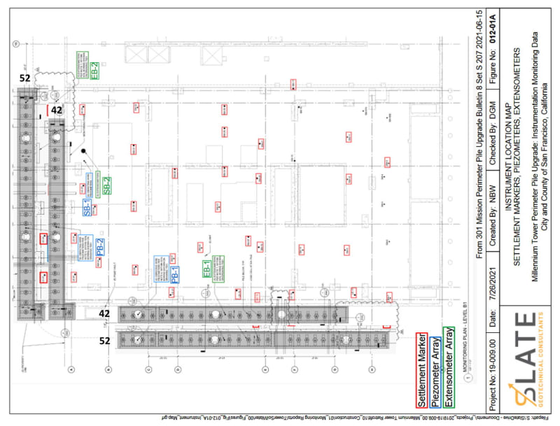

This photo from ENR on Sep. 29 2021, somewhat suggests that revision of the number of piles from 52 to 42, resulted in abandonment of work in progress at the southern limit of the Perimeter Pile Upgrade.
John Egan’s report of June 23, 2021 stated the sum of 36” casings on Fremont St. would be completed by June 25, 2021. Why risk another 36” pile on Fremont St., which is the most problematic source of settlement?
epoxybot, location 33 where they are going to do the test 36-inch casing is the third pile on Mission Street. They did finish the 36-inch casings on Fremont back in June. If they keep the water level up, settlement of the corner should be minimal unless there is "heave" into the tip of the casing of the OBC. They have dismissed that as a cause of the increased rate of settlement but questions in the comment log suggest that Shah Vahdani likes it. He may be right. Almost certainly it is not vibration. That makes no sense for several reasons.

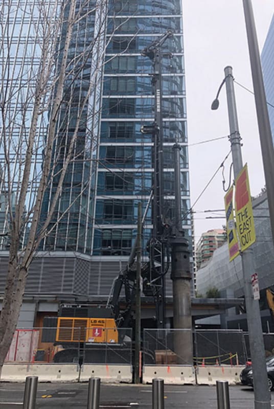

Several sharp increases of piezometric head have been observed in the PB-1 piezometer at a depth of 85 feet bgs (located in the Marine/Colma Sands). [highlight #FCE94F]The spike on May 15, 2021[/highlight], between 6AM-12PM corresponds to a known influx of water onto the crane mat/sidewalk during installation of the 36" casing as the auger is retracted and soil is removed. The Building Engineer for the Tower also noted water infiltration into the basement. Similar increases were not observed in SB-1 and PB-2, as these piezometers are not situated close to the source of this water influx.
Additional spikes were observed on May 28, 2021, June 1, 2021, and June 7, 2021, all between 6AM and 12PM, and on June 11, 2021, between 6AM-9AM. The cause of the May 28 and June 1 spikes is not known, but likely is similarly due to an influx of water as described above. The spike on June 7 corresponds to advancement of the 36-inch casing for Pile #27 to a depth of ≈89 feet feet bgs and on June 11, the spike corresponds to advancement of the 36-inch casing for Pile #28 similarly to a depth of ≈89 feet feet bgs and observed water addition; both Piles #27 and #28 are located in close proximity to Piezometer PB-1.

Serendipity would have it that LB Karp was on-site taking pictures on June 15th and you can see the results of the water influx, on hat date. Photo 1 & Photo 2

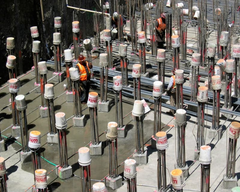

If the tops of the piles are fixed at the 10' thick slab the tilt of the building would tend to bend the tops of the piles so that they curve slightly out to the East. If the piles are not fixed the tilt would tend to crush the edge of the pile tops. Since the tilt of the building is at about 0.3% ie .003 ft/ft this would mean that no matter if fixed or pinned the strain in the piles at the top would be .003 in/in which just happens to be the strain limit for ultimate design. Since the base slab is apparently dished this could mean that the slope on the East side of the building could be greater than 0.3%. So some of the building settlement could be from failure in the tops of the concrete piles to various degrees across the building. There certainly could be a lot going on here at once; enough to confuse the engineers.
Dug up this picture from a 2016 article written by Alex Weinberg P.E. then of NY. The included photo clearly show the 14" square pile tops protruding into the 10' thick pad with dowels already coming out of the tops to transfer load to the base slab. It would thus appear to me that the piles are virtually fixed at the slab which means that the building tilt will be transferred as moment into the piles. Since the piles are designed for axial load it is possible that the combined bending and axial load would overstress the piles. Since there are no details of the pile reinforcing it is not possible to check this theory but the tilt of the building would result in about 0.003 in/in of strain in bending only without axial load.
