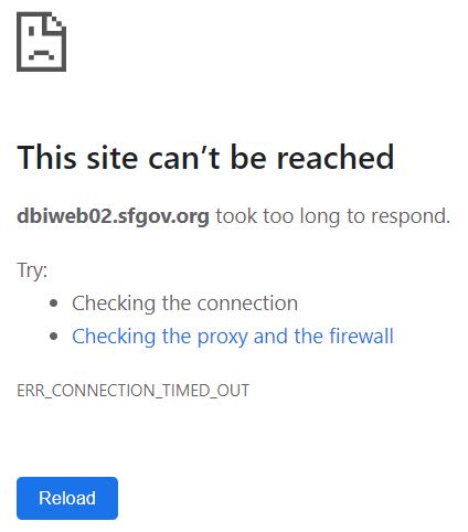

Tried clicking on the permit number search and ended up with... maybe something else works...
Odd. I got through. They want to put new bolts into the concrete to hold the cladding, or whatever it is. The permit appears to be for installing the bolts.
