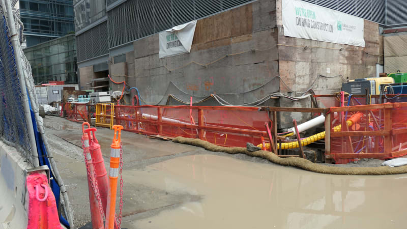

spalso, I think Jaxon is just repeating what Hamburger, through the Homeowners Association, and the City are telling him. That's why it does not make any sense! I can think of four reasons why they might have resumed work on Fremont Street: (1) There is a problem with confirming that the jet grout plug is sound and they need more time to sort that out; (2) they realized that full transfer of load to some or all of the planned 6 perimeter piles along Mission Street, without simultaneously transfering load along Fremomt Street was nuts and would have done funny things to the mat, and maybe the moment frames and the facade as well; (3) they realized that installing the secondary secant piles on Fremont Street would not affect tilt and settlement nearly as much as installing the primary secant piles did (because the secondary piles have existing primary piles on both sides so there has to be less ground loss as the casing is advanced - and also because the primary piles provide some resistance to lateral movement of the soil adjacent to the building, at least until it is excavated out), and (4) they are running out of time and money. It is reported that they are now operating on the insurance coverage that Millennium Partners agreed to buy on the design team and the Fix contractor in order to seal the settlement deal, so it might actually be the insurers who are now calling the shots. Or some combination of the above? Who knows?!

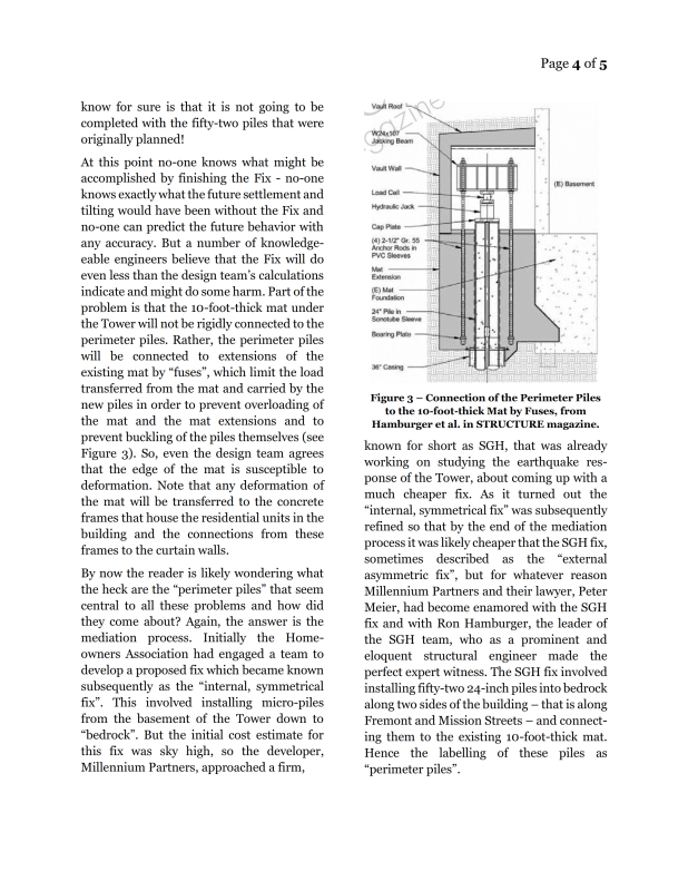

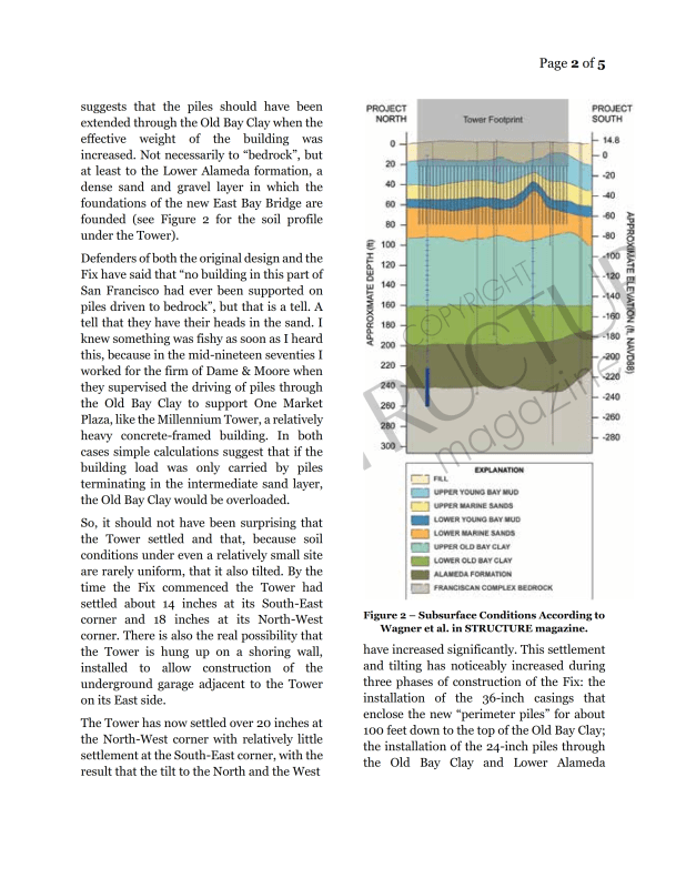

This new article by geotechnical engineer Robert Pyke might be of interest. I hope that it is not too long.
No... it's just about the right length. I'm surprised the City of San Francisco or the California Professional Engineers Association hasn't gotten involved.
I agree with dik, the article seemed about the right length and with a great explanation of what is happening. I certainly understand why the original president of the HOA resigned, I wouldn't of been comfortable at all signing on to this proposal. The internal micro piles certainly seem like a much better solution for many reasons I'm really surprised it wasn't pursued more (even if it was value engineered). The fact that these new exterior piles are not solidly connected to the mat is of great concern to me and the fact that they are actually "fused" in their connection is even of more concern! I wonder what the press will be if some of these fuses break?

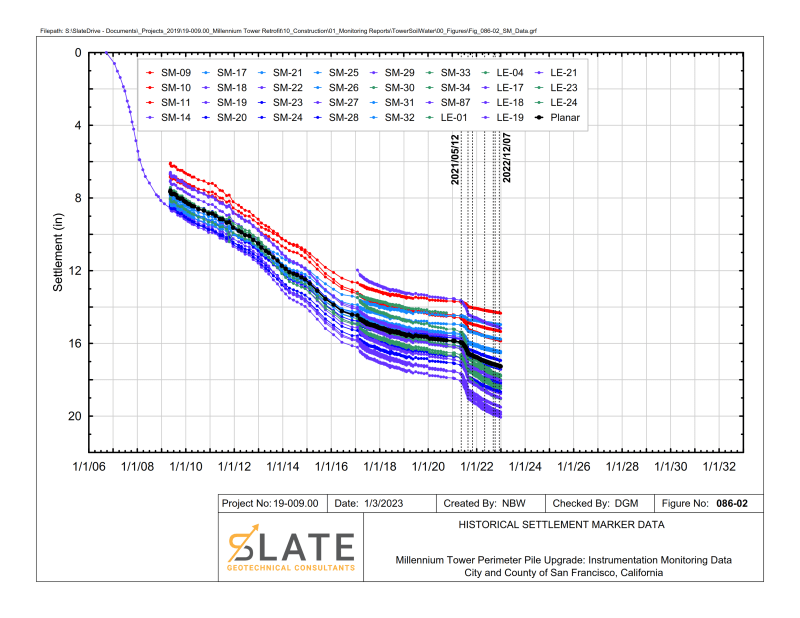

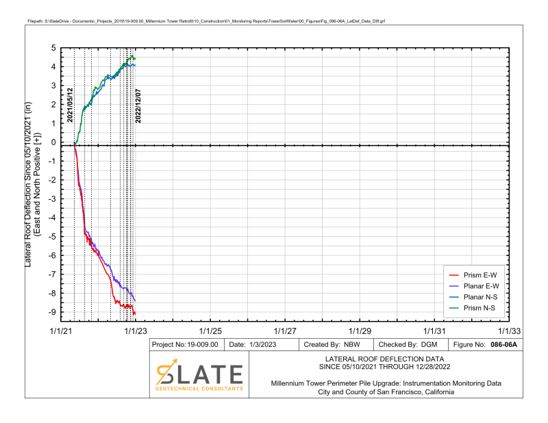

The Tip-o-meter keeps reporting its results.
It's still tipping.
Have you thought how convenient it would have been if the Tip-o-meter had never been established?
For some people.
