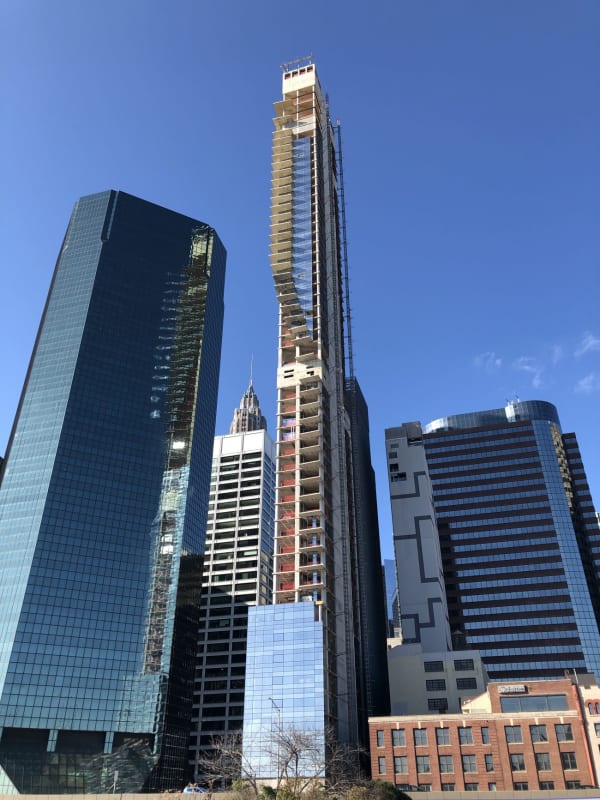

The Millennium Effect or The Leaning Tower of New York City
The Real Deal: Nearly all prospective buyers have backed away from a troubled development site near the South Street Seaport, where a still-unfinished condo tower leans slightly to the north.
I'm being speculative here, regarding 'The Millennium Effect' but if the foundation problems are the cause of buyers pulling out of unit reservations for Lower Manhattan's 161 Maiden Lane, it doesn't seem to bode well for current owners of units in the Millennium Tower, as to resale value and time spent on the market. Too much bad news.
Since there is very little that is known, as to the cause of the tilt, it is perhaps too early to give this an Engineering Failure & Disaster thread.
I'm not seeing how the "boding" transfers from New York to SF.
"I was gonna buy this condo in Millennium Tower, but that one that's tipping in New York just makes me nervous."
You weren't nervous ALREADY?
