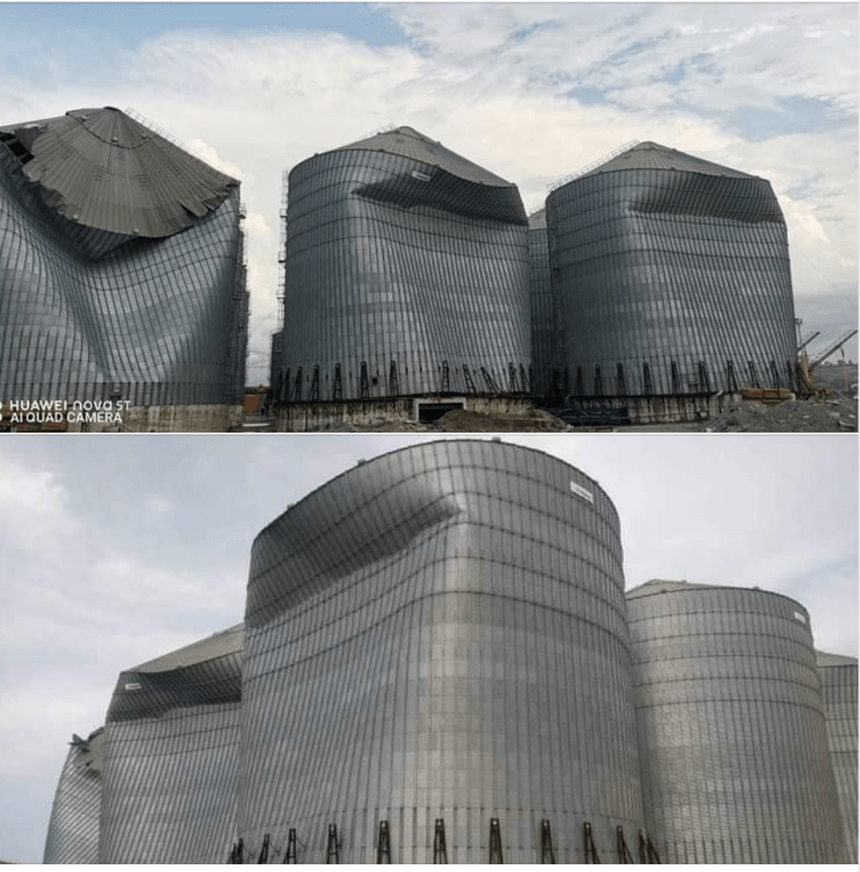

This happened a little over 4 years ago in Algeria. A coastal storm hit and the silo were evidently not suitably design for the wind pressures they experience. At this point they were brand new and some still under construction. Though that shouldn't have affected ulitmate strength the wind rings were installed and are visible.
