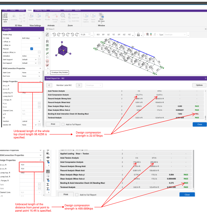

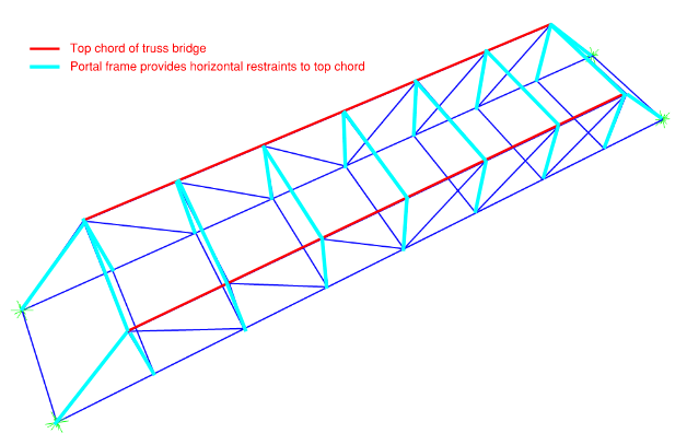

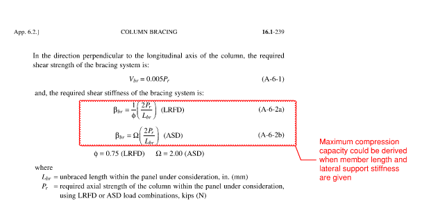

Top chord out-of-plane buckling could be the reason. vatical hanger and bottom chord do not provide enough lateral support stiffness to the top chord. What the unsupported length of the top chord is in you FEA simulation?
Here is a post on LinkedIn which may help understand why the collapse happens: Application of equations A-6-2a/A-6-2b of AISC360 in Pratt truss bridge design.

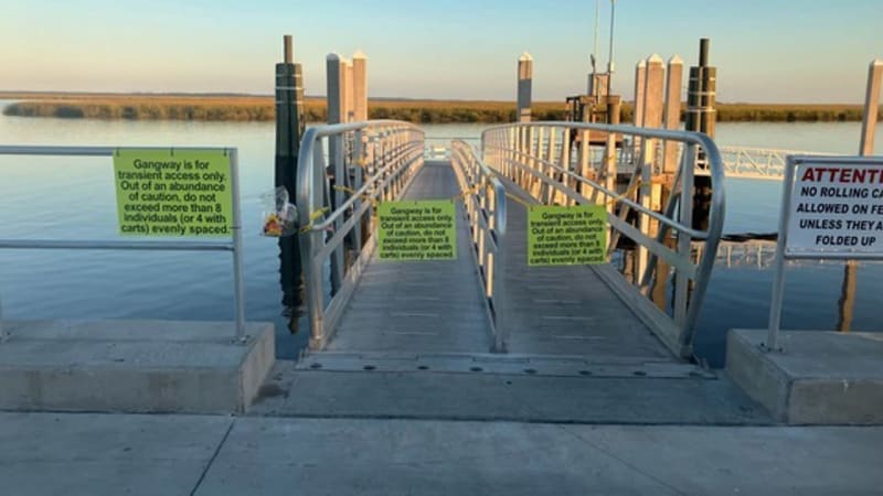

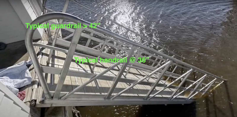

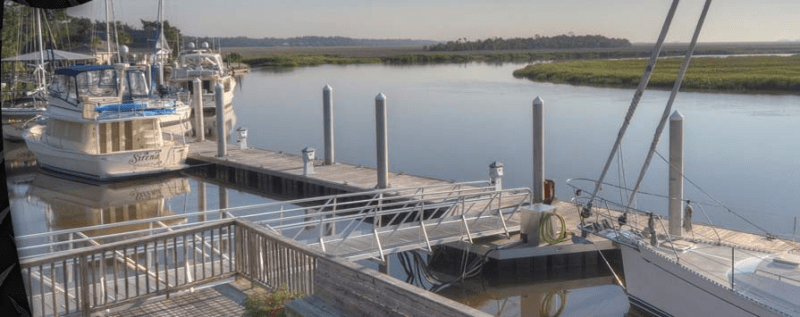

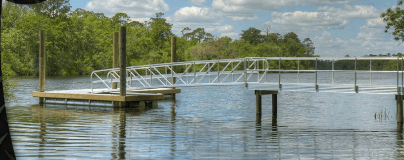

The two images below are lifted from Crescent Aluminum Docks and Gangways Web Site, where they advertise these images as examples of their residential grade gangways and commercial grade gangways.
First is the image Crescent advertises as an example of Commercial grade.
The Second is the image Crescent advertises as Residential grade.
Based solely on these two images, it appears that Georgia DNR installed a residential type gangway, and not a commercial version designed for public use and loads? Note Commercial Grade example adds lateral bracing to sides of U-shaped truss.
Third image below from Crescent's web site, says all designs "have been analyzed and stamped by licensed engineers and proven by years in the field".....
We have no idea what design load specification Georgia Docks procured this gangway under?
Point of post is the clear difference pictured between Comnercial Rated vs Residential Rated on Crescent's Web Site. What failed looks more like the residential example than the commercial example.
Oops409
The images you post are not the gangway that collapsed
LI,
Correct, as I stated in my post, the images were from Crescent's web site. I added more verbage to make it clear the images I posted are examples of residential vs commercial grade on Crescent's Web Site.
PS: human909's images posted above also were not of the collapsed gangway, rather were examples of better laterally restrained designs from Crescent's Facebook Page.

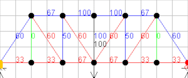

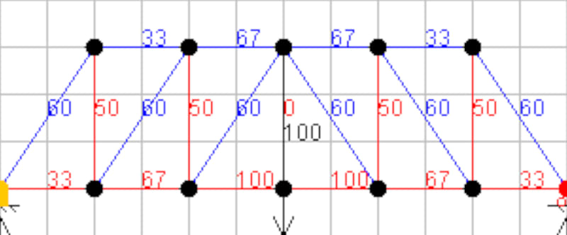

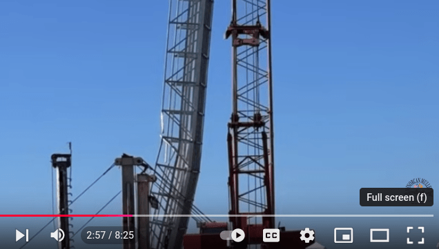

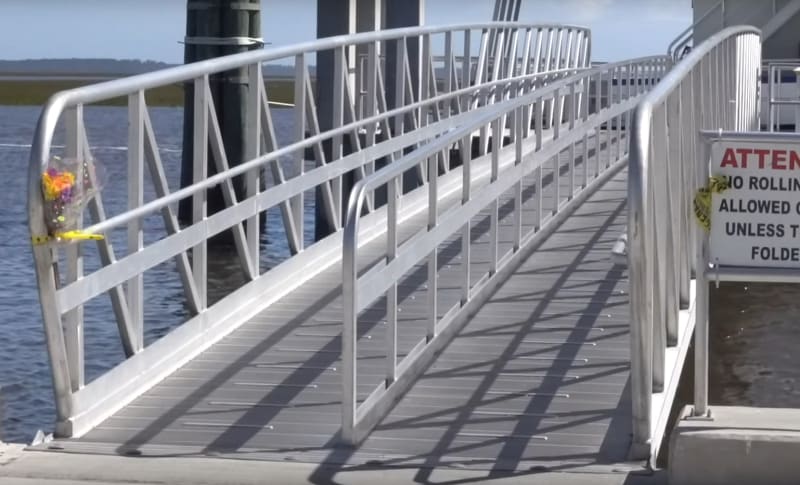

Sym P. le (Mechanical) 23 Oct 24 02:07 said:
Scaling off the 4" rub rail or 6" bottom chord, I get a height in the order of five feet.
By the same method, the truss section interval is 48".
From the Minorcan video, the mainland dock appears to be of the same vintage as the island dock, i.e. they were both renovated as part of the same project. A significant difference though is that the pony truss on the mainland side is a Pratt design whereas the failed structure was a Howe design. This distributes forces differently as portrayed in the following images (garrettsbridges.com). The Pratt design develops higher compressive loads in the top rail compared to the Howe design whereas the Howe design develops compressive loads in the slim diagonals. It's interesting that the Howe design is the one that failed, seemingly by buckling of the top rail. I wonder why the two different styles.
Edit: I see now that the Howe design develops higher tensile stress in the bottom chord, which brings weld failure back into play.
garrettsbridges.com/design/pratt-truss/
garrettsbridges.com/design/howe-truss/
Mainland ramp (Pratt design)

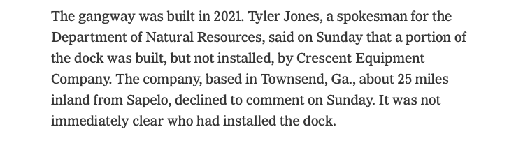

From news article here
gpb.org said:
A resident of Southeast Georgia's Sapelo Island in McIntosh County said that he warned the Georgia Department of Natural Resources last summer that the agency's ferry dock gangway on the island was in poor condition, months before it collapsed Saturday, killing seven people.
JR Grovner told GPB that he notified a DNR captain three or four months ago that he thought the aluminum gangway's structural integrity was compromised.
“I said, ‘This dock is going to collapse;’ I sure did,” Grovner said. “I was walking on it, and it was bouncing. So, I stood in the middle of it and bounced up and down for the captain. And he said, ‘Ah, it ain't going nowhere.’ Yeah. Look what happened.”
The DNR, which operates the dock and the two ferries serving Sapelo Island, declined to comment on Grovner's allegation, which he also aired Sunday at a news conference held by the agency about the fatal incident.
In an interview with GPB on Saturday night shortly after the gangway collapsed at approximately 4:30 p.m., Grovner said, “The captain told me tonight, right after it happened, he said, ‘JR, you told me.’ He said, ‘You were right. You said it.’"
Top chord out-of-plane stability is key for design this type of structure. Here is one example I prepared before. Different load capacities could be derived with different unsupported compression lengths (out-of-plane) specified in FEA.
The structure is not same, but design principle is. In this case, bottom chord and vertical hanger should provide lateral restraints to the top chord to prevent it losing out-of-plane stability.

I also read article that stated at least one of the gangways was installed by Georgia DNR, and not Crescent.
Can you source that article?
Given the fundamental design differences, that would make sense. The typical Crescent designs are Pratt trusses so it's quite likely the failed structure is the state provided gangway. All the more reason to have outside investigators.
I don't know if it's just me but listening to the original press conference, the media handlers were condescending to the questioners and trying to tone down the difficult political questions. Fortunately they largely failed and the audience had their say.
Thanks. It doesn't look like an installation problem but I'm still curious as to the procurement and design anomaly.
Symple, Great catch on Pratt vs Howe Truss, and that is very interesting variation in design from one local manufacture. Hard to understand why one is Howe and one is Pratt?

Could it be the fabrication shop mistakenly started welding diagonals in Howe configuration, even though the verticals were sized for compression and the diagonals sized for tension? I could see that this could have easily been done, and workers if they even realized that, may have thought, 'ah that won't matter' as you have same number of diagonals and uprights either way.......
This one key detail that Symple discovered, appears to be the manufacturing flaw. No way the skinny diagonals should be in compression with the bigger verticals in tension as they are in Howe Configuration.......
This would also explain why the gangway was so "bouncy" as pointed out by the frequent passenger to Captain.
Bouncy means faster fatigue of aluminum. 700 passengers that day, vs normal day of 100, so a lot more cycles that day.
So did everybody sign off on this reversal of the diagonals or was this detail even noticed by anybody till now???
Would like to see shop drawings and orientation of diagonals vs what we see as-built on failed truss vs not failed truss....
