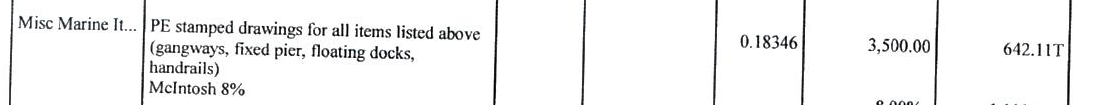

Crescent's Invoice shows an invoiced total amount of $642.11 charge for PE Stamped Drawings, for all the items on Sapelo Island Visitors Center Invoice. That amount is calculatd as .18436 of the $3500.00 Rate Amount.
How much is PE willing to do for $642.11? Doubtful PE did actual design. At best PE verified to his/her satisfaction that drawing met specifications and stamped and signed it?
If you look closely this is clearly just an up front payment of $15,000 / deposit and they've adjusted the percentages to arrive at that exact figure. It's just the first invoice and it is clear to me that the total amount allowed for PE stamping is $3,500
OK, I see it is partial billing, however $3500.00 stamp is for multiple items (gangways (plural), fixed pier, floating dock, handrails).
Very confusing invoice as it states in the terms field that amounts are due in 3 increments: 35% then 65% then full balance.
35% of $75,232.80 total for rate items including 8% tax comes to $26,331.48 and NOT the $15,000.00 amount invoiced.
Also mentions Plural Gangways but only invoicing for one on this invoice.

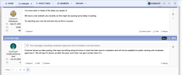

A banner shows up after posting, that says something along the lines of 'post has been sent to moderator and will not be available for public viewing until moderator approves it.' We will see if it shows up after this post, such that I can get a screen shot of it.
Edit: Image Below of message for this post, before edit.
Took 35 minutes to clear moderator on message #113, but now this message #114 went right away?
Two messages between 113 and 114 got deleted by moderator, but I have no idea why?

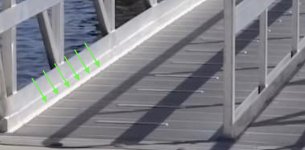

I highlight the weld on the side rail because it exhibits the same "smut" present on all of the tacks. As Crescent acknowledges, these side rail welds are more critical to the integrity of the structure. I question the quality of workmanship which allowed this contamination to persist.

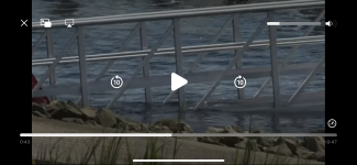

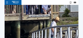

Another 80' install that collapsed two years ago in St. Mary's GA.
First Coast News - Details on what caused walkway on dock to collapse in St. Marys (Youtube.com)
This caused some consternation. The language is not quite as bad as the dismissive indifference that led to the billion dollar settlement at Champlain Towers.

From my earlier posted image of the Meridian gangway, I think I can see a series of tacks where the deck planks are attached to the side extrusion. That doesn't give me a warm fuzzy feeling at all given the poor quality of welding on the underside. I was thinking the center rail could add some strength to the structure but if the posts are merely welded to the deck planks, I'm not so sure.

St Mary's Hinge Failure
St Mary's gangway failure at gangway side of hinge. Hinge mount to dock looks ok. Hinge pin deformed equally at both ends with aluminum hinge loss of connection to gangway. Failure appears to be gangway failure rather than installation failure.
Edit: About 20 people on gangway at failure and about 3 year old gangway. We need to know manufactures design loading specification, and allowable deflection. Witnesses mention this gangway was noticeably flexable too. Fatigue failure from excessive deflection of material and welds due to not being designed for unrestricted loading control?
