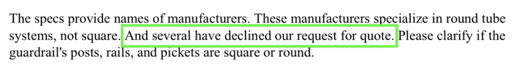

The bid documents indicate an 80 foot gangway to be installed but these are not fabrication drawings.

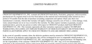

GA-DNR has not provided any documents in the Dropbox specifically regarding procurement of gangways. It is obvious they were not fabricated directly from the bid document. The RFI (above) seems to indicate, in the end, they were provided directly by GA-DNR. Nonetheless, here is Crescent's warranty, good for 36 months, complete with wiggle room.

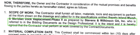

A few items pertaining to the involved parties. There is a contract with S&W ...

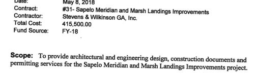

and also weighing in is GEORGIA FINANCIAL AND INVESTMENT COMMISSION PROCUREMENT DIVISION (see attached Addendum #5) ...
It seems this could be a source of confusion whether S&W is merely overseeing the provision of stock items. In circumstances such as this, surely someone is tasked with ensuring the product is suitable.

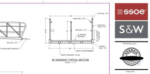

That cross section from S&W looks awfully similar to the standard crescent drawing below.
Deck

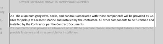

I read that section 2.8 to be free issue of the gangway built by Crescent.

The project was divided into three phases. The "section 2.8" (see attachment) pertains specifically to the "Meridian Dock Replacement". I haven't identified clear delineation of phases in terms of contracts. It's all rather vague. Note that SSOE acquired S&W along the way so early documents do not include them in the headers.
Edit: If I now understand the bid/award progression, this addendum pertains to the project as a whole and was issued leading up to bid close and subsequent award. The various phases were introduced post award as a means to execute the project. WRONG
