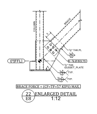

Slotted tube Connection_brace
Veer007
Sep 7, 2016
379
IN
Hey guys, i have a situation where my detailer slotted the tube column at base plate due to its larger brace force, however it seems to be wrong as far as i know, has anyone encounter a same situation?
Thanks in advance!!

Looking at the weld stress from the plate to the brace, the length of weld might be the critical element. Maybe the designer intends for there to be weld inside and out of the tube. It's only 5" deep, so 20" total length. If the tube is big enough, maybe they can reach inside. On the column, that's a lot of weld, even though it's just one-sided.

Now back to the connection at hand. human909 tried (4 Jan 15:19) to make the point above that out of plane eccentricity of the plates must be considered, and I agree with him that the 1/2" gussets are probably too thin.

Slotting in of itself is not a problem, in fact it is often a very good solution. The issue though whether the plate has the capacity to convey the forces in the bracing. The brace seems to be a 10" HSS. Unless it is over-designed or quite long then that would imply significant forces for the connection the handle. For connections like this I'm often doing 1"-1.25" plate to satisfy compression loads and eccentricities.
**I wish the world was this ideal. Sadly I see inadequate design more frequently than I would like. You can't join every battle particularly if you have not direct contractual relationship with the other parties and they have more letters after their signature... :-(
I agree with the points made by hokie66, human909, and JLNJ above about delegation and the relative thin gusset plate.
One other point - most gusset/brace connections tie into a column so as to fully integrate the column overall stiffness (think gussets aligned with WF webs or at least stiffened webs).
Here, we have a gusset extending through a wall, or rather a pair of walls, of a tube such that I can perceive a much higher tube wall flexibility compared with the base plate.
Perhaps so much that the majority of the brace force only flows though the base and essentially ignores the column as the walls of the tube deflect. That would be a big factor in how you check this connection.

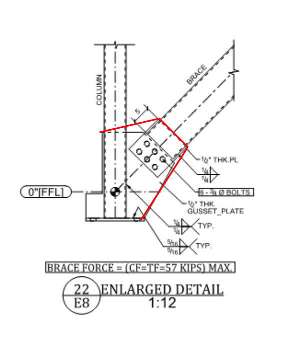

KootK - not sure why a pair of channels would make any difference to how the weld symbol is portrayed. The channels above the gusset would have to be welded together as well somehow.
The fillet weld symbol problem would still be a problem - and now you'd be welding, or trying to build, a fillet onto a curved flange tip on the inside as well.
JAE said:
...and now you'd be welding, or trying to build, a fillet onto a curved flange tip on the inside as well.
I was envisioning flanges out rather than flanges in with the difference being whether or not your weld symbol would be traversing a hollow or one solid plate element of a flanged part (channel). I was gunning for a salient example with the weld symbol business rather than trying to make a robust column.

With back-to-back channels, KootK, I think the original double weld symbol would be OK as you would be welding on opposite sides of a contact plane, similar to the detail you posted.

That suggests an attractive definition: other side = opposite side of the contiguous steel contact plane.
KootK - exactly.

Guys, i'm agreeing the weld symbol is wrong, will change as per your advise...
I'm the checker who works for a fabricator, my detailer team has a licensed engineer who is responsible for all connection but also need approval from an EOR.
Guys i too familiar with blue beam software, its really good...
Except the buckling stress of gusset, the connection is good as i think. This one make sense...Can i add a 1/2" stiffener to gusset to reduce its buckling, will this work?

Stiffeners can be used in lieu of using thicker plates.
Is adding gussets really cheaper than providing an appropriate thickness plate?
So you need 3/4" plate instead of 1/2" plate. Adding gussets adds pieces and welding. Seems foolish to me. But I don't do connection design.
I know field welding is often considered taboo, but since this is a brace connection I would imagine those bolts will be slip critical so you'll either need specialized fasteners or specialized testing already to verify installation AND surface prep requirements for the matting surfaces. If you weld it, you can just enlarge the gusset a little and run it into the slot. Add a hole for an erection bolt, and then field weld it. That reduces the number of pieces and eliminates your eccentricity in the gusset which could reduce the size further.
